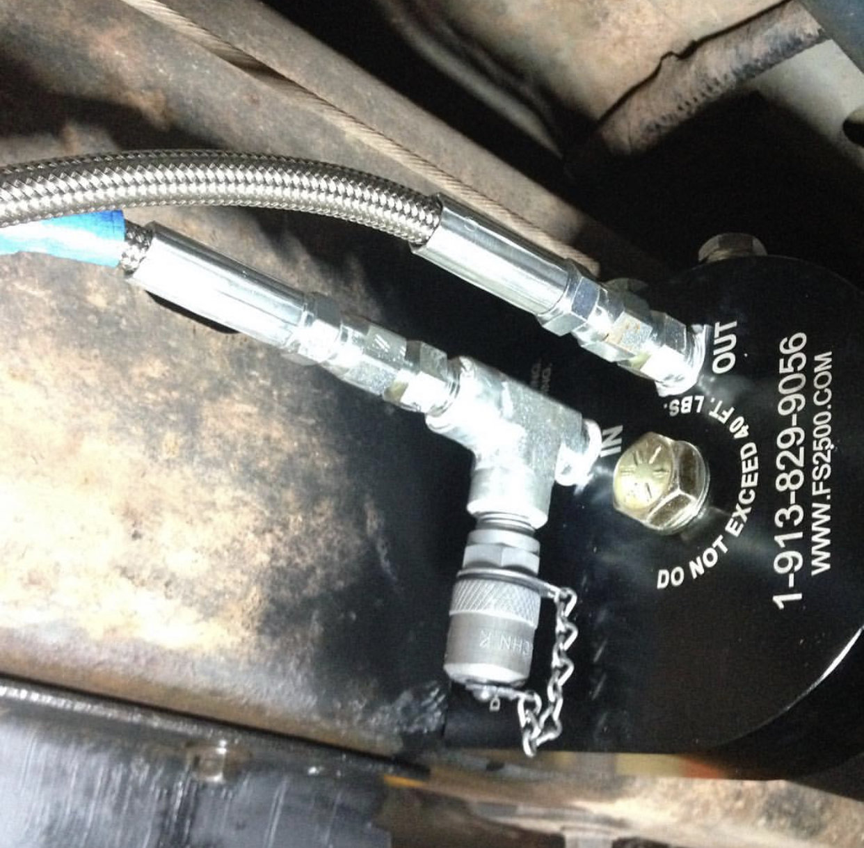

    The dipstick is your friend. Here is what I put on my 7.3 diesel, bad oil will shorten the life of the injectors so clean oil is even more important than on a gasser. At 17 quarts a change I figure I’ll be ahead of the game in about 1 year. Shell rotella T6 isn’t cheap. Take note of the sampling port at the inlet which allows for sampling while the oil is circulating.
