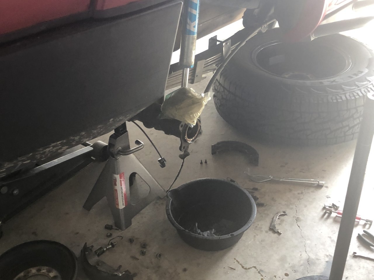

    Rear axle seal isn’t hard to replace, the drums are a major pain tho.

    I get that but doing it with a buddy and myself I was only out the seal and gear oil. Saving me bunches of money for beer.

    Won’t the oil soak the brake shoes and render that drum useless?

    Just the brake shoes the drum itself can be wiped clean.

    Yes and no.... metal is porous and can soak in the oil. You can usually get away with wiping it down then heating it up with a torch to burn off any oil that might be present in the metal.

    You can actually sometimes bring pads / shoes back to life by soaking them in some 91% rubbing alcohol, then take a torch to them as well. The alcohol will help pull the oil out of the very porous pad material as it burns off. But for the price that pads / shoes really arent just do it right, new pads.

    The shoes and drums are already soaked. Soaking them more is not going to change the outcome.
    The rear wheel bearings need to be changed. The gear oil has washed the grease out of the bearings and they will fail soon if not replaced.

    Why does everyone always whine about the rear drums, if you just maintain your rear brakes by cleaning and adjusting on a regular basis they come right off.

    I thought the rear wheel bearings were already bathed in gear oil as is? (its not like we have a semi / full floater rear)

    Nope. The rear bearings sit on the outside of the axle seal.
