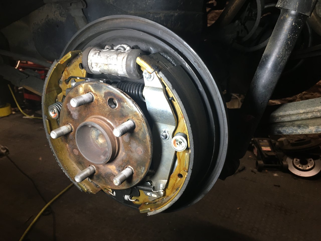

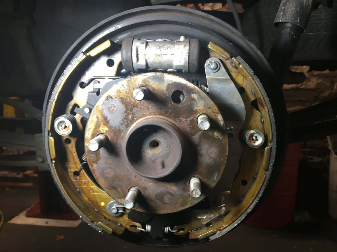

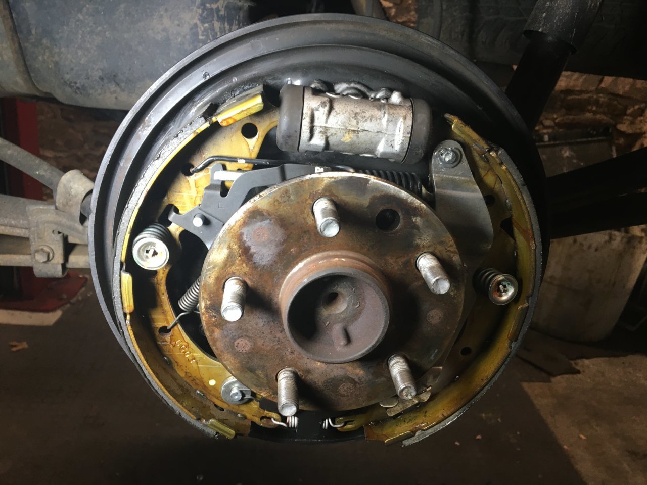

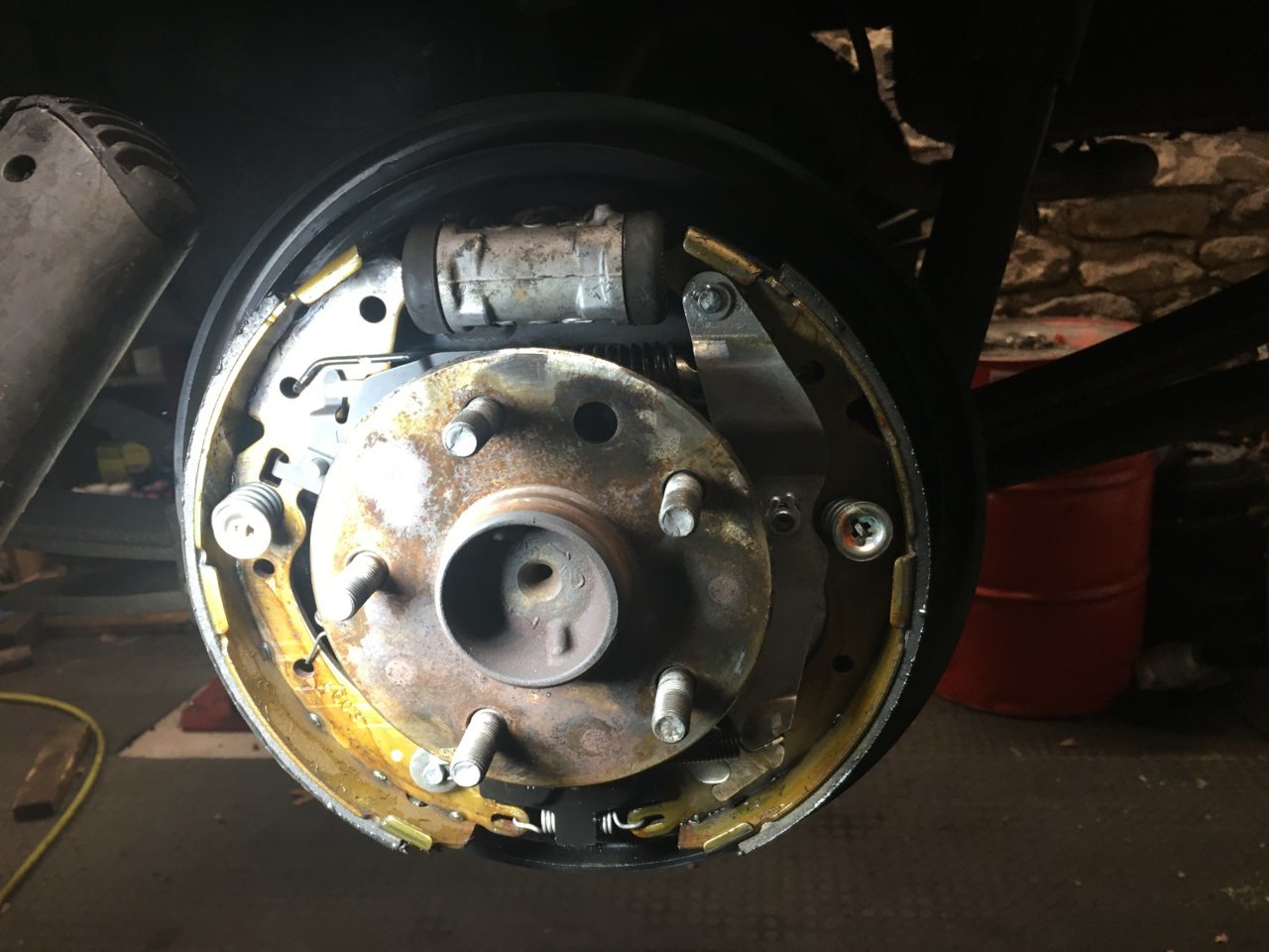

    Left rear brake is all greased up again...
    5E38F227-3D86-4229-B52D-6F2E854463BF.jpg 369FC05E-79DB-4185-9BF5-FC8C962E2B8F.jpg 3A13365B-2A16-43D6-8EBE-A286A3DF592F.jpg E76DDAFD-21D3-4832-945C-C9F8ED46B612.jpg

    I don’t think it failed as much someone installed it incorrectly. Last time I bring it to the dealer...

    They probably pressed the collar on too far.

    Your retainer clip is missing off the shoe hold down spring.

    So, it was 100% the dealer’s fault and they’re owning it!
    The wheel bearing was “notched”. The tech who worked on my truck did not bother to tell his service manager, which is why I never knew about this. He decided to just make it work. I should have been given option of replacing the bearing or staying with the “notched” bearing. The service manager apparently read the tech the riot act over this. I get a new wheel bearing 100% for free (don’t even pay for labor)!
    I am 99% sure the reason the axle seal failed in the first place is because this bearing was notched and not due to old age or high mileage, which is why the brand new one failed almost immediately!

    7,489
    Related? Like, shoes were tight and he cranked on the bolts till it destroyed the shoe hold down, instead of backing off the shoe adjustment?

    Photo was taken after that was removed... :)
