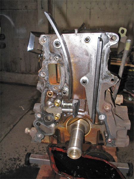

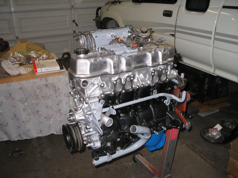

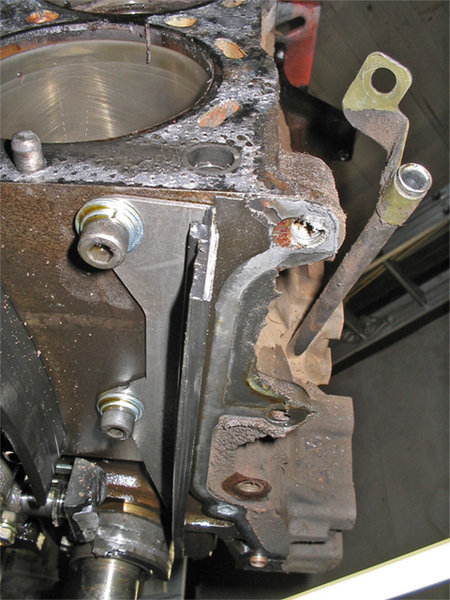

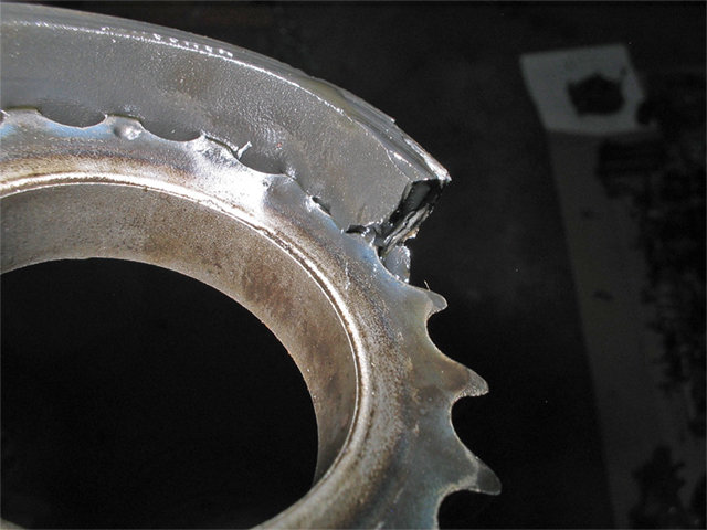

    You could call me pretty much a non-fan of aftermarket metal backed guides.
    The set I used in my 22R-E went about 60K before breaking and ruining my engine. But it did result in me building this beauty.
