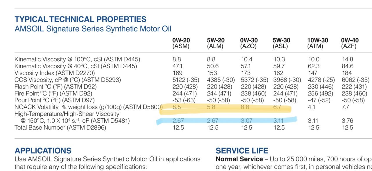

    So like @12TRDTacoma mentioned, you could try using 5w-30. This is not going to hurt your engine at all, and likely the only reason Toyota recommends the 0w is for fuel economy. Now the difference could be .0001 mpg which you obviously would not notice, but when you sell as many vehicles as toyota it adds up.
    I am going to upload a picture from amsoil which is comparing their oil. Same type of oil, just in different weights so you can see an apples to apples comparison.
    highlighted in yellow is how much oil evaporates under heat. While amsoil has very low losses as it is, you can see the 0w-20 lost 1.5 grams more than the 5w-30 oil did. Interestingly the 5w-20 oil has the least amount of loss compared to 5w-30 and 0w-20.
    Also below highlighted in blue is how much force to shear. The higher number the more protected your metal on metal parts will be. The 5w-30 beats the 0w-20 and 5w-20.
    Combine this info with the fact Toyota used to spec 5w-30 for the same engine in earlier year trucks, you will not hurt your engine at all by switching grades. If anything you will be helping it last longer.
