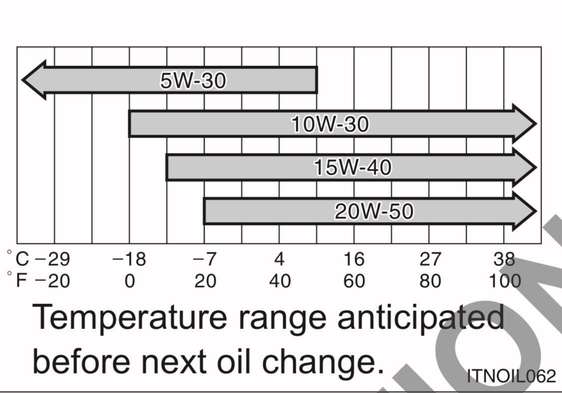

    So if I use 5W-30 the worst that could happen is worse gas mileage than what I’m getting now?

    The 5w-30 will have better protection in your motor. You won’t notice a reduction in fuel economy. When I had my 4banger taco I switched to 5w-30 from 0w-20 and it made no noticeable difference in mpg.

    Yes on the stick shift. And I willing to bet my life savings you couldn't measure the difference in you MPG.
    Now stop being paranoid and over thinking this. And tell your mechanic he needs to spend some time on Bobistheoilguy site and learn a thing or 2.

    I am going to throw this chart out there for reference. This chart is for the 1GR-FE and the 2TR-FE motor in your tacoma. This is from a Toyota Hilux which is not sold in the US. This is from a 2014 model year hilux. 0CCA178F-B170-4016-A2F8-C6EFF7D6FA8B.jpg
    Take this info for what you will, but if the temperatures are right you could technically run a 20w-50 oil in your 2tr with no issue.
    You can continue to use 0w-20 also. You may as well use it since you have it. But with this chart I posted and also the one I posted earlier in this thread there is no doubt thicker oils will protect your motor better than thinner oils. I’m not saying go buy 20w-50 and only run that, but you can with out a doubt run a 5w-30 with no fear of hurting your engine. You will actually be helping it last longer.

    I think I'll run through my current supply of 0W-20 and revisit this then...
    I have to admit that I was very skeptical before, but with this chart and what Bill told me I am feeling a lot more confident!
