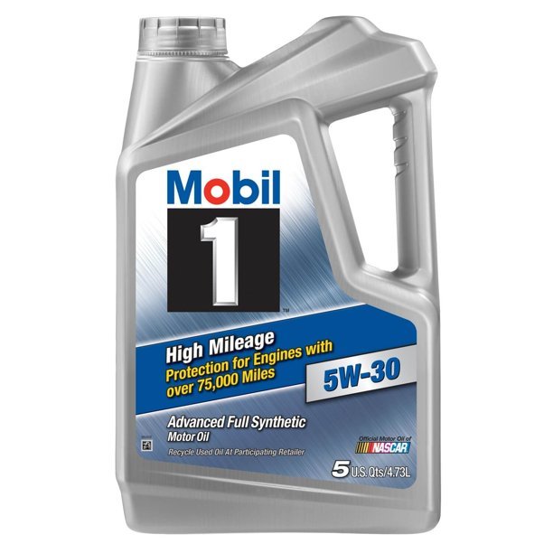

    I wouldn't hesitate, even for 1 second, to run Mobile1 5w-30 High Mileage synthetic. In fact, if it was mine.....I would've have been running it for some time now.

    Do yourself a favor and switch to 5-30 and cut down on the oil change intervals to a max of 5000 miles. Your engine will thank you.
