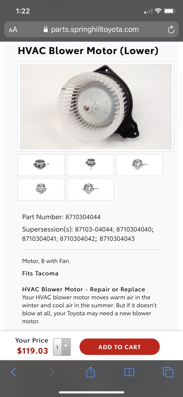

  20. Jun 18, 2020 at 11:27 AM
    Bootselectric
    Bootselectric Well-Known Member
    Mar 16, 2016
    #181453
    407
    Stirling
    2004 PreRunner (RIP) 2013 TRD Sport (DCSB-BRM)
    Not sure if this will help you but the price of dealership parts varies from one to another. Check out
    https://parts.toyota.com/
    MSRP $164
    Type in part number, MSRP price listed then a string of dealerships selling for substantially less.
    Spring Hill sale price is $119
