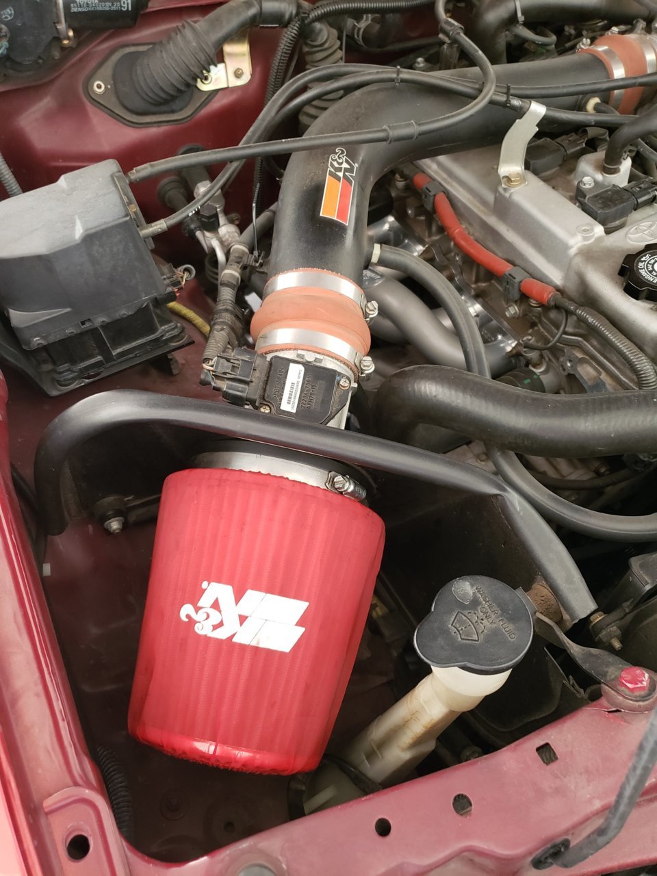

    Yup, I just get fram, Amazon cheapo or purolator paper filters and replace them evrey oil change and check them after each wheeling trip and change as needed. 200k+ and zero MAF issues.

    Nothing wrong with K&N filters , it's all about how you oil the filter . The first mistake people do is over oil them by saturating the filter element until it's dripping in oil . You don't need to soak the filter , just lightly fog it is all you need
    Next is properly letting it air dry for at least 24 hrs before installing . Another trick I've learned over the years is having (2) filters one cleaned ready to use and one installed on your vehicle . This way you don't have downtime
    Yet another trick I've learned is using their Filter sock over the filter . This increases the filtering allowing cleaner air into your motor
    Oh and I've been using K&N Filters for over 40 years !!!!

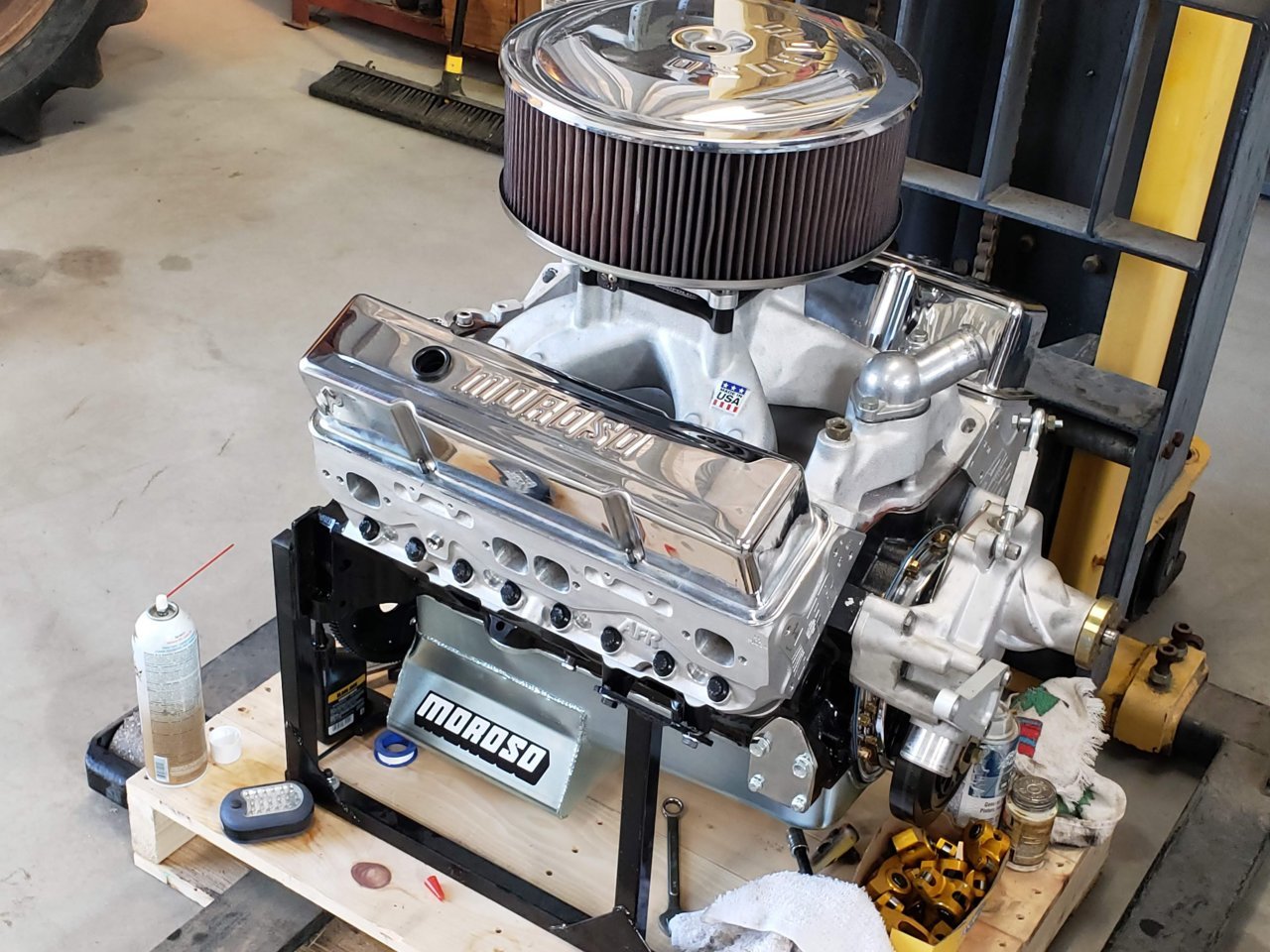

    I even trust using a K&N filter on my new $17k race motor and I live in the Desert with sand particles constantly floating in the air from the gusty Desert winds
