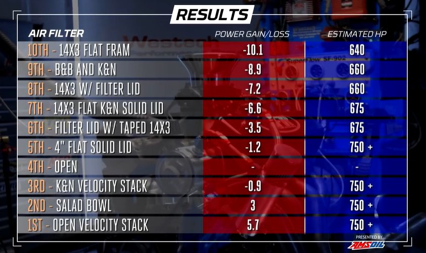

    I just did, and it did nothing of the sort.
    The conclusion they reached was that it was more about the air filter housing design on that particular engine than the filter media itself. That's why the "best" in that test was a velocity stack with no filter whatsoever on top. That's not unexpected given that it's a carb'd setup. They proved that even further when they took the 14x3 K&N round filter used in the 7th place spot and just taped off the outer ring, forcing the air to only come in through the top. That netted a 3.1 HP gain, no other changes (same filter media and housing design).
    The closest thing to an actual apples to apples comparison when it comes to the filter media was with the 10th spot Fram 14x3 round paper filter vs. the 7th place spot, which appeared to be the same design, but with the K&N filter instead of paper. That netted a 3.5 HP gain. On a 750 HP engine. That's nothing.
    Not to mention no talk of long term reliability, other than "don't run an open stack unless you want to change your oil a lot" - this was simply a "what didn't choke this engine combo" on a nearly 500 cubic inch V-8.
