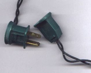

    For those, get this guy. It has rescued 4 out of every 5 of my burned strings:
    For the electric tape comment, I meant you need to protect the plugs where one string connects to another or your extension cord.
    Those have been problematic for me if they got a little wet in the past. Before I started wrapping those I have had to throw away countless strings after I started noticing burn marks whenever a little rainwater/dirt got between the prongs.

    We had those for the sets at the bar where I used to work; Where can I buy them?

    Most hardware stores should have them, as well as wal-mart and Amazon. They usually cost ~ $20-25.
