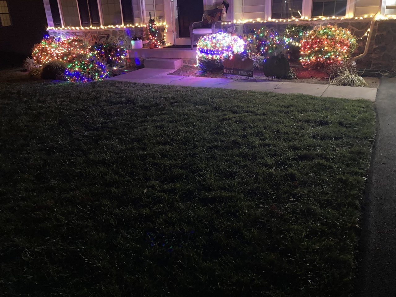

    The treadmill was not in use when it happened last night; My dad thinks that rainwater got in somewhere...

    You can't get a quality house (or at least one with an adequate electrical system) for less than a million bucks anymore, and even then they're still pretty shitty!

    Better picture...

    Water might be the issue, but you stated they are LED lights, and most modern Christmas lights are wired in parallel, so when one goes out, it doesnt effect the rest of the string. The string will also have a fuse at the end if they are outdoor lights, and that will pop before the breaker.

    Seal off the tops and sides of all exterior outlets.

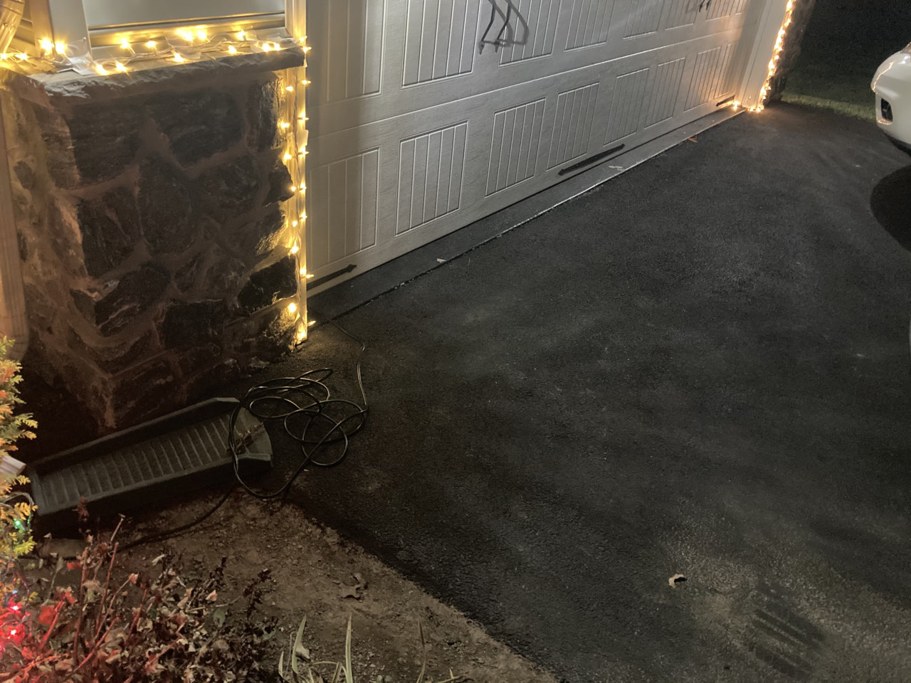

    And then this part is not visible in the first two pictures (One more strand on far side of garage door)...

    Do you have anything in garage? We rented a house the outside outlets and garage outlets were on same circuit

    Ok. A potential solution for this mess.
    Agree. Put the treadmill on its own circuit. You need to understand which outlet is on which circuit. Just changing outlets may not be changing circuits.
    Run a single 12 AWG extension cord to a power strip (like used for computers). The power strip should have its own fuse. Plug all your Christmas lights into the power strip. Now, place the power strip into a weather protected container. The container can be anything. Plastic coffee can with lid, old ice chest. Drill a couple holes in the bottom to pass the cords. Close the container, set it in a high ground position and position it so water can drain off and not into the container.
    Any light strings connected together should have their connection in a weather protection container.
    Good luck.

    Yes, and garage is on the GFCI circuit as well, but everything is ultimately run off the outlet at the front door...

    I have two outdoor power strips (really more like "power towers") that most of the lights are plugged into; Will get a picture of these when I get home from work...

    The reason for the pictures would be to see if these are proper "power strips"...
