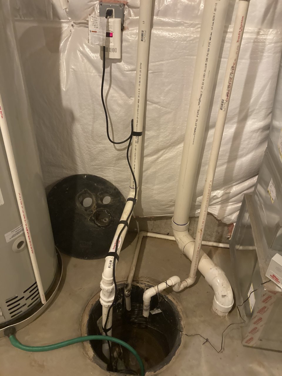

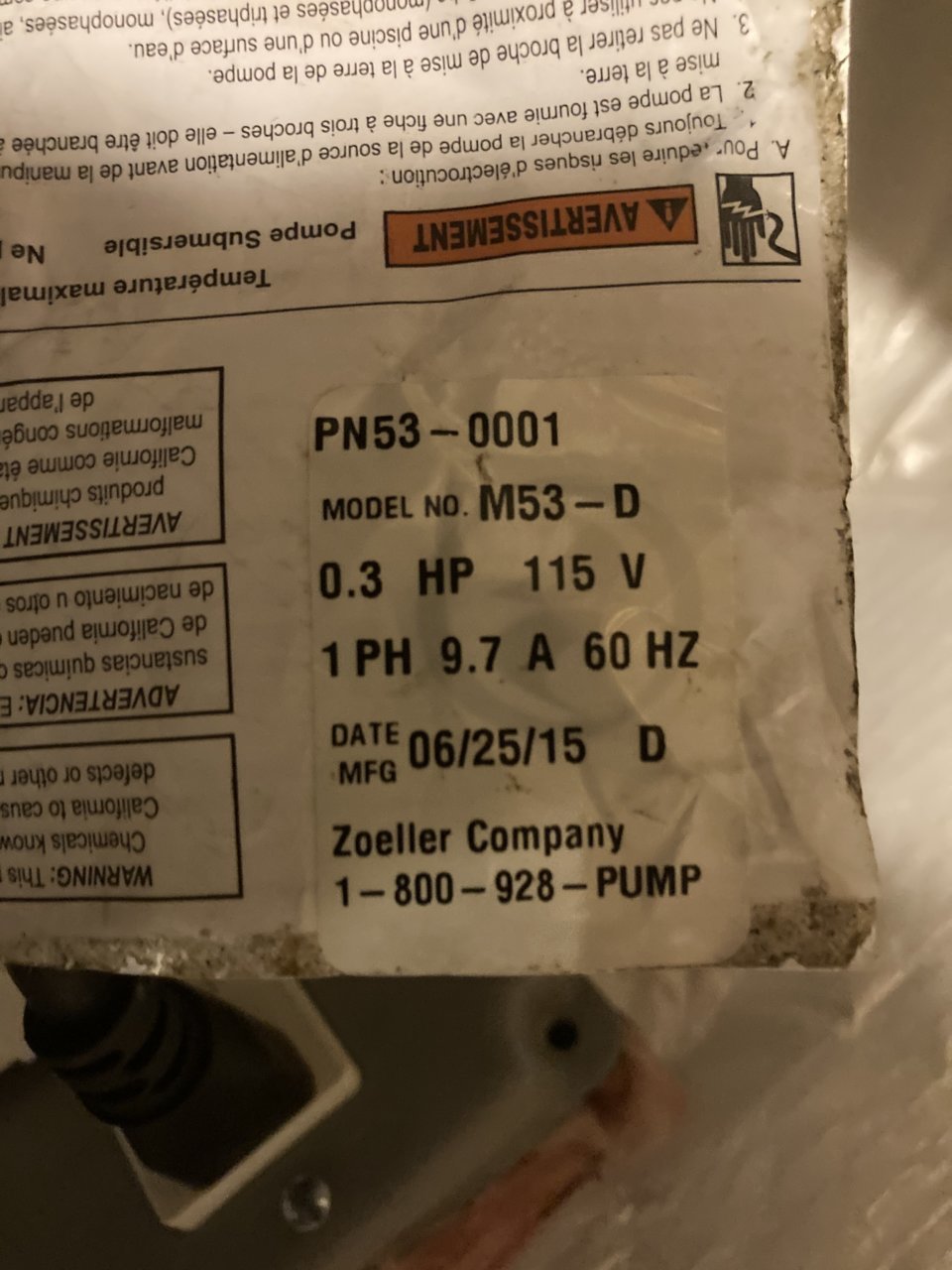

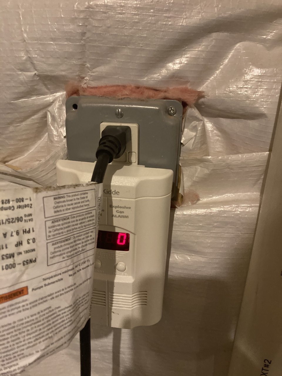

    I might be reading the sump pump tag wrong, but it appears to say 9.7 amps...?!?! :eek:o_O

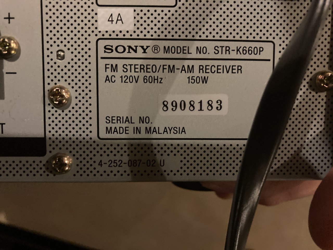

    Had a bit of trouble deciphering the stereo receiver that powers the surround sound...

    Sump pump tag that I may or may not have read correctly...

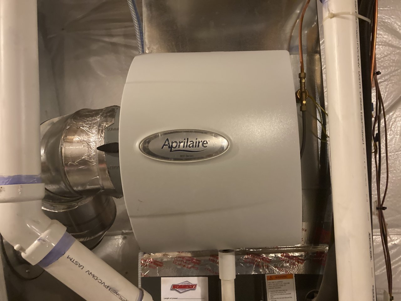

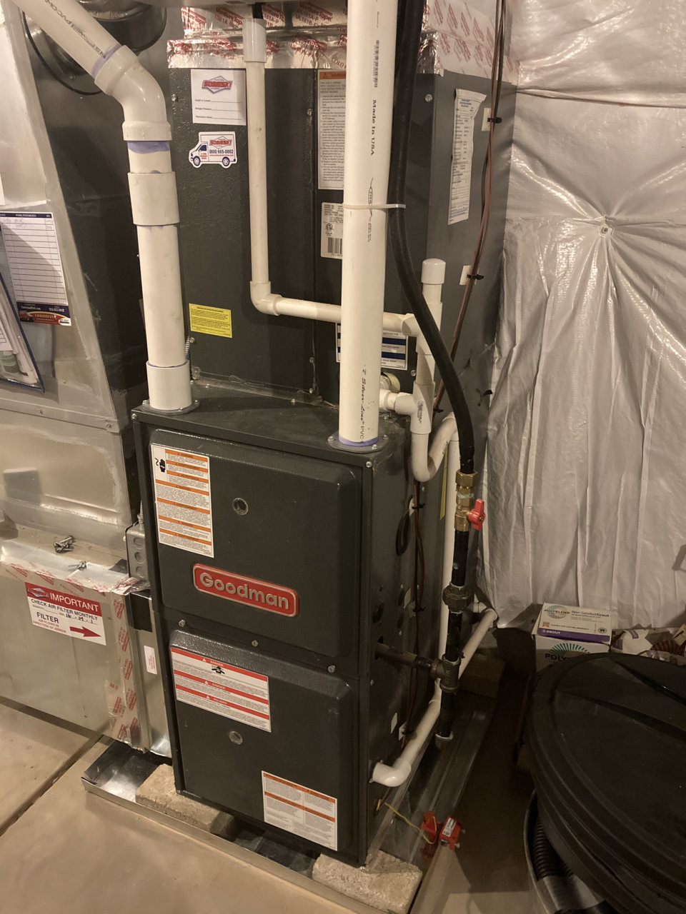

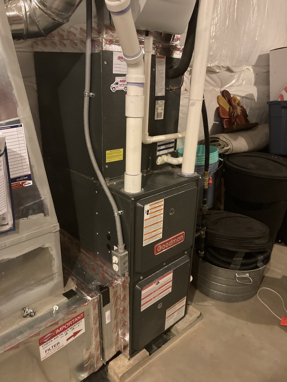

    Downstairs furnace/indoor coil (upstairs furnace is located in attic); Furnace definitely has it’s own switch, but the Aprilaire humidifier may be on the basement circuit...

    The list of items on the circuit in question keeps changing. Might be best to hire an electrician.

    On another note, it’s common knowledge among HVAC nuts like myself that a single central A/C unit requires two switches; The 25 amp switches are for the main floor unit, which is a 2.5-ton, and the 15 amp switches are for the 2-ton 2nd floor unit...
    But for some reason I thought the gas furnaces required two switches as well...?

    Not really; Dehumidifier has not been used for months; Only real addition is sump pump but that rarely turns on...
    99% sure Aprilaire is hardwired directly into furnace, which I know for a fact as it’s own circuit.
