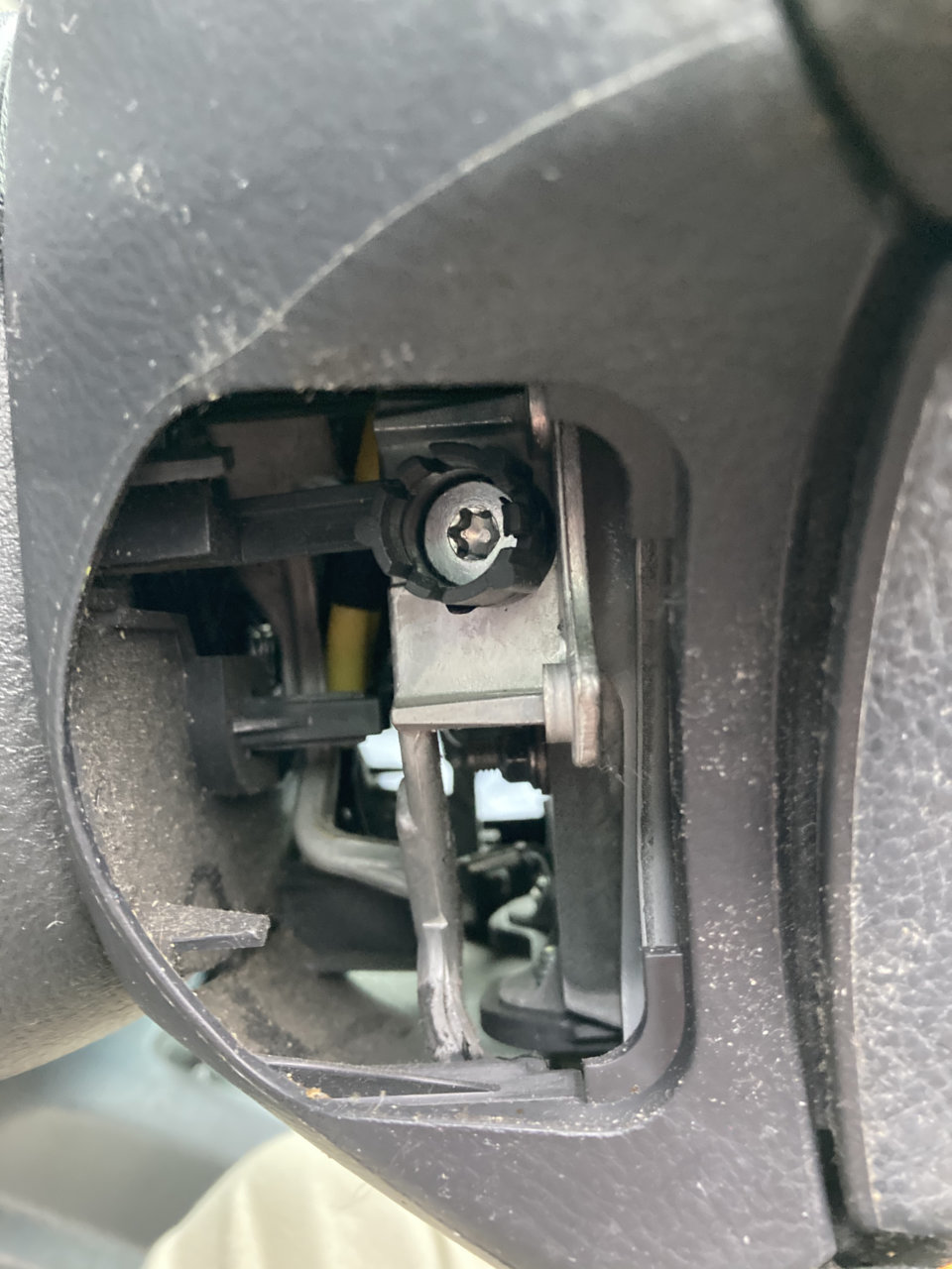

    I believe mine just needs the stalk (which I bought last night) and the wire; Does anything need to be done under the hood that you're aware of?

  16. Dec 4, 2020 at 7:41 PM
    TnShooter
    TnShooter The TacomaWorld Stray
    Sep 2, 2010
    #42625
    21,579
    Deogee
    07' TRD Off-Road, Auto
    STOCK
    I did my best to look for info on this.
    The only thing I can say is, I don’t see any exception for different mode trucks on the SRS diagrams.
    It looks like the drivers AB connector is the same for all trucks?
    Don’t take my word for it though.
    That is just all I could find on it?
    PennSilverTaco[OP] likes this.

    I'm talking about the circular bumper plugs; I've got an aftermarket Class II hitch, remember?

    https://www.toyotanation.com/threads/diy-oem-cruise-control.171992/
    Everything you need to know is on that first page. If you've got an auto and are prewired, it's as simple as replacing the wire with the new one, and bolting in the stalk.
    If you're not prewired it'll take a little bit of wiring, but it's still doable
