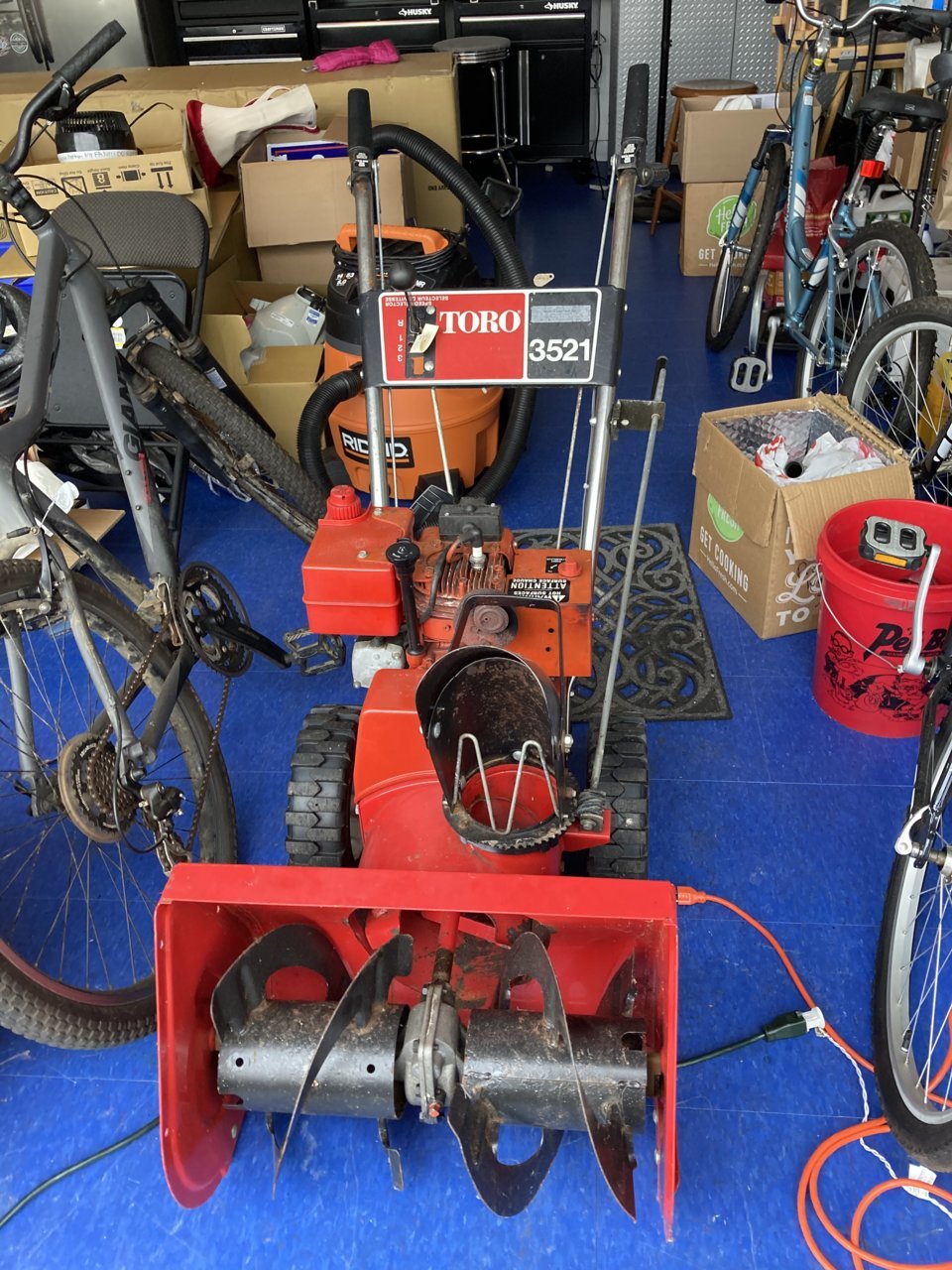

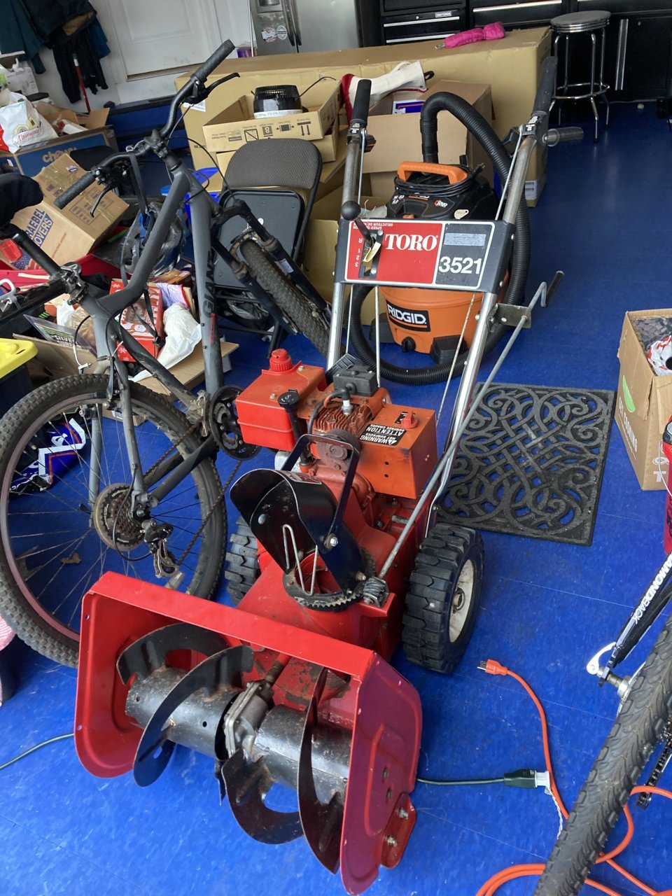

    The saga of the snowblower is finally over! Got the Toro back and running good; However, the gear drive for the auger could possibly be on its way out...
    2C643945-FF67-4575-B137-D42D4F0D1C66.jpg 7F24742A-61AD-4DF1-B448-B1861CD6046C.jpg

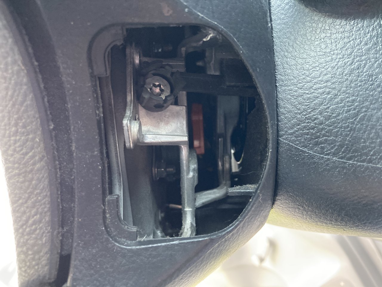

    I have a brand new OEM cruise control stalk, and I have the other parts I need on order at the dealer; I was just wondering if I needed a specific type of bolt or screw to secure the cruise control stalk to the clockspring, or if I could just bolts from Home Depot or something...?

    Technical answer: Yes, you need 2x 90080-15079 screws.
    Realistic answer, no you'll be just fine with home depot screws just make sure you get ones that aren't too long wide or coarse etc.

    If not (I kind of doubt they're a stock item) the appear to be m4 x 10mm 1.0 JIS head machine screws but that's judging by one grainy picture I saw.
    And yes taillight and radio bolts are all m6 bolts, there's a lot of "reusable" bolts on Toyota's, Toyota likes to keep things simple.
    The trouble comes in when you don't have the right GRADE of bolt. There's some m12 bolts on the Tacoma for example that are the same pitch and length but one might be a 5.8, where another could be a 10.9, if you used a grade 5.8 in place of a 10.9 you would have a very bad day when it broke, and it will.
    But anything m6 and below is usually too small to really matter, they don't see load like a m14 transmission bolt would.
