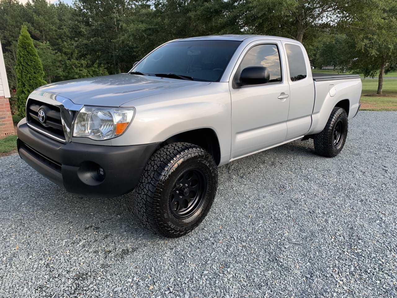

    1.5” spacer gives you 3” of lift by the way.

    You can’t go any higher than 1.5” spacers which gives you roughly 3” Of actual lift. If you go any bigger the upper control arm will contact the coil spring, and put the ball joint at an extreme angle.

    I’m running just a cheap ass like 60$ set of add a leafs from fat bobs. 31x10.50-16 tires.
