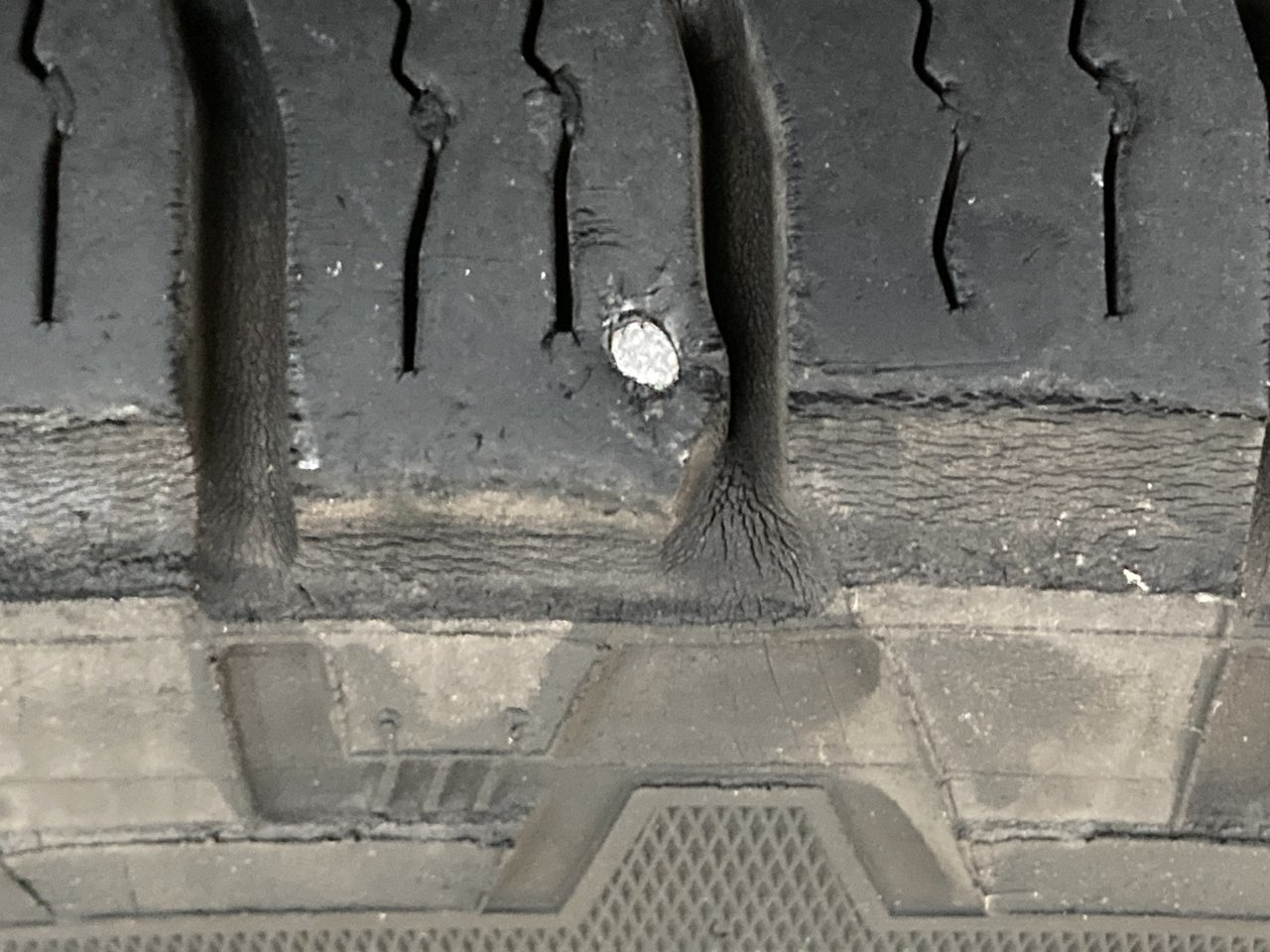

    Oh, yeah. I would consider that a repairable hole. A patch from the inside-out is always best, but you could do that yourself with a plug.
    If you go the DIY route, make sure you do it right- hole reamed out, rubber cement on plug, cure overnight with heat.

    Looks like it should be far enough away from the sidewall to plug, but they may want to pop it off the rim to say for sure.

    Thats pretty close to the sidewall. If it isnt leaking rock it lol.

    I got a flat a year ago, all my tires were 4/32" or lower, and 5 years old. I did replace all 4. Should you? probably not, I'd patch it.

    I know a few DT shops that would give you grief over that one. Its fixable with the caveat that it didnt angle into the sidewall once it went in, it just might take some arguing to get it done.

    you can safely plug that Charlie
    however until you pull it out you wont know how far deep in actually, penetrated...
    honestly it might have been that it only made it the depth of the knobby and not actually through the metal plies behind the rubber

    Hmmmm.......close to the tire shoulder. Depends on depth and angle of entry, if it went into the sidewall, then no fix.
    Another note. There are beginning signs of rubber failure, cracking between the lugs. What is the date code on the tires?
    The wear bars are close to being exposed.......
    Considering these borderline situations, it may be time for a new set of shoes for the ride.

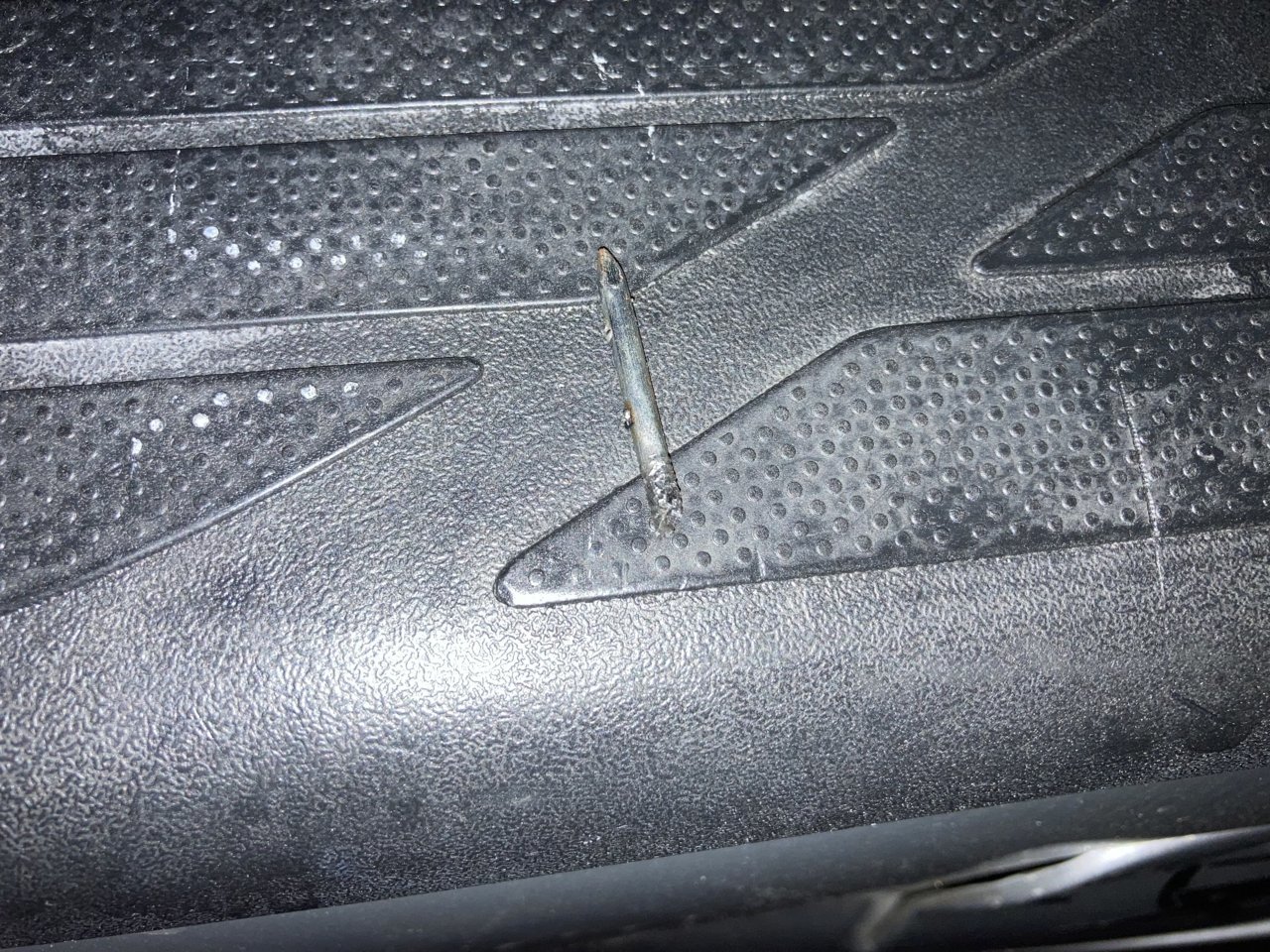

    I dodged a bullet! Took it to Mavis, where they immediately said it couldn’t be patched; My mechanic is a good friend of mine, so I took it to his house and did a leak test. He then pull the nail, and it still wasn’t leaking! The nail went in sideways!
  10. Jan 27, 2021 at 3:15 PM
    PennSilverTaco
    PennSilverTaco [OP] Encyclopedia of useless information...
    Jul 15, 2014
    #134007
    72,820
    Charlie
    Central Bucks, Pennsylvania
    2010 Zombie Truck 2002 PT Cruiser
    The culprit...

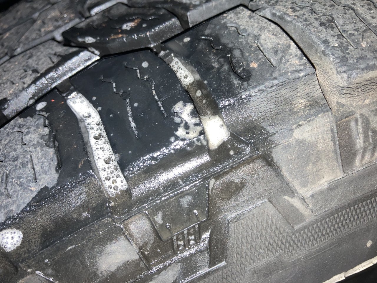

    The damage to the tire; All superficial...

    You got lucky with the nail.
    There is the start of cracking and the wear indicators.................
