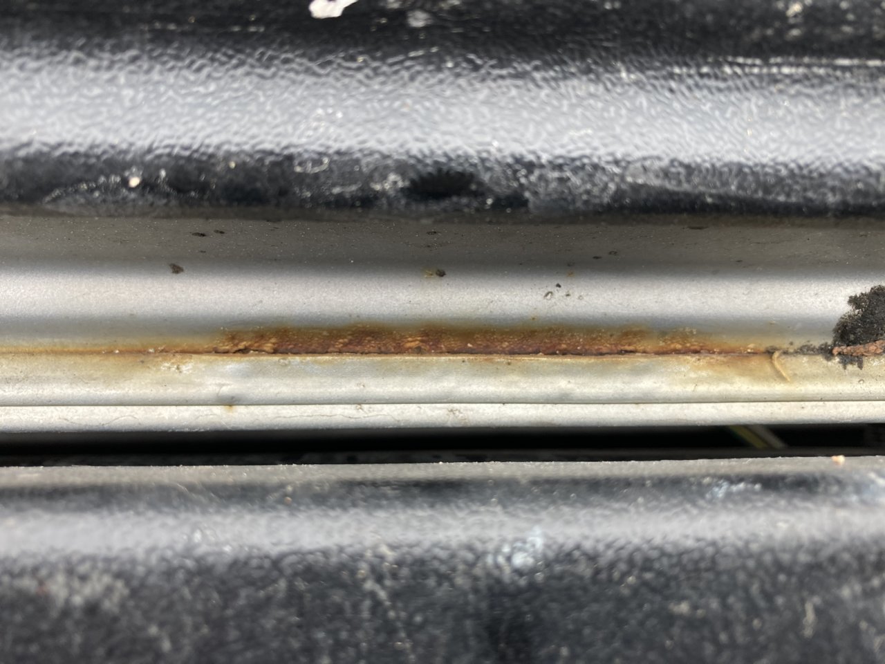

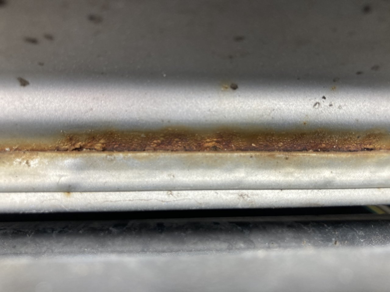

    Every other part of my truck is fine (including the ORIGINAL frame), but I just discovered this rust today when I opened the tailgate; It seems to have appeared rather quickly...

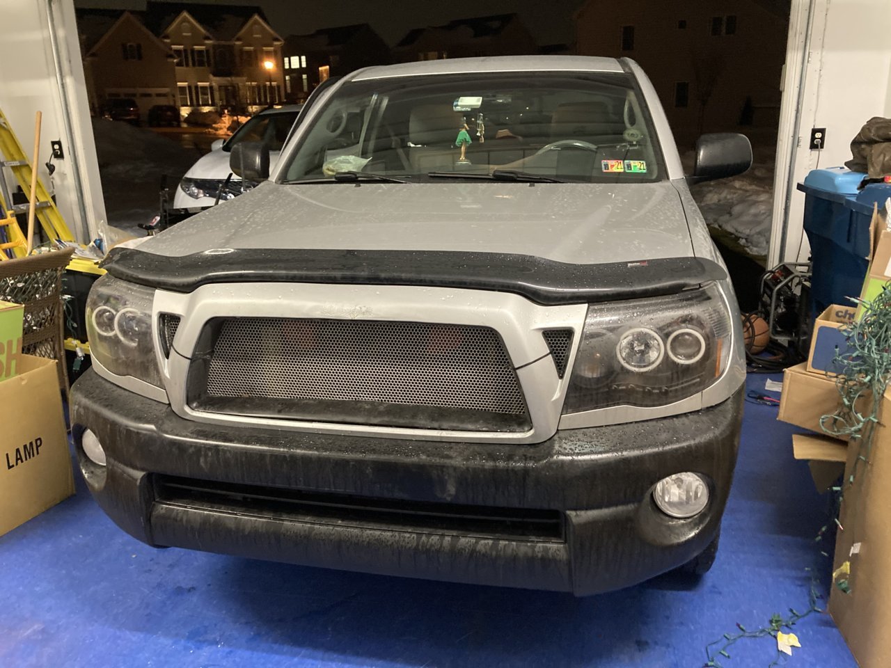

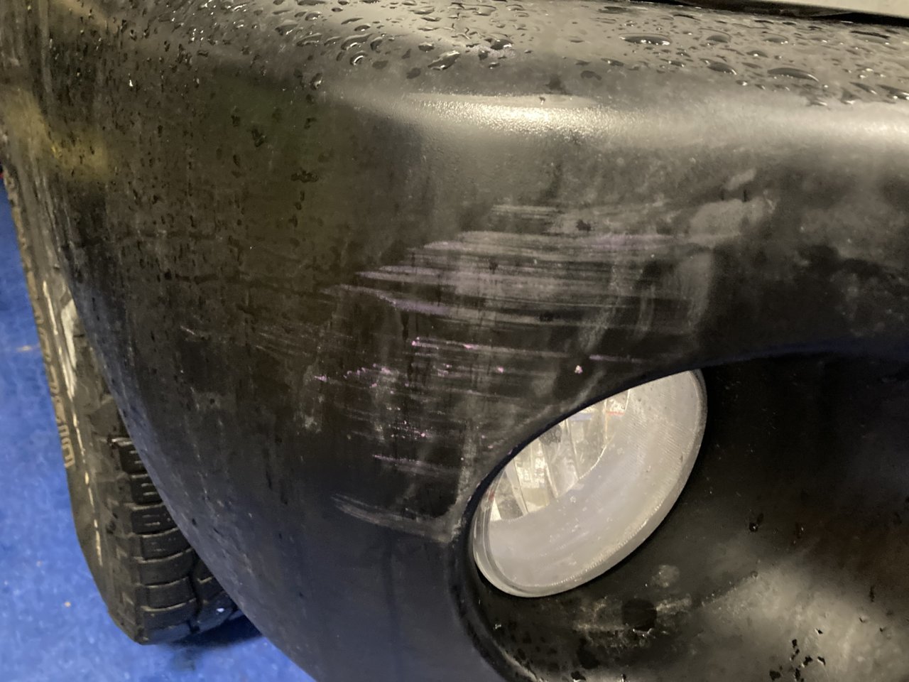

    I also forgot to mention that someone hit me AGAIN; This time I didn’t see it and likely didn’t notice it until quite a while after it happened...

    A couple of years ago, I removed the inner tailgate panel and hosed it out with Fluid Film. I still get some 'ooze' out of it but I just wipe it off and smile thinking it won't likely rust.
    I spray up into the weep holes in my doors, rockers and cab corners. BUT, I do it in the Summer when it's nice and hot so it will creep and not plug up the holes for water drainage.

    Well that sucks, how bad is the damage, more than skin deep?
  20. Feb 15, 2021 at 5:06 PM
    PennSilverTaco
    PennSilverTaco [OP] Encyclopedia of useless information...
    Jul 15, 2014
    #134007
    72,797
    Charlie
    Central Bucks, Pennsylvania
    2010 Zombie Truck 2002 PT Cruiser
    It’s a composite bumper, it’s always more than skin deep; Gonna buy a metal bumper at some point in the future...
