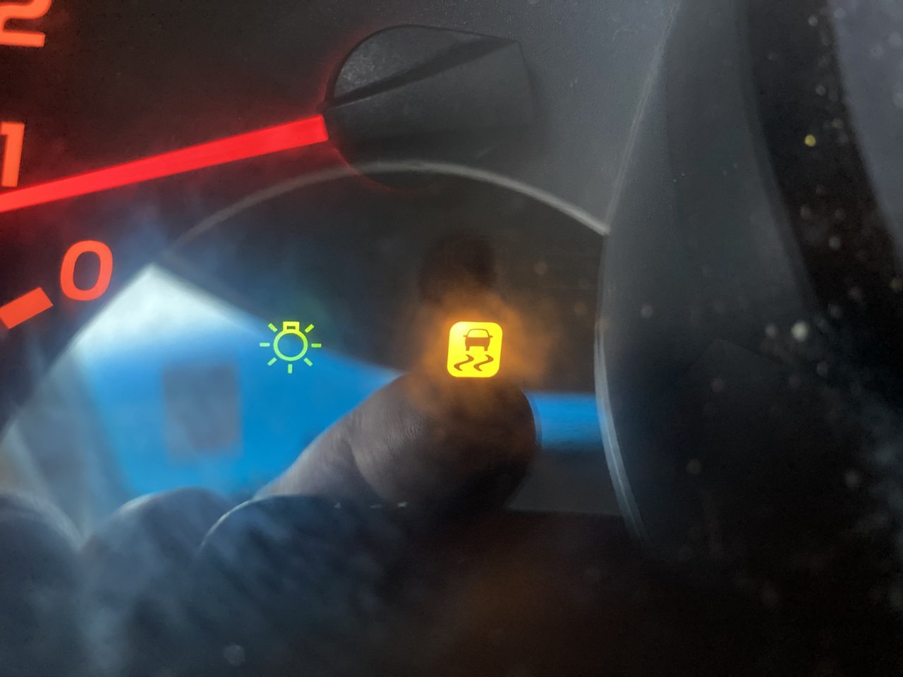

    Light was on when I picked up the truck; The guy who said the install thought it had something to do with the computer being disconnected for over two hours, and believed the light would go out if the truck was driven a couple miles...

    I’m trying to get the cruise control to work; I tagged you in that other post...
    Cruise control won’t activate and traction control light is on.

    The motherfucking place that installed the cruise control broke the clock spring and some sort of wheel position sensor, which the dealer quoted as costing $981; This could turn into a lawsuit.

    The clockspring and some sort of wheel sensor are broken. They were most certainly not broken when the truck went in; This could quite possible turn into a lawsuit.

    Interesting, if that's indeed the case sounds like someone turned the clockspring with the steering wheel removed that's a big no no, any competent mechanic should know not to do that most of them have warnings all over them not to. The steering angle sensor is attached to the clock spring so that would make sense if it's broken too.
