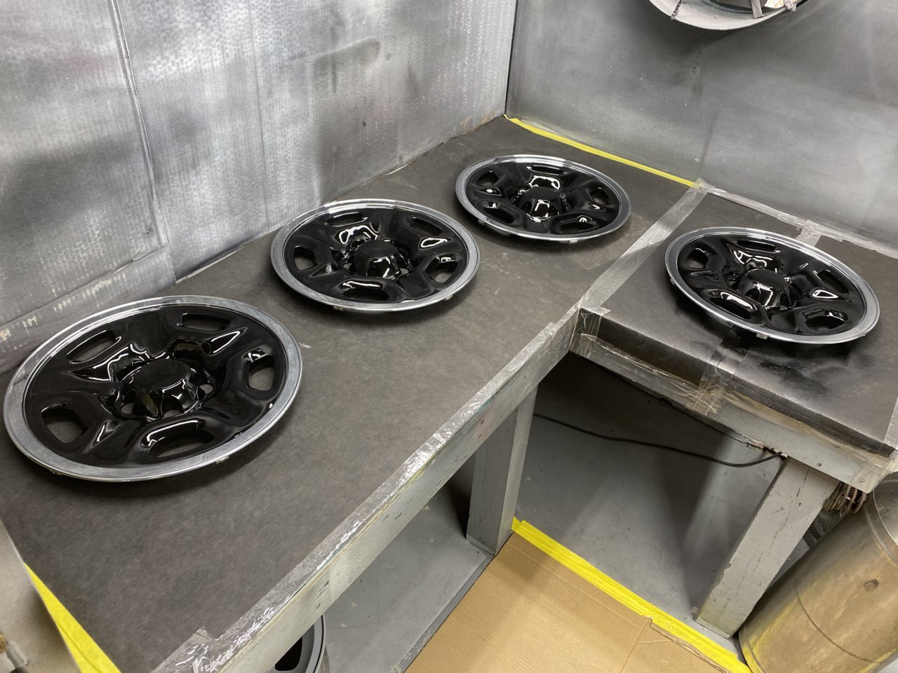

    @ColoradoTJ
    And my uncle just texted me these; Wheel skins painted! Just have to dry and then he’ll send them out on Monday or Tuesday!

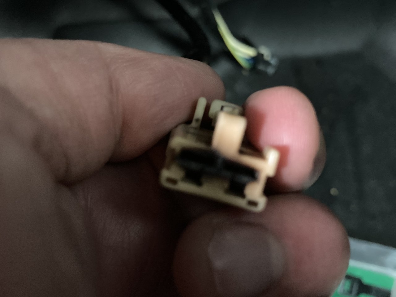

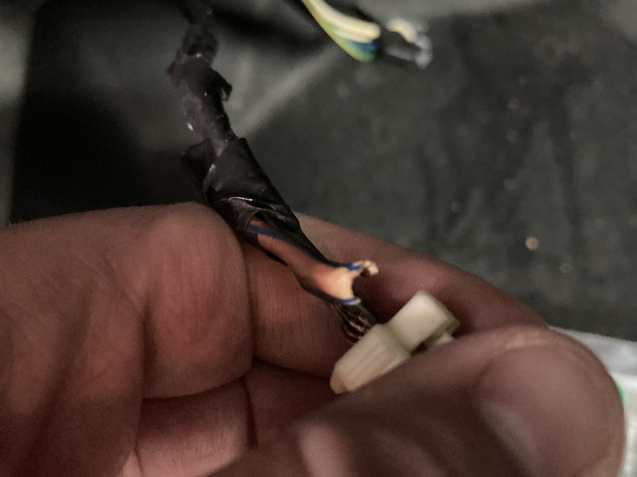

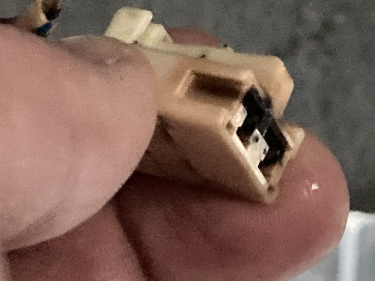

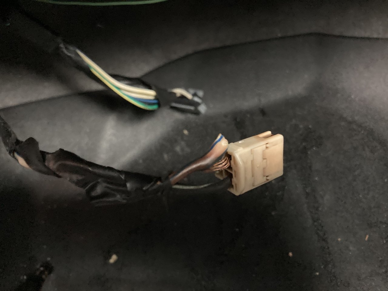

    The HVAC blower in my truck just suddenly started cutting out a day or two ago, so I stopped by my mechanic thinking the blower motor itself was failing; This is what we found...
    65EC8270-FDDA-460B-90FF-A677252D1591.jpg DF7534E1-E172-466E-84F5-8A31E5A05A59.jpg F87D41E0-3F2B-4F73-B01A-5018603C583F.jpg 41C62557-C512-4379-8EAF-A3D34F990C71.jpg

    So the problem has been solved; I bought new OEM parts at the dealer and my mechanic is going to install them for next to nothing. I’m just wondering if this has happened to anyone else?
    Thompson Toyota is like three tenths of a mile from my mechanic, so I drove to the dealer to get the parts, and when I bought them the parts guy told me that there was a bulletin for that specific part due to the connector melting.
    As of right now, my HVAC works, but it cuts out at random; My mechanic has given me a “don’t use the A/C or the heater unless you have to” order. Luckily, it’s gonna be in the high 60s and low 70s in my area for most of next week; The blower is getting fixed next Friday because my mechanic has to order one part the dealer didn’t have, and I already had an oil change scheduled for next Friday anyway...

    Found out why my blower motor suddenly started cutting out at random...

    And yes, apparently this is a somewhat common thing because Toyota has issued a bullet to replace the wiring harness for the resistor...?

    Ridiculously common problem. You can buy new pigtails (connector + 4-6" length of harness) from the dealer, almost guaranteed to be in stock due to how common this is.

    Already got the parts, but not so good at splicing together so my mechanic is doing that when I bring it for an oil change...

    That isn't a short circuit. That is a burned wire and connector due to a loose fitting female to male connection acting like a heater.
    Just to clear things up.

    Yeah very common I fixed mine for practically free, went to a junkyard with the old plug in hand and found a harness with better connectors and a higher temp plastic that fit the motor, it came out of a Honda of some kind. Haven't had an issue for a few years.

    GM wiring strikes again. The entire HVAC system on our trucks is a GM Delphi special, including that section of the wiring harness.
