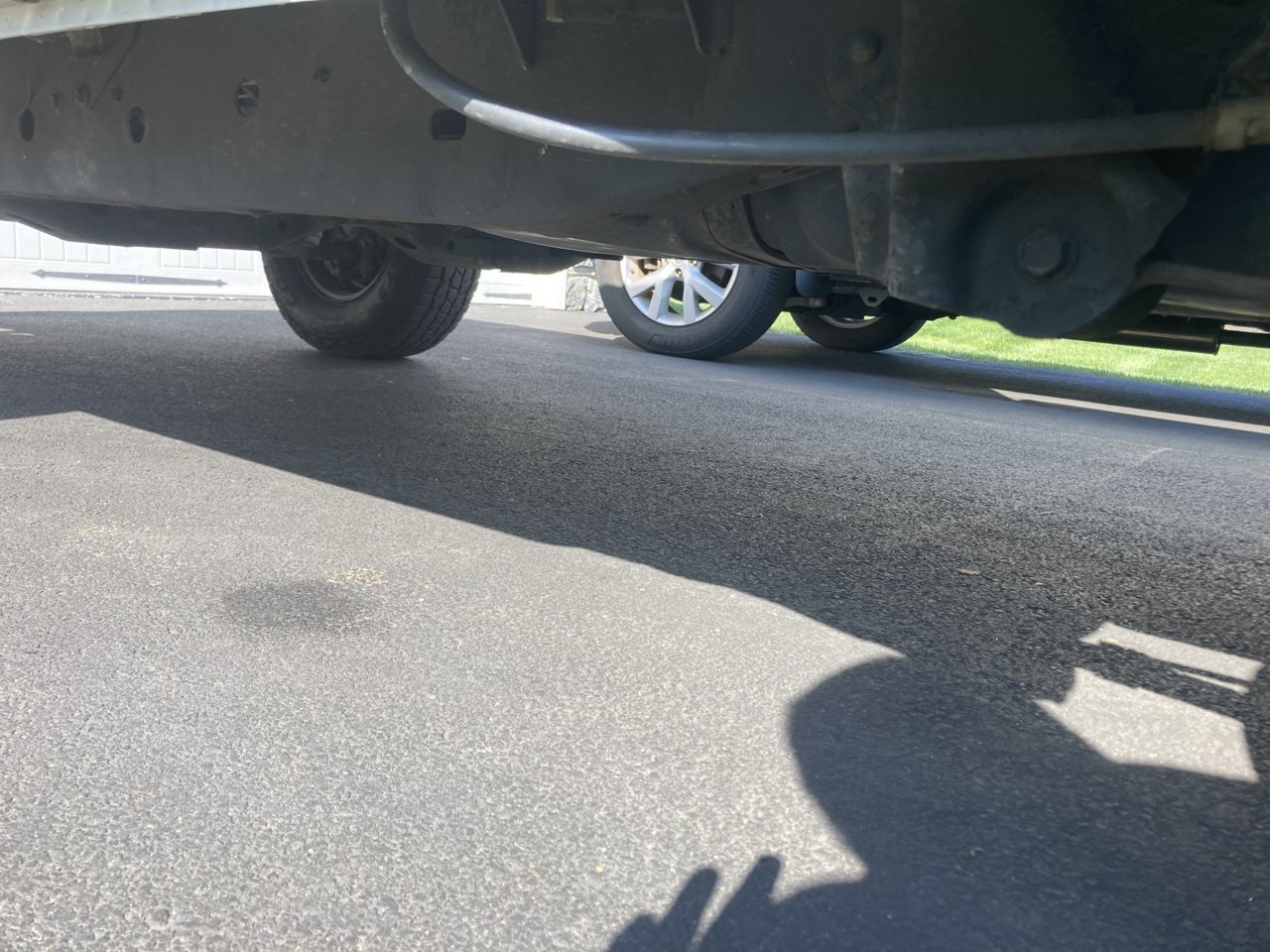

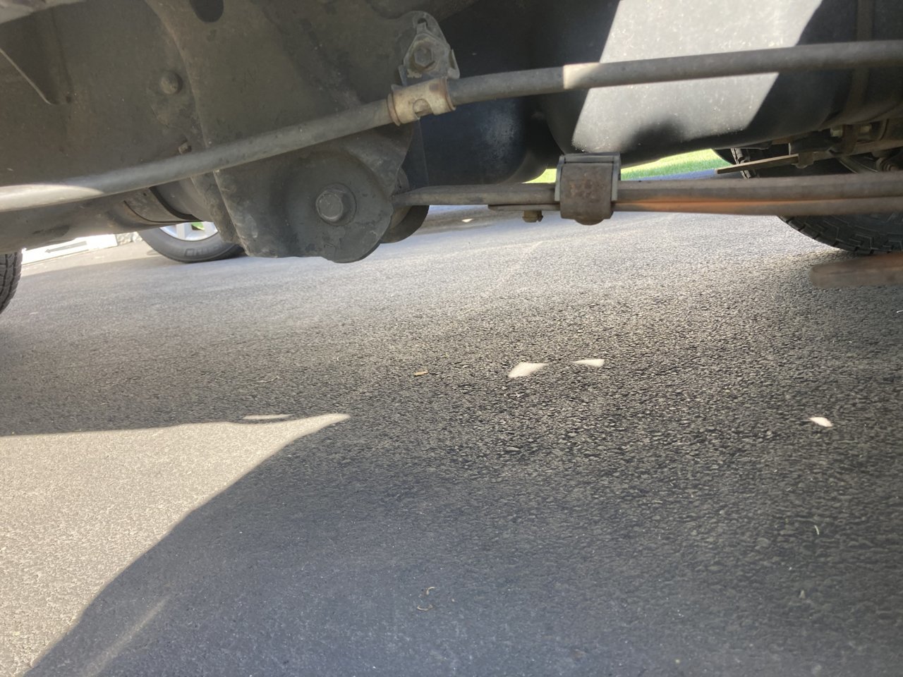

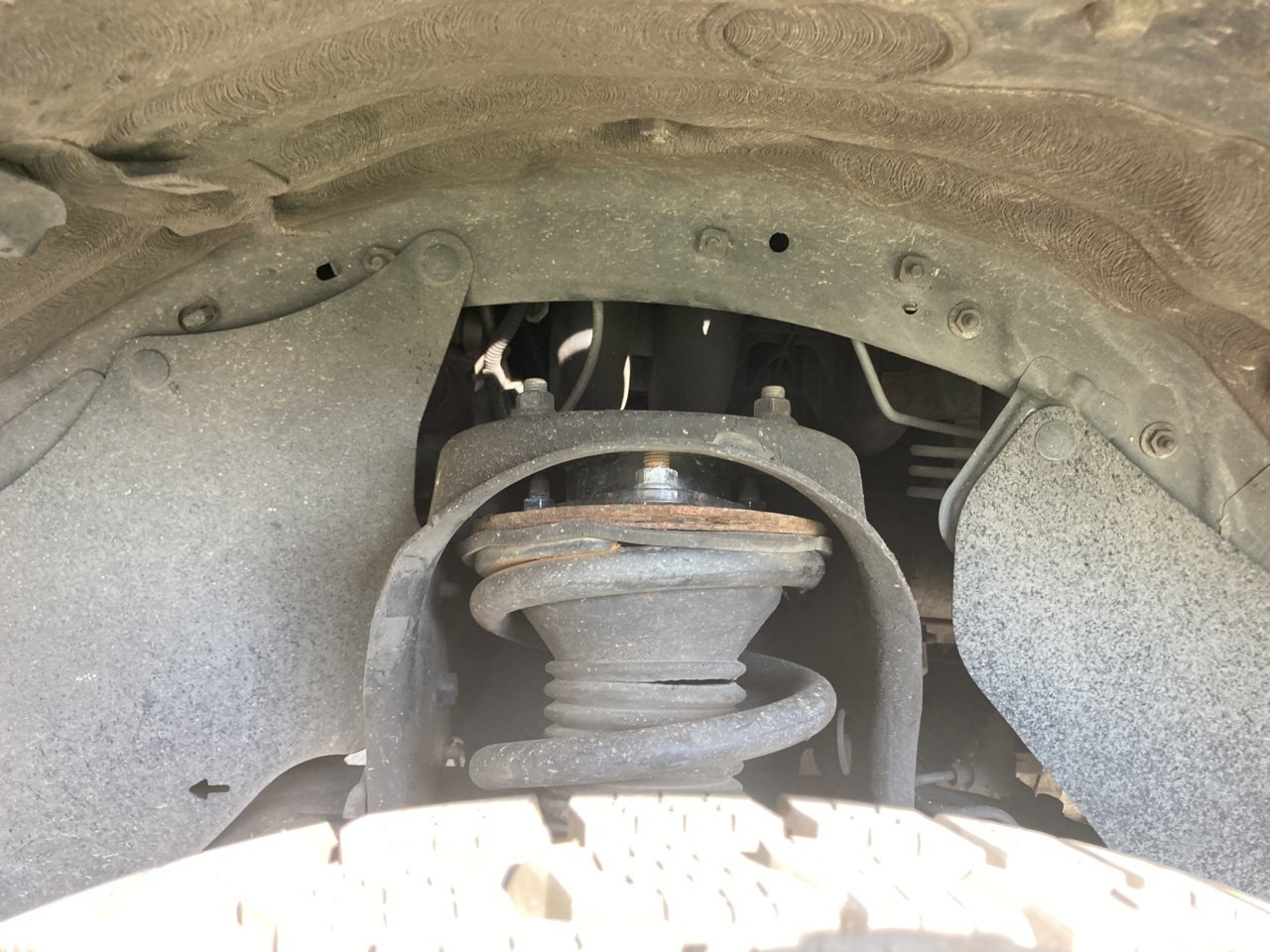

    I took a bunch of pictures under the truck earlier today; I had four Cooper Discoverer AT/3s in 225/70R15 that were installed in March 2019 and had well over 30K on them. I got a flat in January 2021 and had to replace one; That tire only had a few thousand miles on it, so I had my mechanic put it on the spare when he installed the 235/75R15 Coopers...

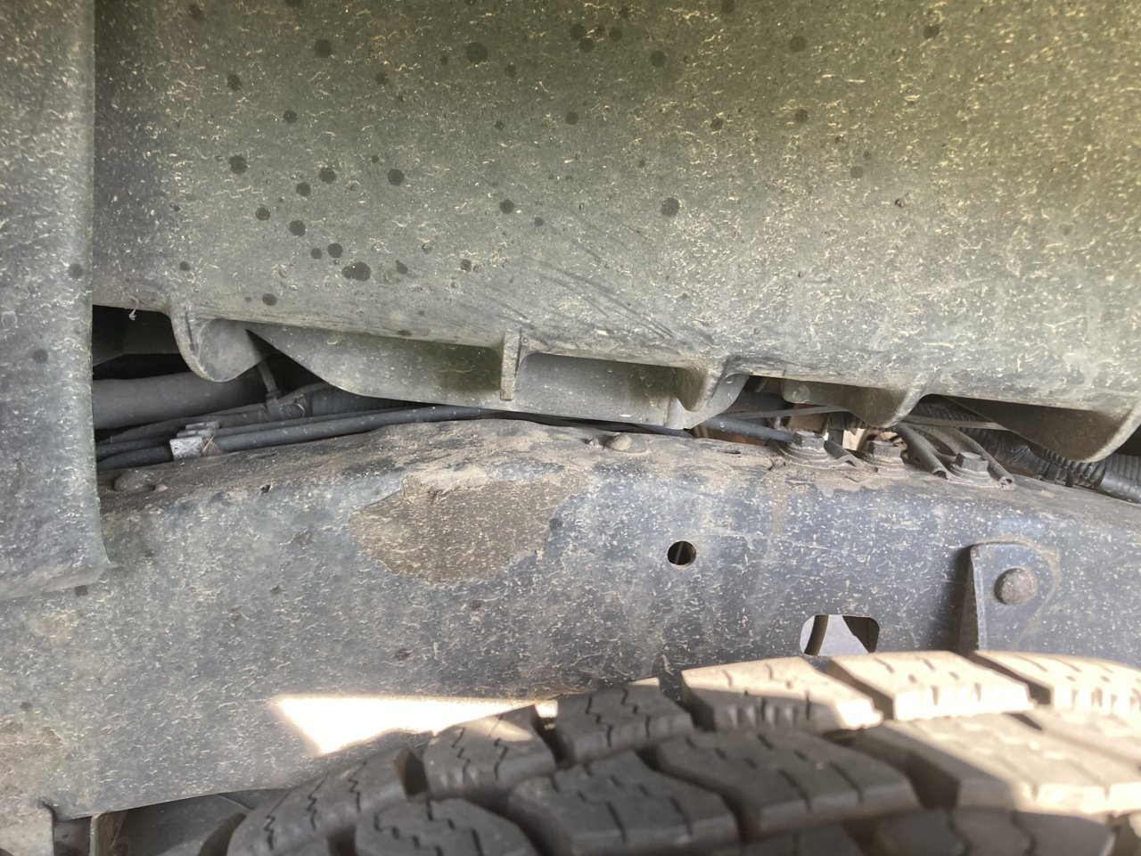

    As I said before, the dealer tested the frame as per the recall back in October 2017...

    This little thing was a bit loose...
