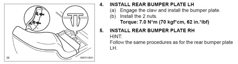

    The manual shows that the studs are bonded to the plastic cover and nuts under the bumper. Along with one clip. Looks like the body shop pulled a fast one and reused the original with putty to hold it together.

    Yep that piece should clip/bolt down, not be glued down with epoxy.
