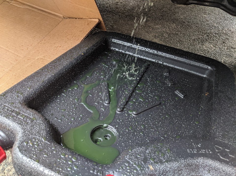

    Theres a drain at the bottom of your radiator.
    In an ideal environment, you would open it when cold to prevent potential for burn from coolant. but because you potentially have some contaminates that aren't consistently mixed/float to the top, you may want to take the sample hot after driving for 20 or so miles. You can open the drain with the coolant hot, I've done it before when flushing the coolant without removing the thermostat. Just be careful that there is a deep drain pan underneath to prevent splashing and that you wear some gloves in case it does splash up on you
    This is mine flushing the green out when some mechanic put in the wrong coolant. This was a hot drain, so as you can see it does splash a little
