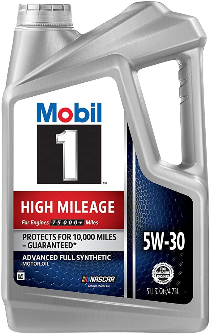

    Charlie.....dump the 0/20 and start using some Mobil1 High Mileage 5w-30. You'll use less oil. It scores an 11.9 at 100° C....meaning it's a heavy 30. Perfect for your engine that's showing some signs of age.
    The 2.7 was spec'd for 5/30 for many years. Quit listening to men over 60 in your life giving you outdated information about oil. Your father and mechanic are stuck in the past.

    His dad and mechanic have been telling him for sometime that it's dangerous to use anything other than what the manual states. Oil ignorance....it's rampant, even among mechanics.
    Running a heavier oil in the 2.7 will harm nothing. The whole..."oh my god, it will mess up the VVT-i or the clearances are too tight for a heavier oil" are just the same old recycled nonsense people hear and repeat.
    Ow-20 oils are fine lubricants, as they are all synthetics and some, like GTMO are quite high in moly which is an excellent antiwear additive. However, 0w-20 was introduced as a way to reduce internal engine loads to eek out a bit more MPG.
    A 0w-20 oil at cold startup is considerably more viscous than a 5w-30 is at operating temps. So, are you doing harm to your engine the 1st few miles on a 0w-20 every time you drive it? Of course not.
    If you have an engine that's burning a bit of oil, step up 1 viscosity grade. It won't hurt a thing. Viscosity grades are on a spectrum....meaning that each weight has a range it can operate in and still be labeled as that weight. That's measured at 100° C and a signed a number. 30w oils are around 9.3 to 12.5....higher number being heavier.
    M1 HM 5/30 comes in at 11.9...darn near a light 40w. That 2.7 will love it. It also likely to help clean out the engine as it's high in detergents as well as reduce consumption

    Should have gone with the high mileage formula
