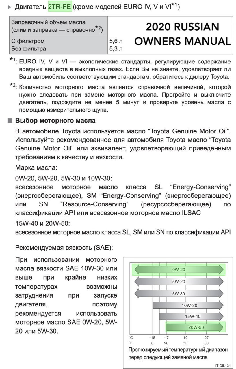

    You don't need a cylinder "leak down" test. Totally silly because your cylinders will still have perfect compression. 3500 miles/quart is normal at your mileage for someone using 0W-20 or 5W-20 oil and who has been extending oil changes to 7500-10000 miles or one year. You can reduce the consumption by using a slightly heavier oil (5W-30 or 10W-30 high mileage) & changing it every 6 months or 3000 miles to keep the engine (piston rings, PCV Valve, etc) cleaner.
    Your head gasket is almost certainly not blown. To verify, remove coolant overflow jar and clean it out. Drain & refill radiator at the same time. Refill both with Toyota Pink Super Long Life Coolant and drive normally to see if any signs of oil in the coolant re-appear after a period of weeks. Drain & refill your transmission too (if you have an automatic) to look for signs of coolant contaminating the tranny fluid. There is a slight chance the transmission cooler that's built into the lower tank of the radiator is leaking tranny fluid into the coolant and vice versa.
    The 2TR-FE will not be damaged by 5W-30 or 10W-30 oil. Owners manuals throughout thw World (e.g. Russian one below) say it can use oils as thin as 0W-20 and as thick as 20W-50.
