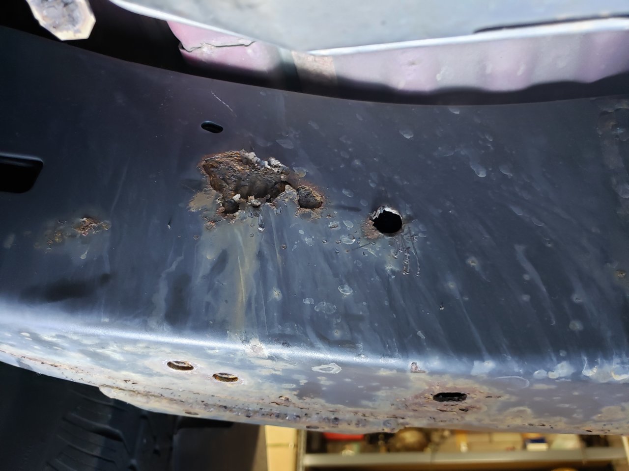

    They don't care about those gusset plates - they want to see a perforation in the wall of the frame. Ask me how I know.
    Check the boxed-in areas, inboard of the frame, near the primary cats. Those are the first place to go. I would recommend going after the whole area with a needle scaler ( ) which will blast off any heavy thickness rust that is currently being held in place by the CRC, but will not harm good metal in the slightest bit.
    Per Toyota, the dealership is not permitted to scrape, hammer, or otherwise properly look for rust - the holes have to be visible without the dealer touching anything. Again, ask me how I know.

    Mine was replaced at 306k miles so it’s not mileage. The trucks age is a definite factor, 12 years old as you already stated.
    The frame needs to have a rust hole at least 1 centimeter so I’ve been told.
    @PennSilverTaco,
    Has the dealer undercoted the frame with CRC? If they have, as they did mine, I would routinely pressure wash the frame. That will remove the CRC, exposing the rust which is how the dealer found mine and replaced the frame.

    The dealership doesn't "approve" anything - they follow Toyota's TSB inspection procedures and if they find any qualifying (10mm or larger perforations visible without touching/scraping/banging anything) they submit photos to your area's Toyota field rep, who will give them approval to replace the frame on Toyota's dime.
    If the dealership doesn't find anything worth submitting, yes, I would recommend you look yourself in the most prone areas, using an air needler. If it kicks loose a big nasty clump of rust that results in a through-hole, take it right back to the dealership for another inspection.

    I would check up further. Look at the passenger side where the front of the cab is. They rust from the inside out there due to the ac condensation. Maybe take a *small* here and tap around that area. That is how I found mine as it was otherwise not noticeable.

    Pics in my album, but I found the 2 holes on the outside and underside of the passenger rail near the door. The larger one was about the size of a quarter, pushing on it with 2 fingers caved it in.
    The actual job takes 4-5 days with 2 techs, but getting the frame made and shipped to your dealer takes forever.
    I'd suspect if yours does fail the inspection they'll take it right then and give you a rental, technically they shouldn't/can't let you leave with it if deemed unsafe.

    I would definitely pressure wash the frame a few times before heading to dealer. The dealer does not remove the existing rust prior to undercoating, they just apply CRC and the rust continues unseen.
