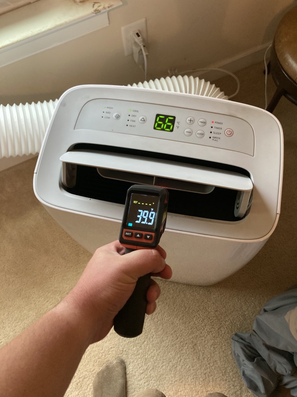

    It’s only year old, it works great, and it was free!
    :cool:
