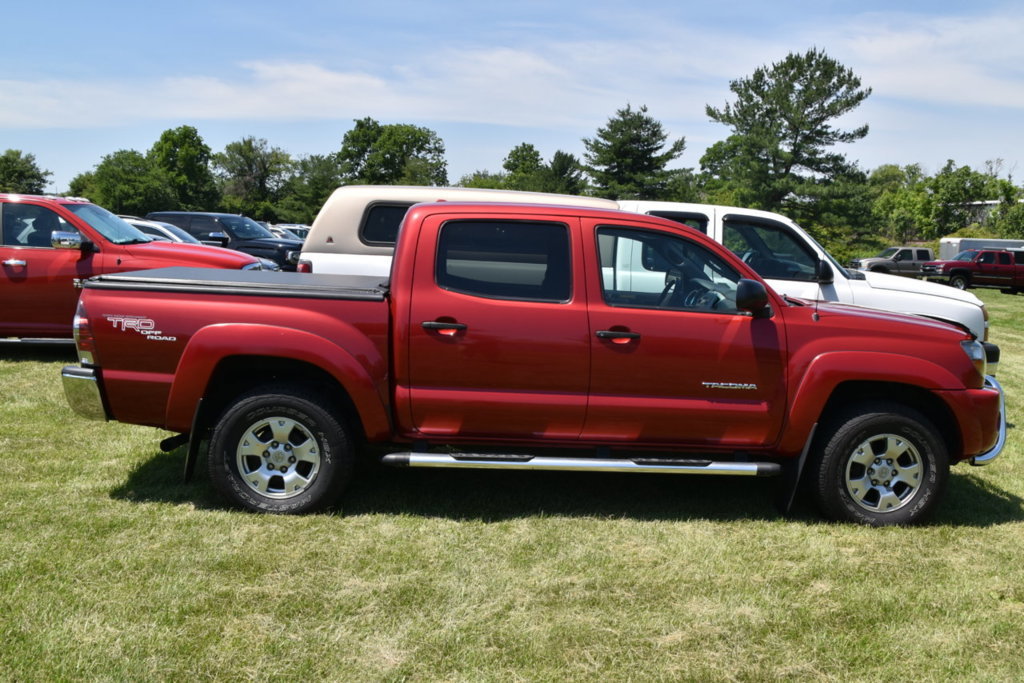

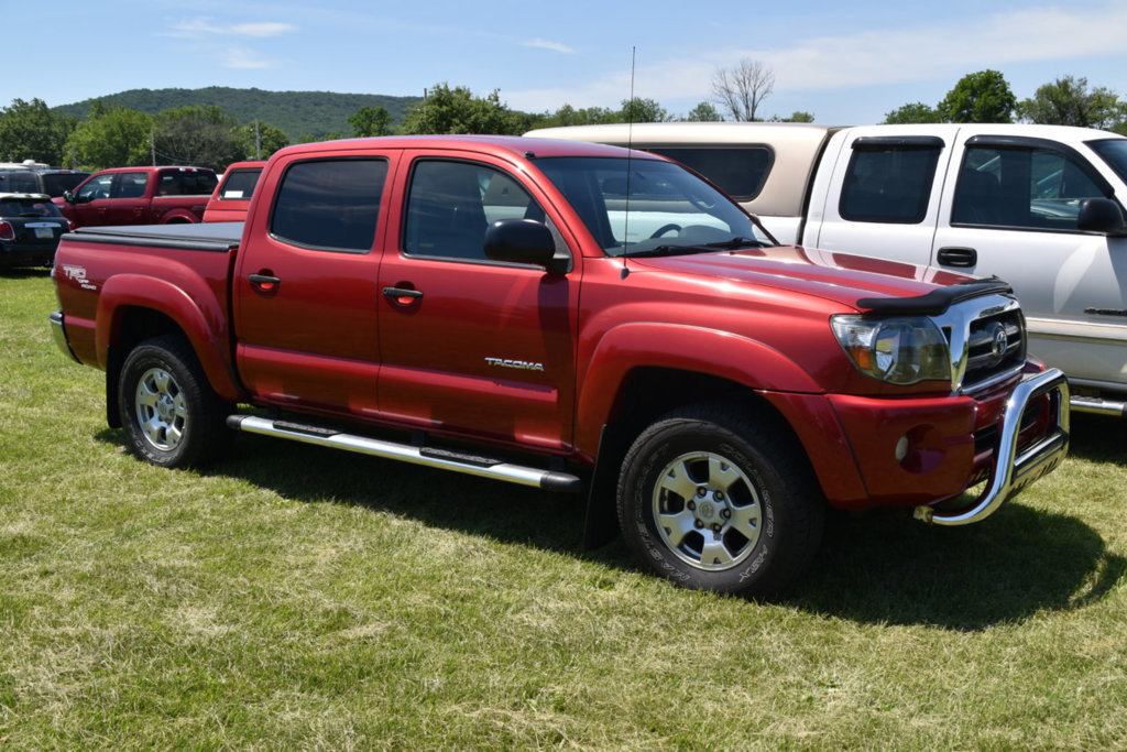

    Here’s another Taco with the same Bull Bar (but in chrome) that I took pictures of back in June 2021; Unfortunately, it looks as though it’s installed in a manner virtually identical to mine…

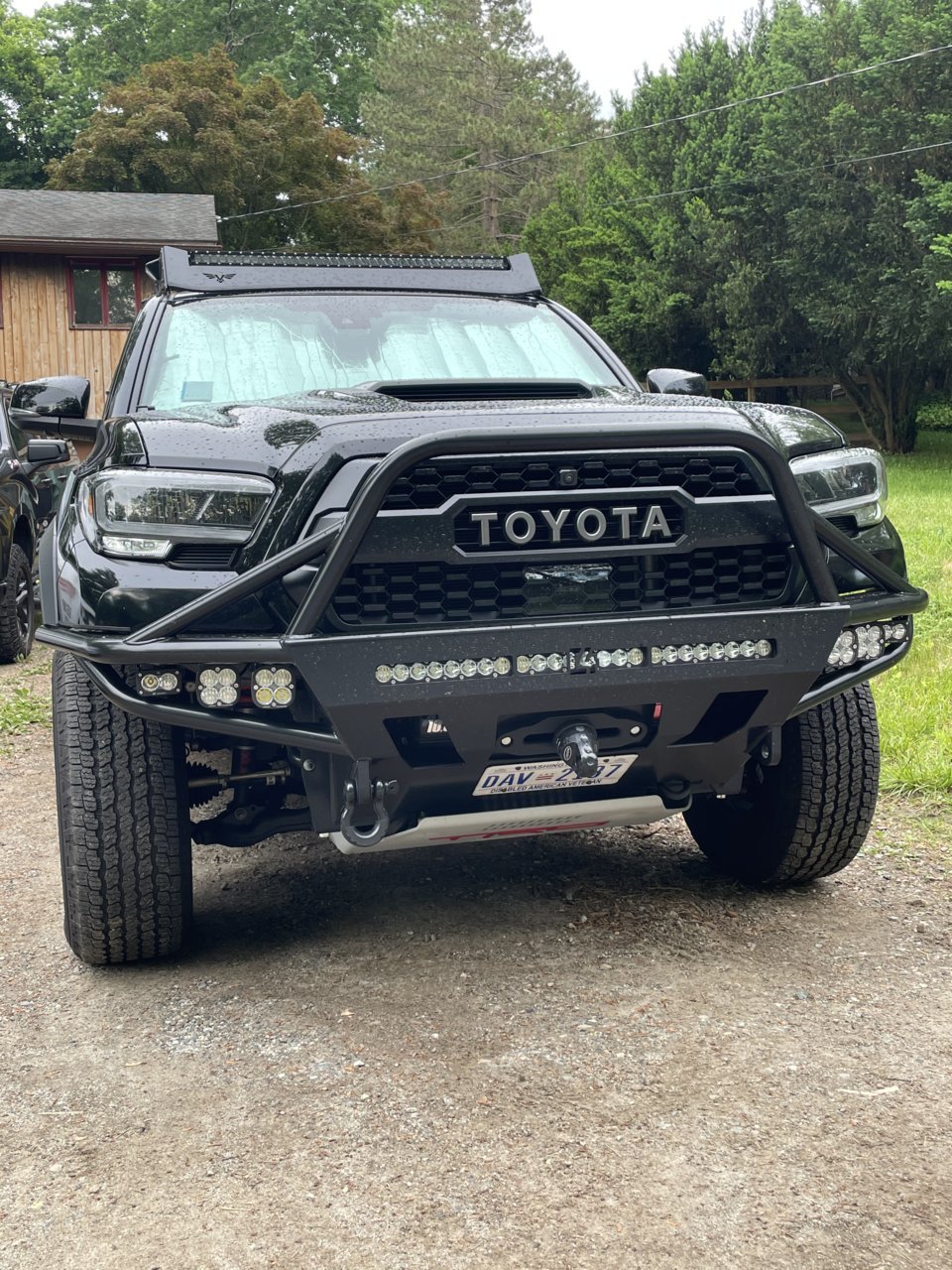

    Gussets are angled supports like on this bumper

    How much does something like that cost? More importantly, how much does it weigh? My gas mileage already sucks!

    I wasnt recommending you get something like that haha. Just echoing what others have said here and it's basically that those little push bars like you have aren't good for much beyond looking cool and hitting shopping carts

    As was already mentioned your bar will fold when a fat girl leans against it. It needs a strut high up on each side going back through the grill to the frame for any realistic support.

    I don't really care for the way it is fastened to your truck, no support. It will not do what you want it to do.

    Since you asked. Aftermarket bumpers can vary in price. If you buy a bumper from a reputable manufacturer you're looking in the +/- 1k range for a steel bumper. My bumper is aluminum and it weighs ~50ish pounds on its own. Factor in a winch (I run a synthetic line) and you're tacking on an extra 60ish pounds. So for my set-up its roughly 100-150 pounds. I don't think it'll affect your MPG's all that much.
