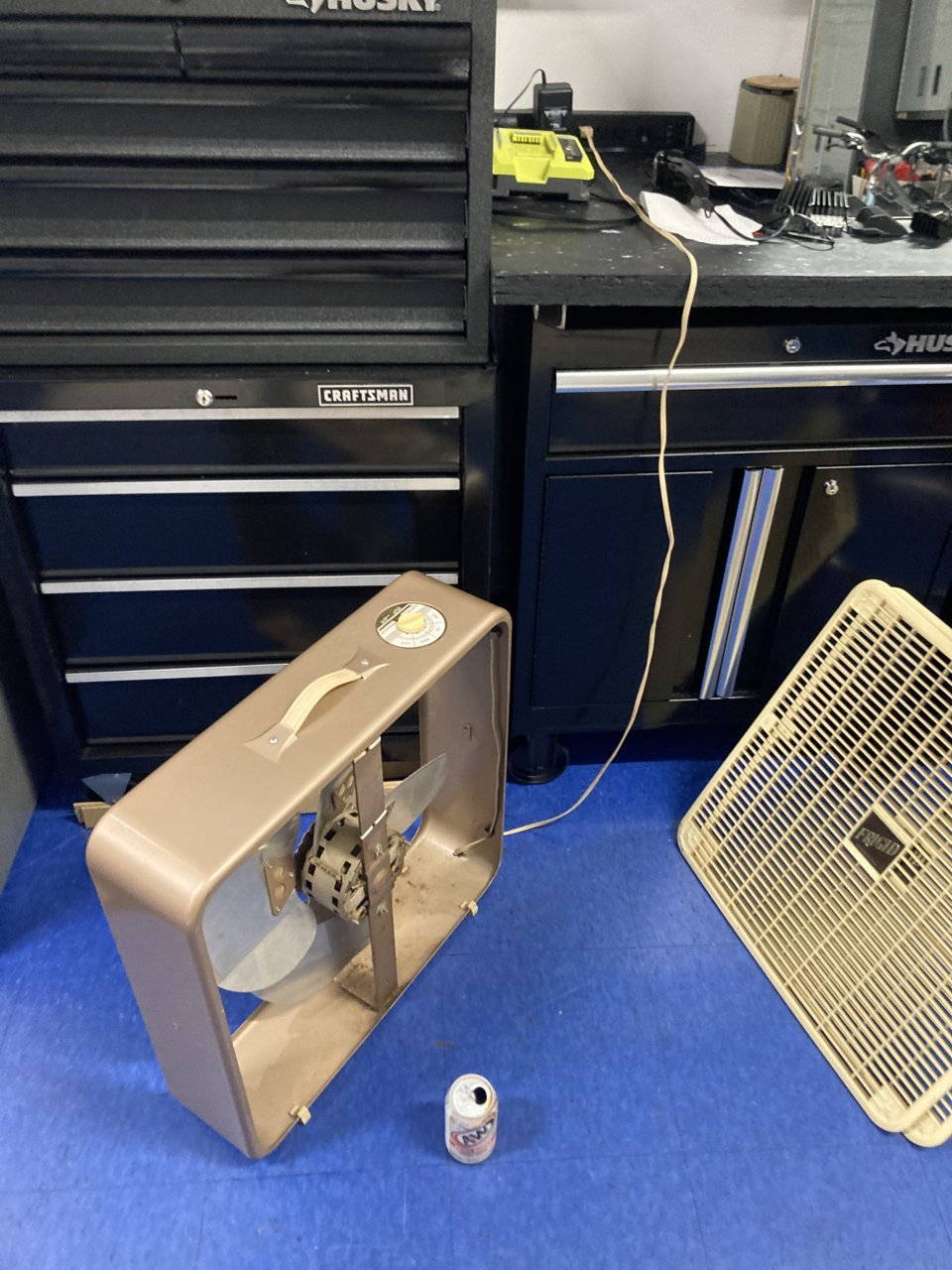

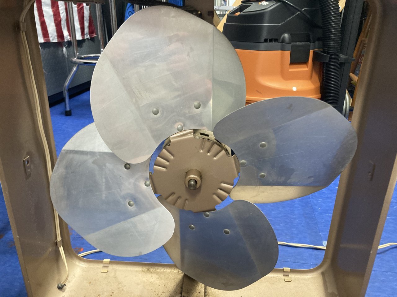

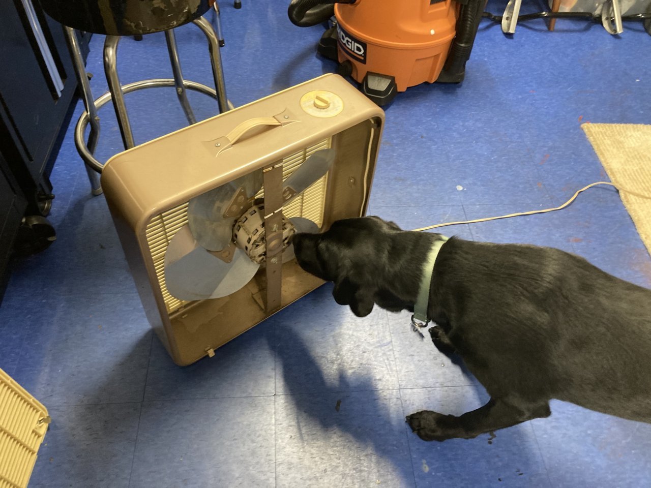

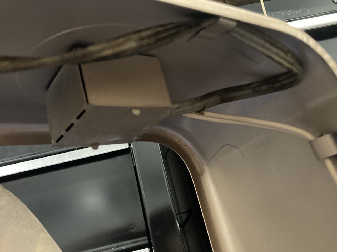

    I pulled the back off of the fan; Porter is a bit scared of it and approached it cautiously...

  4. Sep 14, 2021 at 5:36 PM
    0xDEADBEEF
    Mar 2, 2019
    #285037
    19,847
    2000 reg cab 4x4 flatbed MT
    Good time to check the switch with a multimeter too

  5. Sep 14, 2021 at 5:36 PM

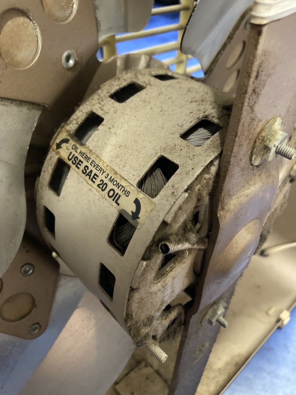

    I'm guessing the previous owners didn't oil it every three months...

    I'd start with cleaning it up and some oil/grease. Then go from there. Often times electric motors can have parts in them designed to fail if they get too hot. Those two are the most common reasons these get sent to the landfill aside from being outright broken.

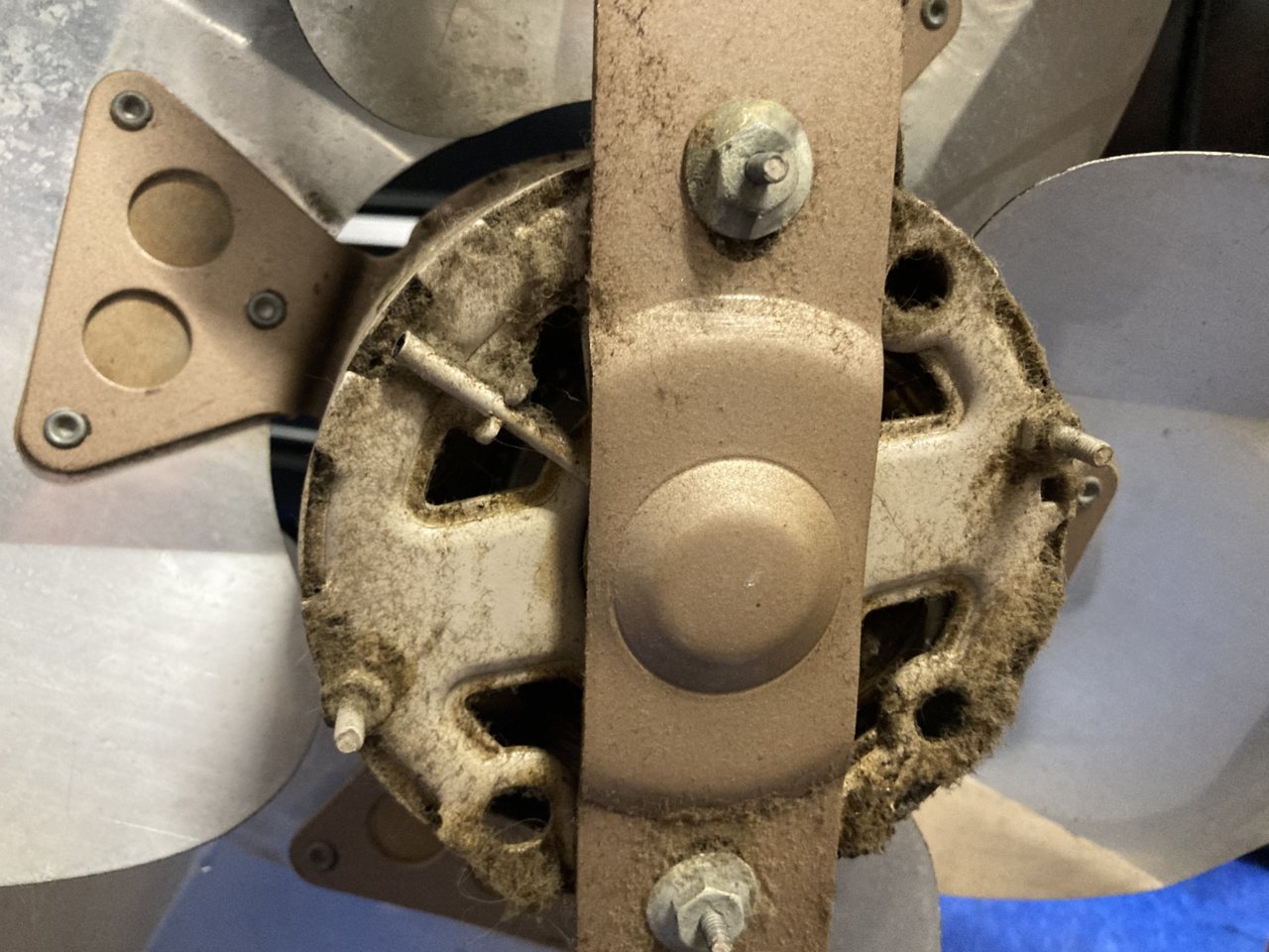

  14. Sep 14, 2021 at 5:42 PM

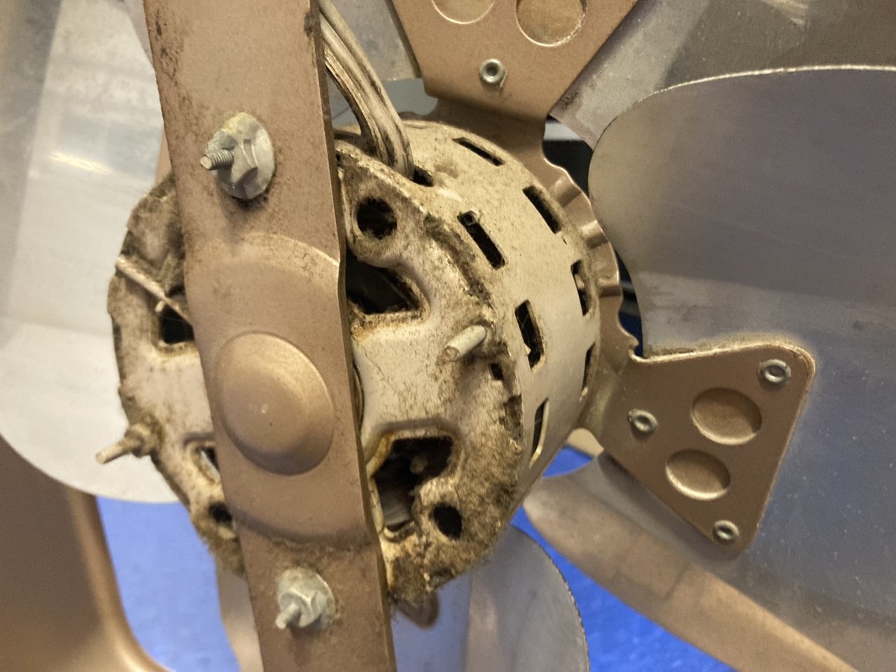

    Tried that; Motor looks pretty fucked though...

  15. Sep 14, 2021 at 5:43 PM

    I hear nothing from the motor; Blades spin freely though...

    RedWings44
    RedWings44 Well-Known Member
    Apr 28, 2020
    #326226
    8,076
    Michigan
    2017 Black TRD Off Road 4x4, 2019 MGM 4Runner SR5
    Definitely looks dirty, but I find most things I restore simply need a good and thorough cleaning

  17. Sep 14, 2021 at 5:45 PM
    Empty_Lord
    Empty_Lord Toyotaholic
    Mar 13, 2016
    #181186
    28,303
    Dan
    Northwest Indiana/Chicagoland
    It looks to be in good shape body wise… wouldn’t toss it for sure… I bet the switch is worn out… at least that’s what the old fans I use in the garage has issues with… same vintage too
