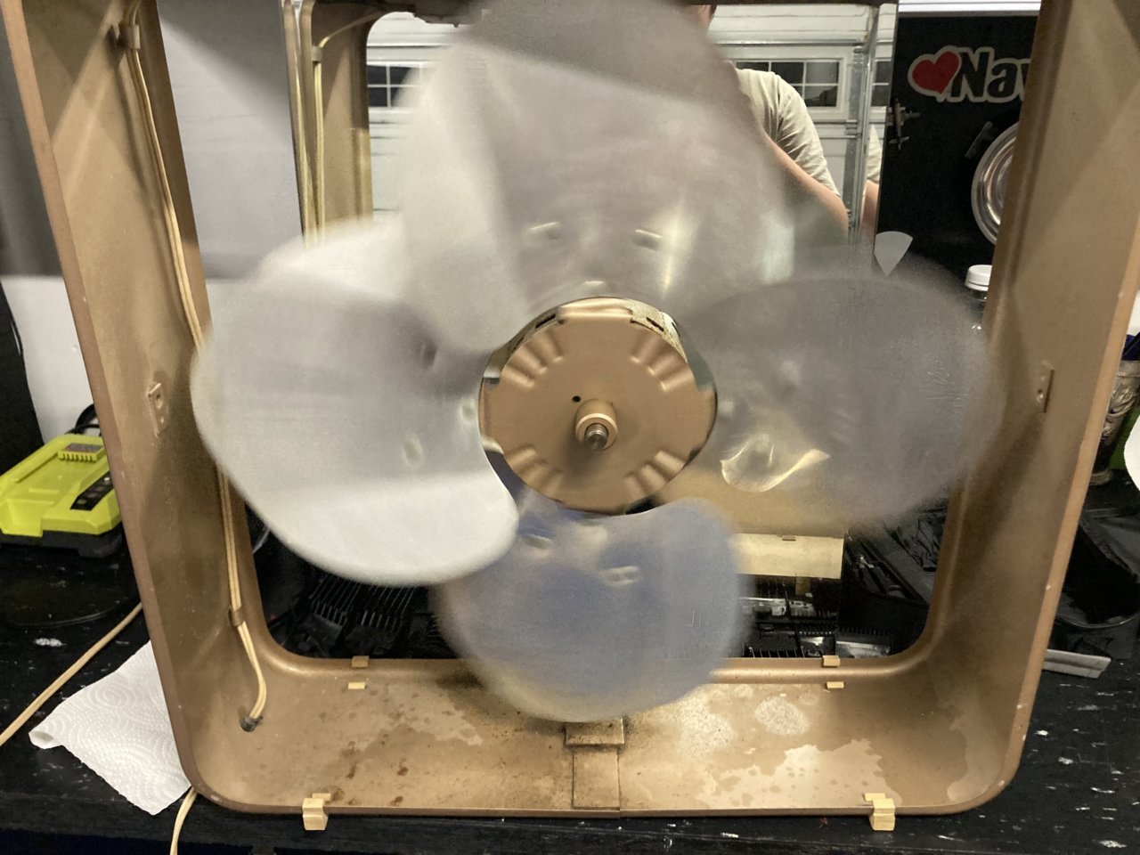

    Even just turning the blades by hand, the amount of airflow this thing generates is impressive!

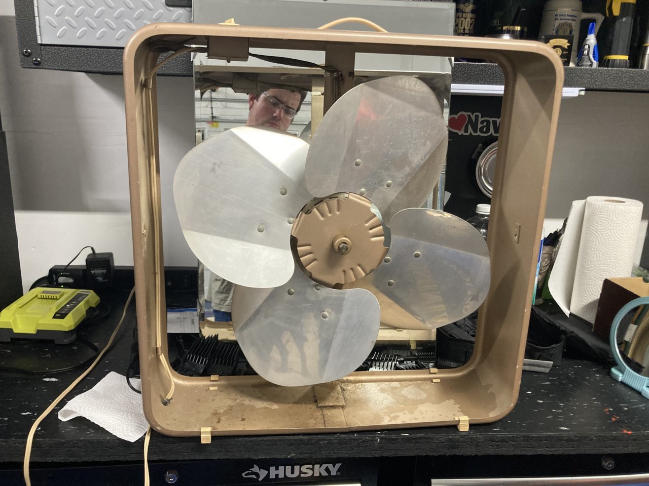

    WD40 unsurprisingly didn't do anything...

    Next step is to begin troubleshooting the electrical. A multimeter would be great for that.

    Yea before going further you need to see if powers even getting to the motor

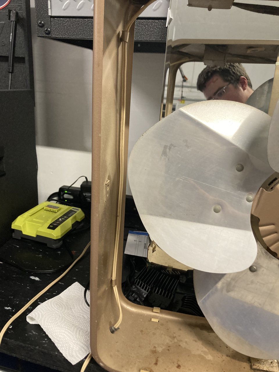

    Cord is in good shape...

    One more thing just for shits and giggles: have you tried cleaning up the contacts on the plug? They look ok to me but it doesn't hurt to try.

    I wouldn't spray WD in the motor but the air compressor and a good blast of air all around. Couple drops of 3 in 1 oil was made just for that fan:rofl:
    Could very well be the switch.

    But I’ll bet you can get that one working, something probably just needs rewiring, or a new switch. Just start slowly tearing it down, you’ll find the problem. Also, good time to invest in a multimeter, not expensive.

    I appreciate a good solid fan, especially with metal blades. They should hum with the smoothness of an aircraft engine at cruise. I dont think this is economically worth the time and effort to fix, but as a restoration could be a fun project.
    A multimeter will make diagnosis far easier. Without one I’d suggest bypassing the switch and applying power directly to the motor. If it works it is likely a bad switch, if it doesn’t it is a motor issue.

    A lot of times all you need to do to fix that vibration is to balance the blades. Given that it is a cheap fan they definitely didn't bother to do that. But basically just find the heavy spot and put a small screw in the other side. You'll have to experiment with the right size screw though.

    I have a cousin to that fan. I think it a VIM, at least 55-60 yrs. old and works like a champ... I'd vacuum the motor, no WD-40. If you already used WD blow it out w/compressed air. As has been said check for voltage starting at the cord.

    Nice find! Built when simple household products were designed to last.
    The motor should clean up gently with an old paint brush and a vacuum cleaner for starters, then some gentle compressed air action.
    Don't use WD-40.
    A few drops of 20 WT non-detergent engine oil in each port is all that is needed for lubrication. You may find a small bottle of "electric motor oil" at a real hardware store, it is the same 20 WT. The motor bushings are made of a material that will absorb the oil, sintered bronze, commonly called an Oilite bushing.
    First thing to do is inspect every inch of the cord visually and also by gently flexing it. Pay special attention right at the plug and where it enters the fan. These are the areas most prone to damage and often your problem is there.
    It the cord passes the visual/flex test now it is time for a meter. If the cord is in good condition there is really no need to replace it.
    There are only 2 wires, check each for continuity point to point - plug to switch, through the switch, switch to motor.
    Nowadays you can buy a really nice meter for much less than $100, no handy guy should be without one. (or two, or three...)

    Have not read all the posts, so if this has been suggested, please disregard, but you could have the motor rebuilt. Before I did that, I would check the rheostat (switch). Try bypassing it and seeing if the fan motor runs first, then find an electrical shop that can rebuild the motor. A new fan will still be cheaper, though.
