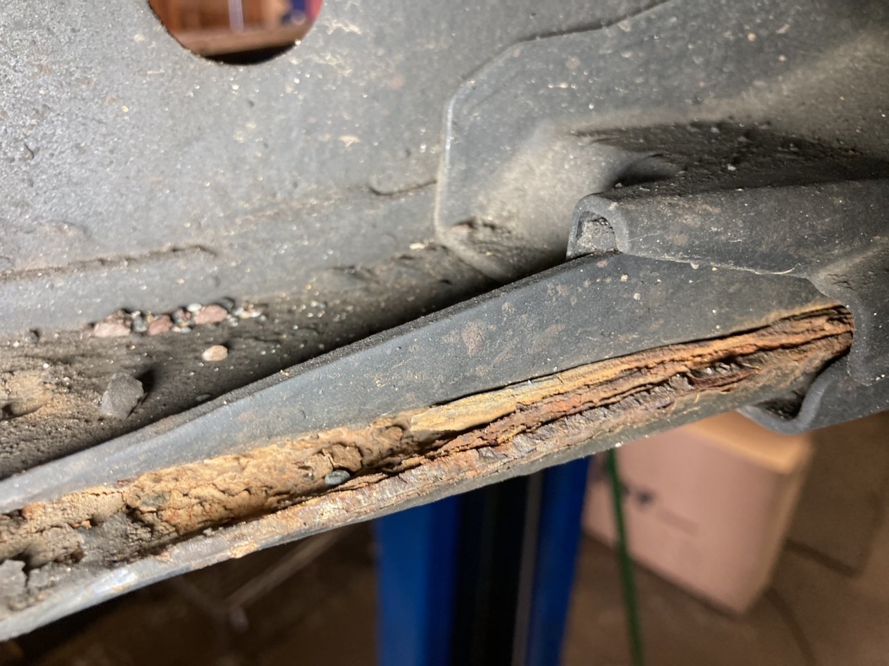

    So, my truck is going in for one more inspection at the dealership about a week before the warranty period ends; The once service manager at Thompson Toyota informed me that there's a 50/50 chance of my truck getting a new frame at this point, and that there a good chance it'll get the new and improved frame treatment if it does not qualify for the complete frame replacement...
    If it doesn't qualify for either, I'm getting the one incredibly minor rust spot on the frame rail beneath the driver's door professionally repaired and having the frame treated; I need this truck to last me at least another five years so I can save up for a house!

    I'm going to predict exactly what will happen based on the pics you posted. (And I work at a dealer.) 1) You will not get a new frame - not even close. 2) You will get the latest frame corrosion treatment process which will qualify you for the "12 years from first in-service date" warranty. Ladies and gentlemen, place your bets.

    As I've (repeatedly) stated, your frame needs to be in much worse shape than its in. You're not even close. No way, no how. The frames I see qualifying for replacement are total rotted out pieces of crap. At a minimum, you must have a 10mm hole rusted completely through. At the rate yours is rusting, that should be another 10-15 years.
    As for a warranty extension, don't you think 12 years is pretty generous? Good lord man!

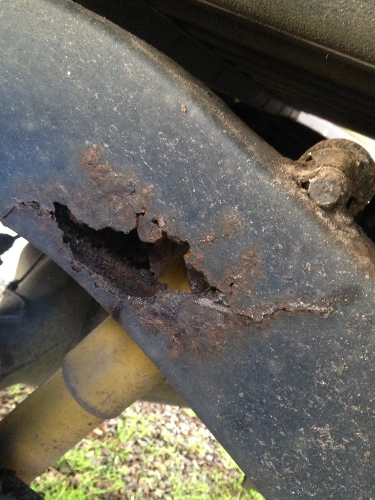

    Correct. I have a 2001 Tacoma with a 24 sq in hole (measured at the dealership) that was rejected by Toyota proper for a full frame replacement. So I am forced into the position to either purchase a frame or get a not-so-perfect repair on the current frame.

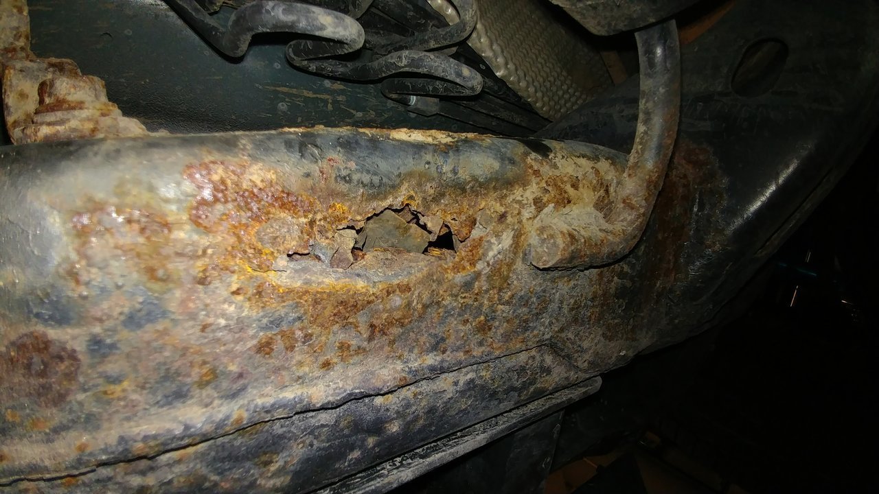

    This hole got me aproved for a new frame back in 2018. Waited 2 1/2 months for parts and then a week for the swap. As you can see that hole meets the 10mm perforation requirement for approval.
    • Free Frame Inspections at authorized Toyota Dealers to determine whether your Subject Vehicle’s frame should be replaced and, if the Subject Vehicle is registered in Canada, the Subject Vehicle will also be evaluated for application of the Corrosion-Resistant Compounds (“CRC”)
    • If the frame meets the Rust Perforation Standard, which is a 10 millimeter or larger perforation on the Subject Vehicle, as further described in the Settlement Agreement’s Inspection Protocol, a replacement will be provided at no cost to you; or
    • If the frame does not meet the Rust Perforation Standard, CRC has not been previously applied and your frame has not been previously replaced, CRC will be applied at no cost to you. Toyota will send a reminder notice to the Class when there is only six (6) months remaining for the CRC.
    My bet is they will do nothing for you. You have no visible holes (unless you make one ;)) and you've stated you already had the frame coated. Besides your frame will definitely last you that 5 years your hoping for and more.

    A "24 square inch hole." Last time I checked, that was 4"x6". I don't think so.

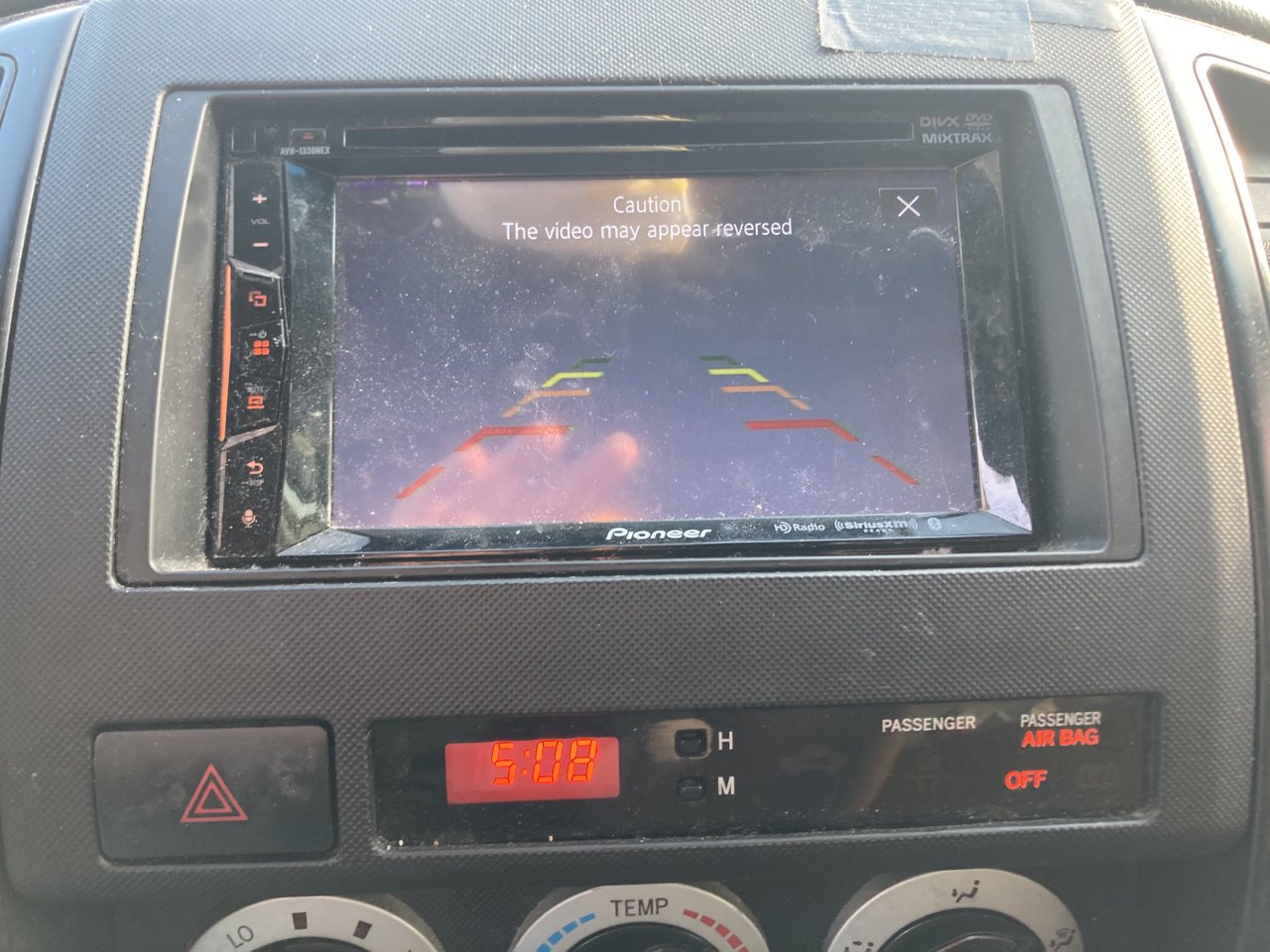

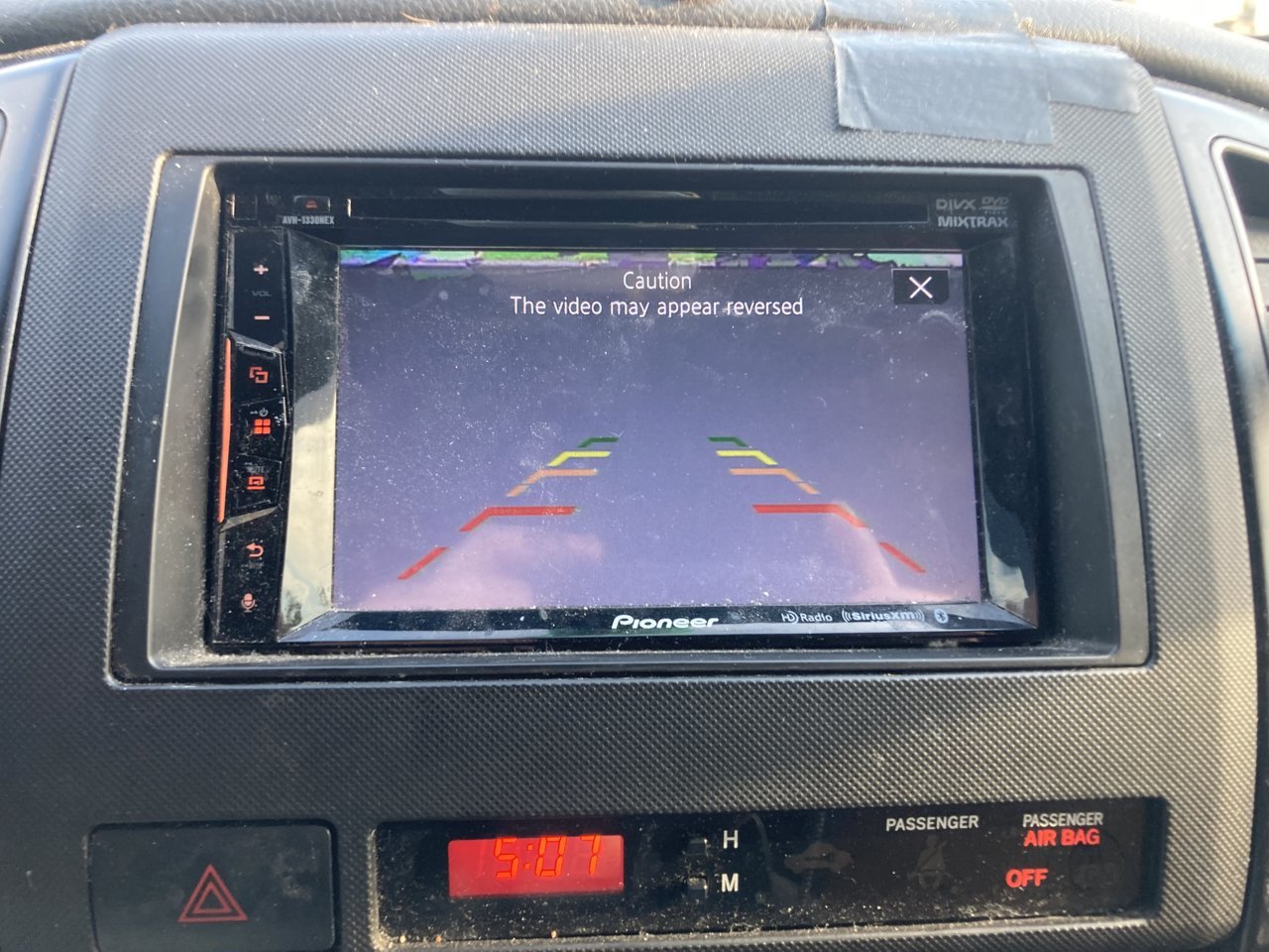

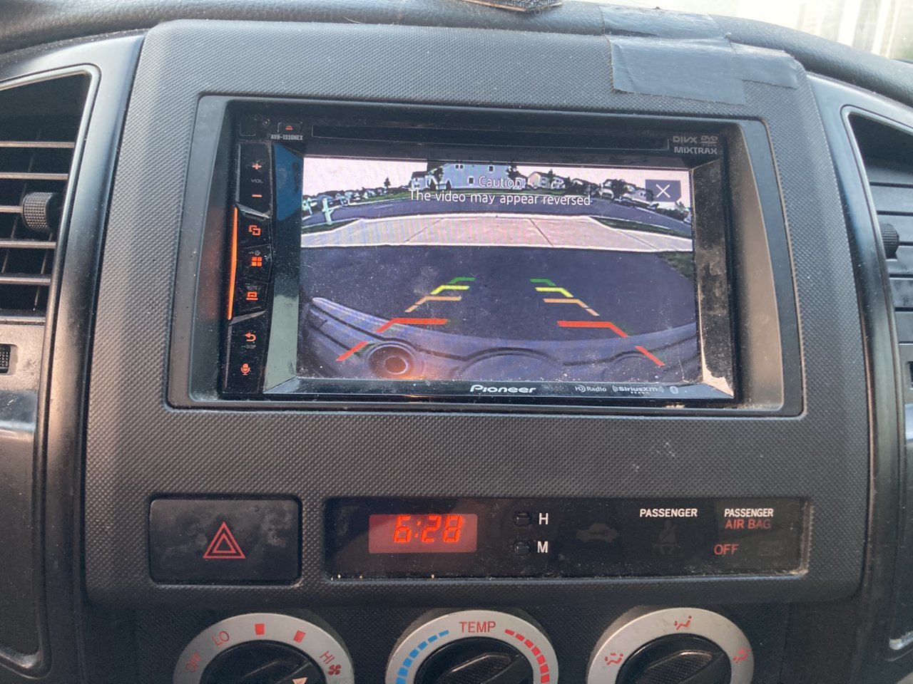

    Starting acting up again when I was backing into the driveway...
  20. Sep 15, 2021 at 2:16 PM
    PennSilverTaco
    PennSilverTaco [OP] Encyclopedia of useless information...
    Jul 15, 2014
    #134007
    72,830
    Charlie
    Central Bucks, Pennsylvania
    2010 Zombie Truck 2002 PT Cruiser
    Shutting off and restarting the truck remedied the problem (note the time on the clock)...
