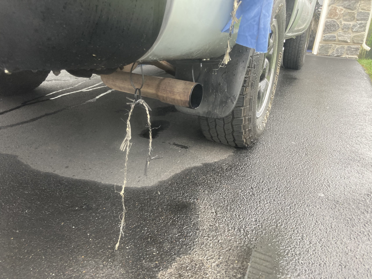

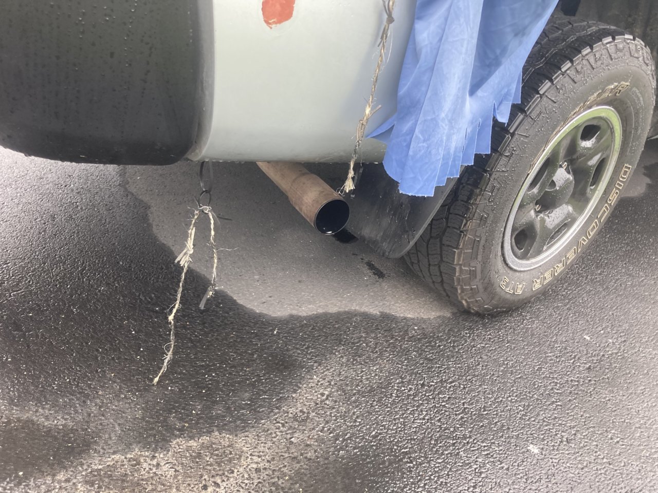

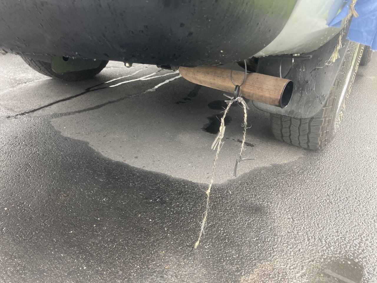

    So quick way to find out if its bad or normal oil burning.
    Take the oil cap off while its running, if you can actually see the gases, its fucked. Also if its louder than a slight purr, its likely piston rings carboned up. If its quiet and no pressure is escaping, than its valve seals. Simple.
    You are using a good oil choice, but 5W30 would be more ideal, 10W30 is obsolete and there's no reason to run it anymore. It doesn't burn any less than 5w30, it just makes it harder to start in the cold.
    Biscuits, 6 gearT444E and TnShooter like this.

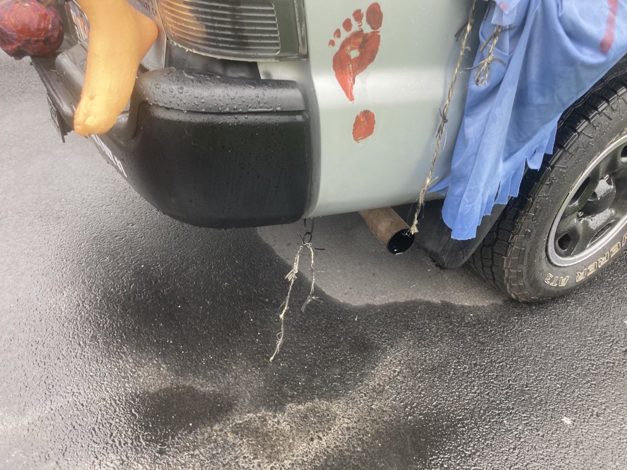

    I cannot see any gasses!
    1BE63114-F8EA-411A-B00C-2D4B892A577B.jpg 74263F0E-7961-492B-A752-DFA8E536777C.jpg

    Need to detail that motor id bet you have an oil leak that isn’t dripping on the ground and you can’t see it for all that grime.

    How loud is it?
    Try and compare the sound to a known good vehicle.
