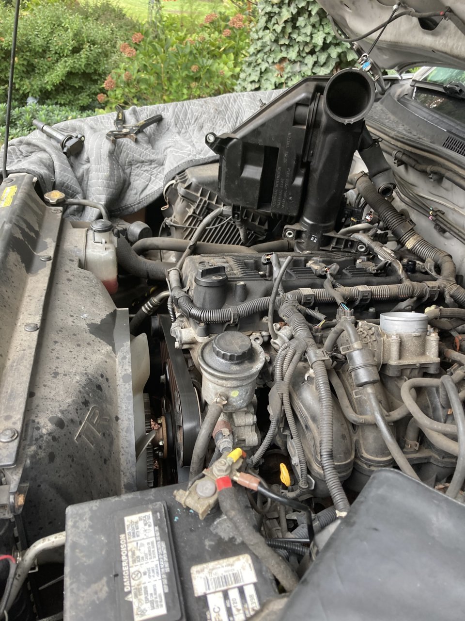

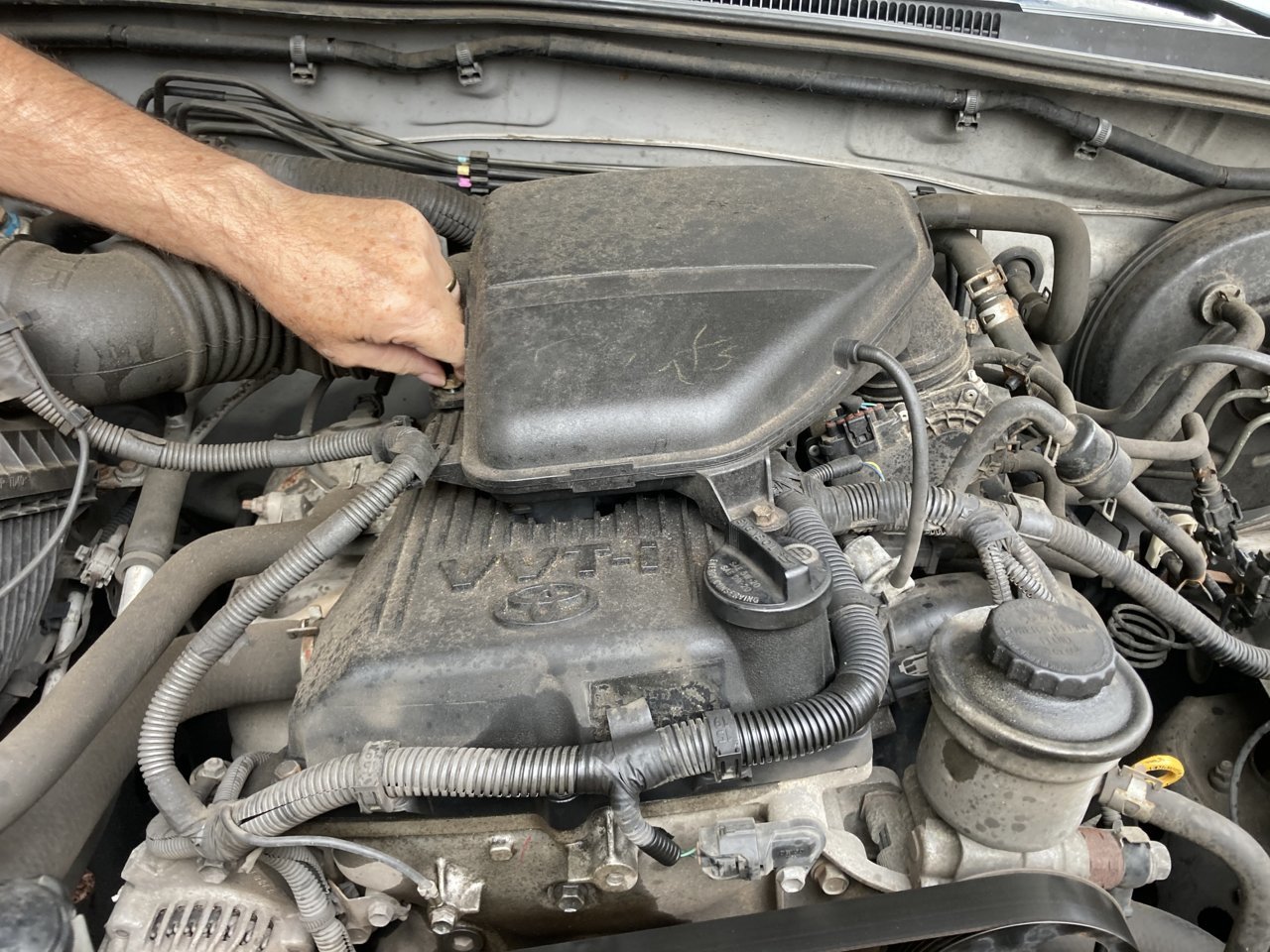

    Currently checking spark plugs...
    2F3FA959-8093-4AAE-BE3A-CF692FE9F712.jpg 64A59867-D6C5-44B4-98F8-86C5709EF0EA.jpg 6DE537C3-1386-4F8F-AAFF-086EDDB17AC7.jpg B4109518-1F1C-46F7-BF32-C4BAE1A7B948.jpg 6079E728-5E45-44C2-9282-D71CBF9FD8BC.jpg

    @PennSilverTaco I get that you want this solved now but from an economic standpoint, taking the long view and doing some data collection over the mid- to long-term is probably the way to go. You're putting miles on the truck at a fast enough rate that I think within six months or so you'll have narrowed down the possibilities pretty well. It's not particularly likely that your engine is at risk of having anything truly bad happening that's causing the oil loss. At least, it's unlikely that you'll end up saying "oh, if only I had done XYZ six months ago, my engine wouldn't be ruined!" Not impossible I suppose, but very low probability.
    I get the OCD part, I'm like that on certain things. Hard to let go sometimes. But I think you'll at least know what's probably going on in fairly short order.

    That was me on the spark plugs, which, going back to the original problem, is one way to check if significant amounts of oil are getting into the combustion chambers. I promise you it’s easy, and you can check and/or replace them yourself with just a few hand tools.
    You could also just keep on topping off the oil as needed and keep on trucking.

    That was taken after the initial discovery of low oil...

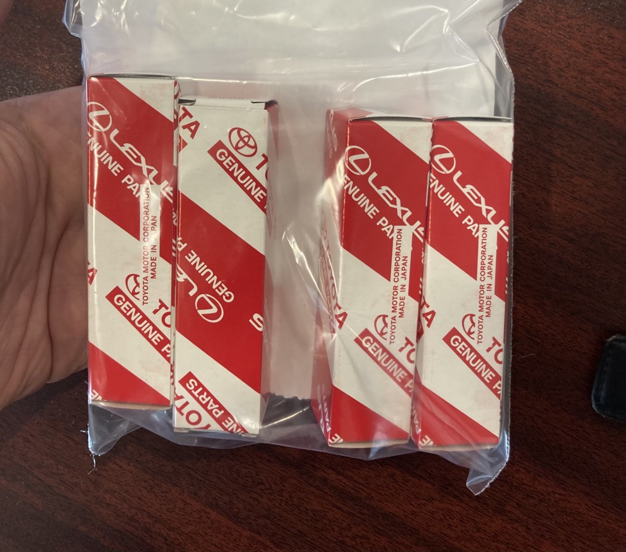

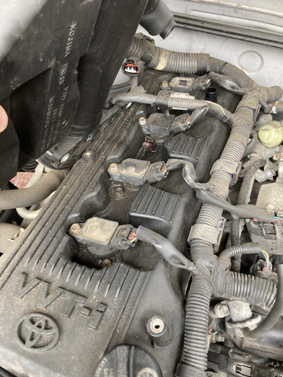

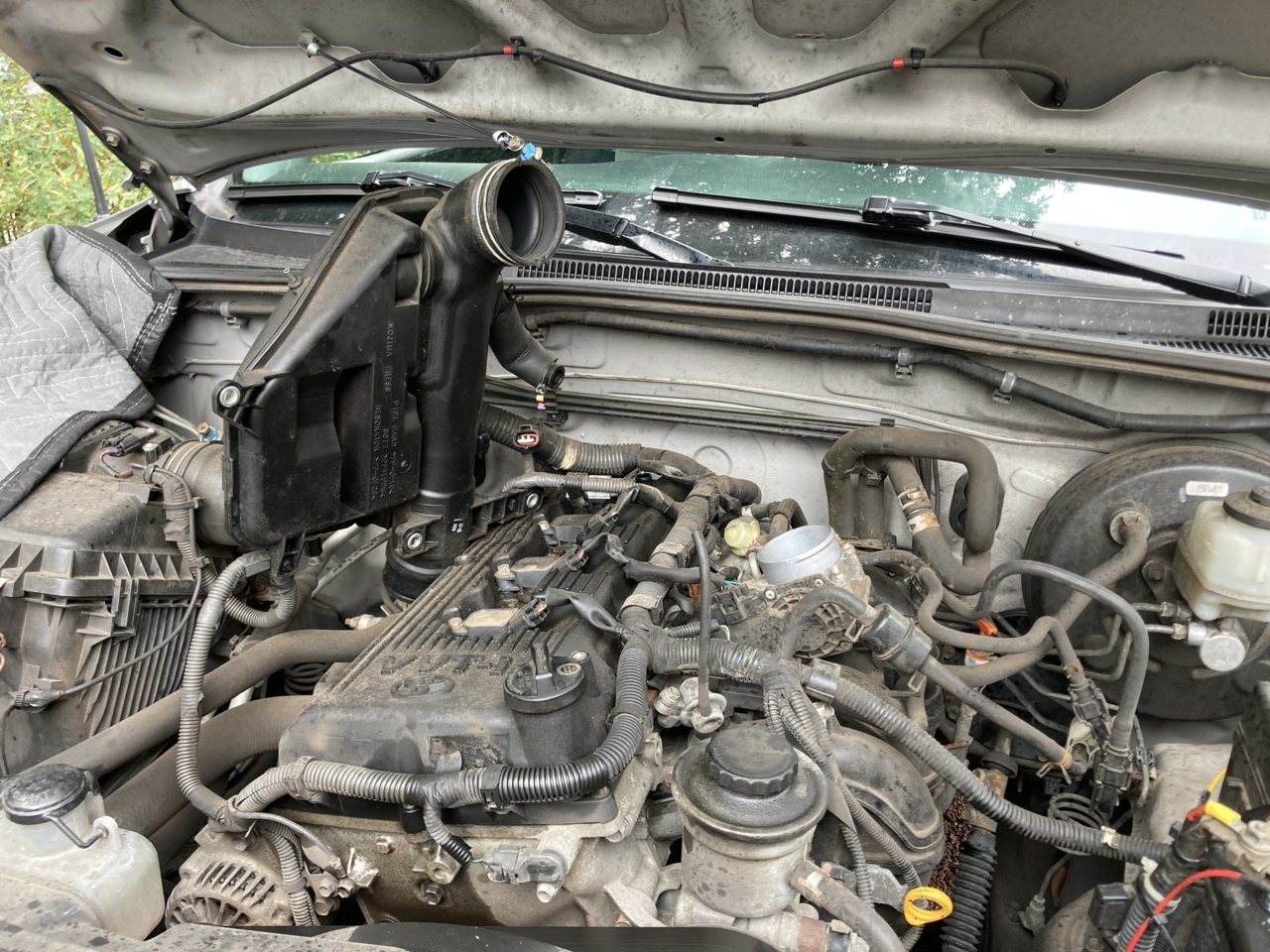

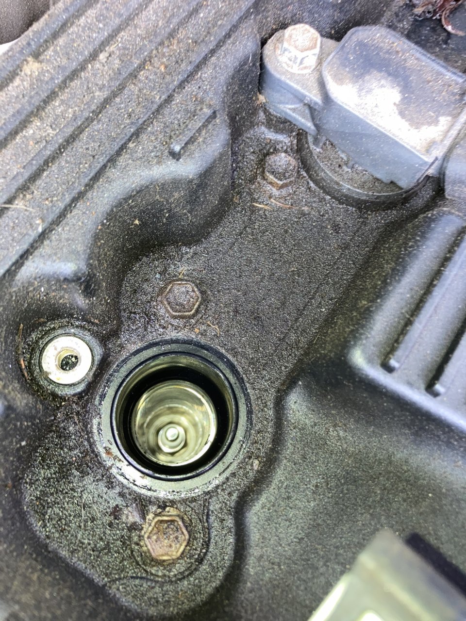

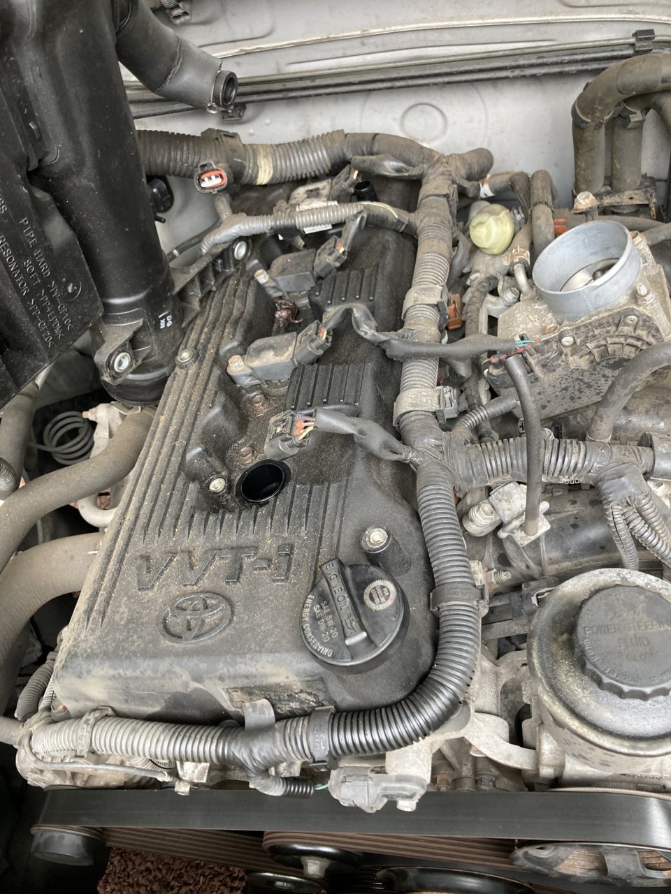

    Spark plugs are good in terms of no oil in the combustion chamber, but we decided to replace them anyway since we have it taken apart...
    B21678BD-E09E-47D5-9845-E9C8E71A1ECC.jpg DFE80DB7-E789-4D47-915C-1F6E76FE0D3B.jpg A9AC93C8-AD8E-4B86-B683-335BA279F6A9.jpg

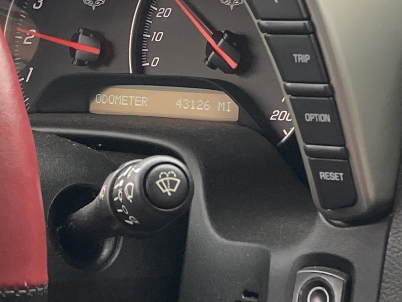

    Took the Corvette to get the spark plugs from the dealer...
    B53871E5-8DF1-4138-961E-B61D6EF9BAD0.jpg 1F29B4A9-AE91-4EAE-9D7E-4D3F570DFB2C.jpg 47787087-D2EF-4A62-8331-89A0B499BAD3.jpg

    It's a 2005 with only 43K miles!

    New spark plugs!

    I think the valve cover gasket might need replaced. Looks like some oil is getting by

    That was my fault; No oil seepage...

    Nice work on the plugs! Glad they’re dry, that’s a good sign.
