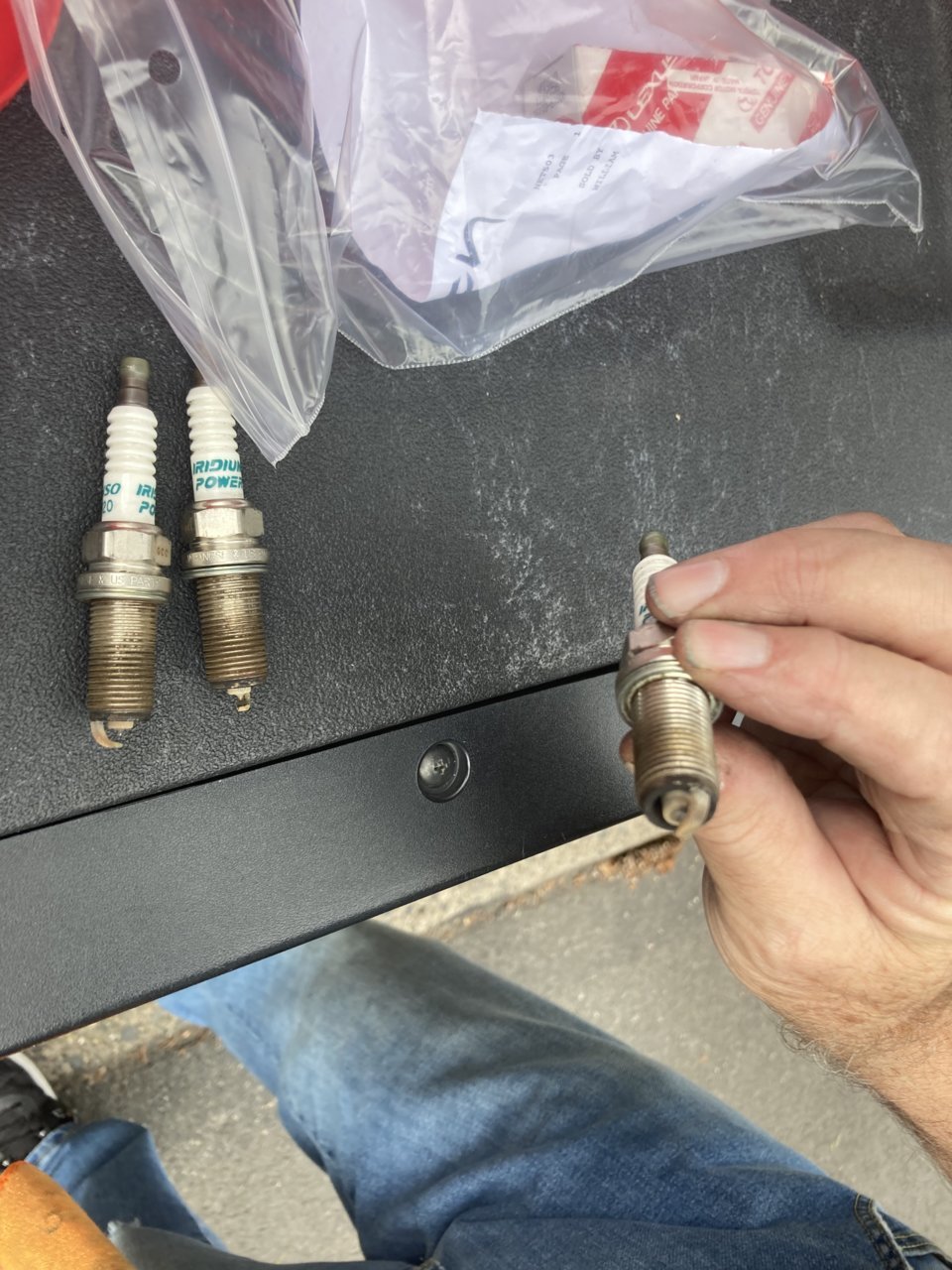

    Three out of four look good, and there is no evidence that any oil is leaking...

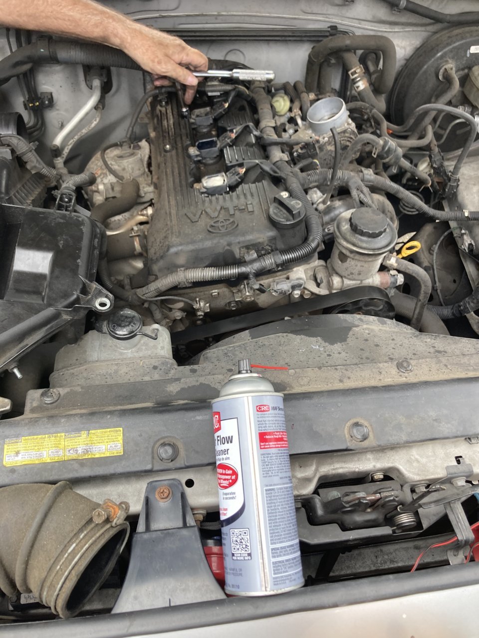

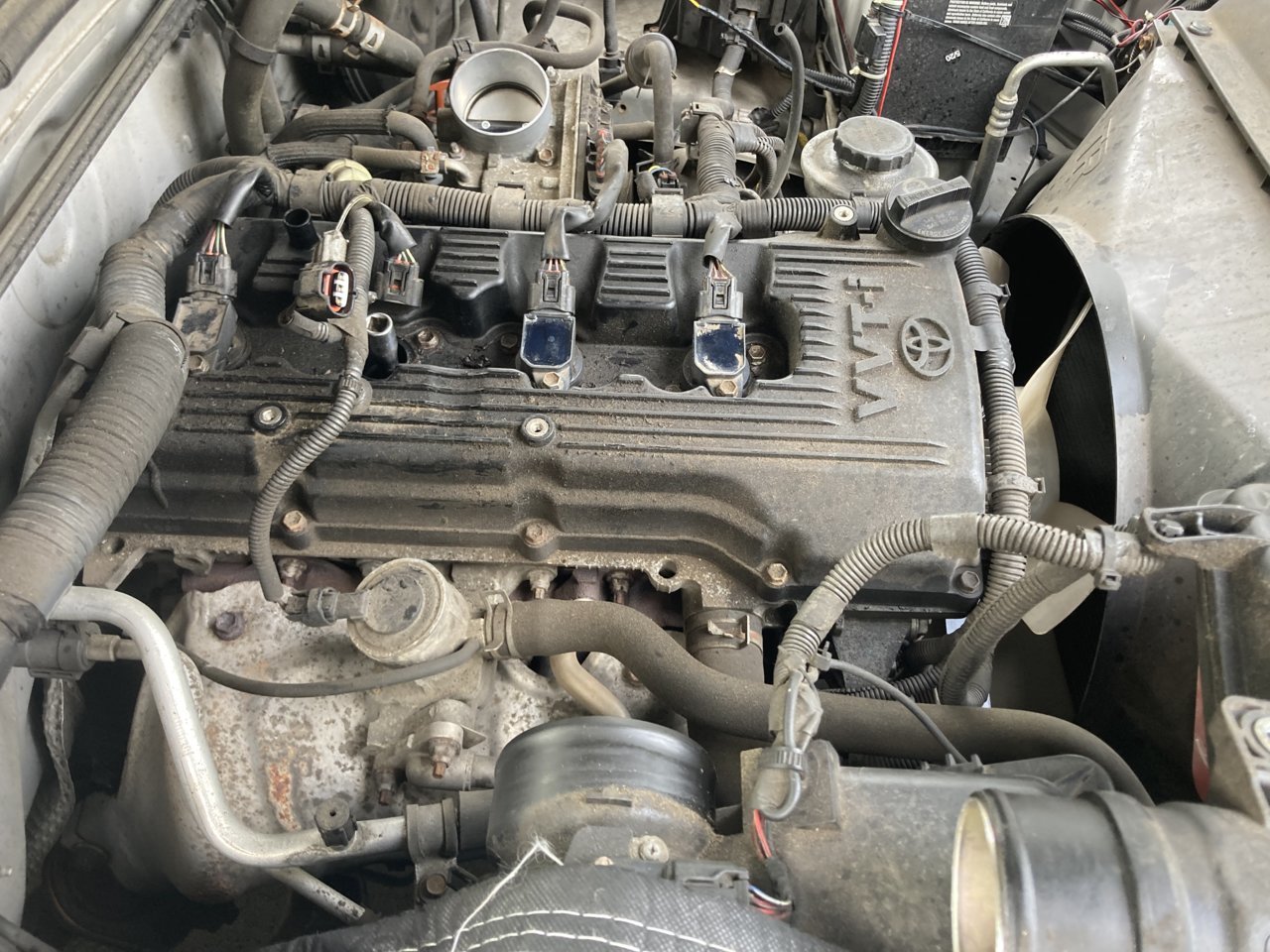

    Here's the PCV valve, I think...

    It is possible to a plug-well o-ring or 2 that is compromised....causing a bit of oil to get into the combustion chambers

    USA
    Certainly couldn't hurt. An OEM is only $10 or so and 5 minutes work

    Its on the back of the valve cover under that big wire loom

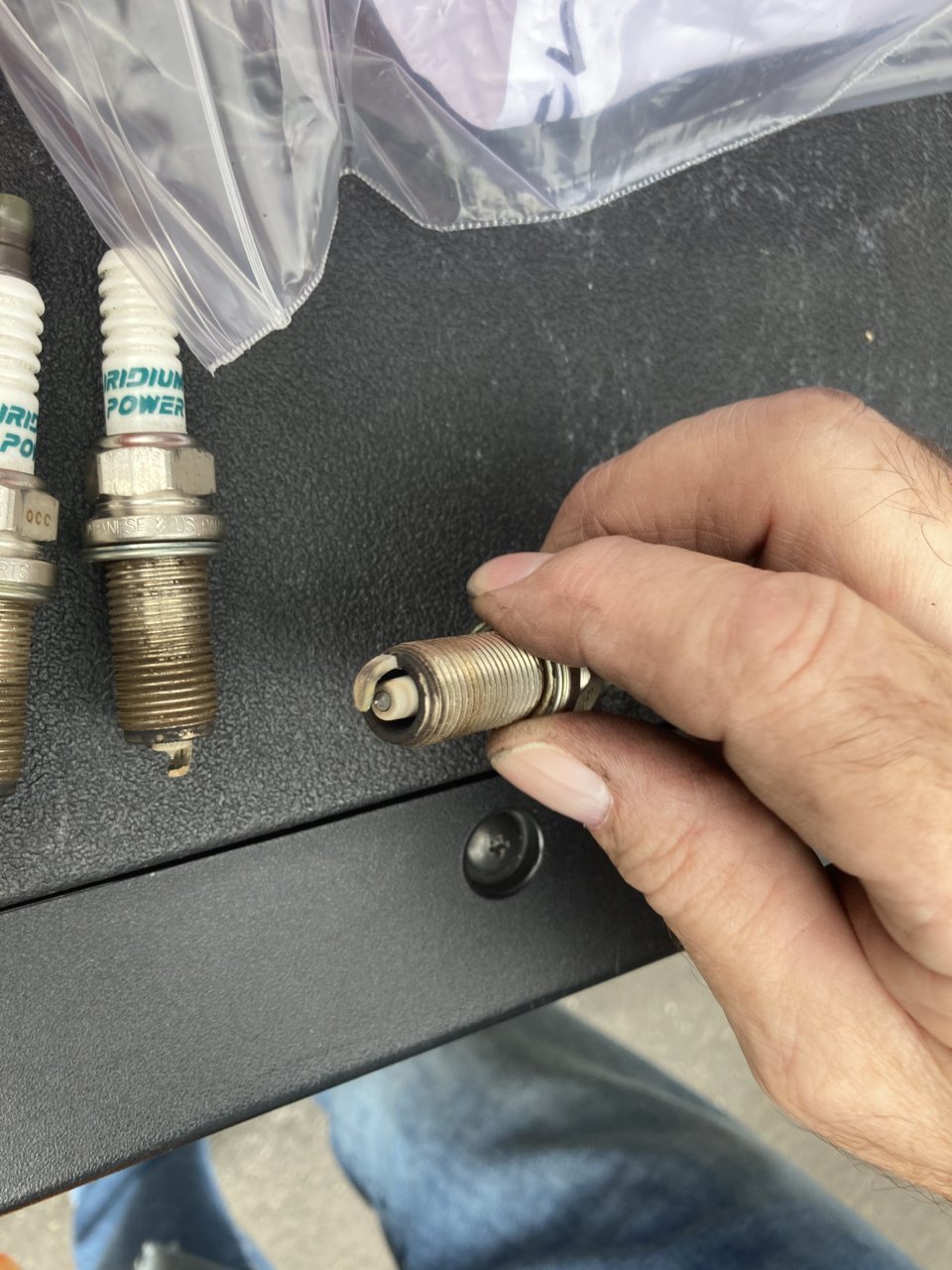

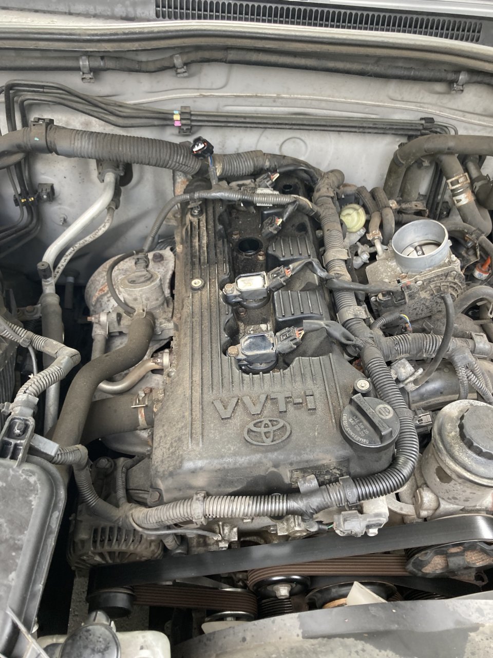

    We were thinking #4 was cross threaded due to the difficulty in getting it out, but that didn't end up being the case...
    49A4B6C9-7AC4-4330-A0F0-974001025B98.jpg 1C733BFB-D870-481C-A3B0-048BA7BFCD3B.jpg

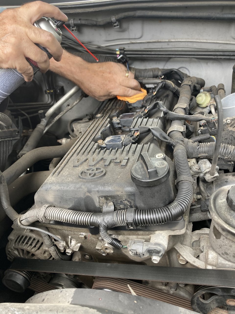

    Should be sticking out of the back of the cover right about here. Just move the wire loom and you should see it. 19F6C8DA-32AD-4838-9733-DC29988F7689.jpg
