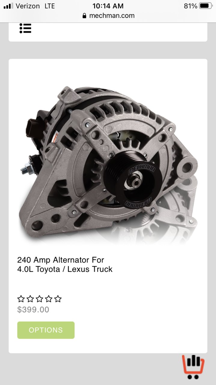

    Scratch that last part; Mechman does not presently make an alternator for the 2.7L (or anything but the 4.0L for that matter). :(

    And it sucks, because I would have paid that!

    The one I was looking at was 240 amps; Better to have the extra power and not need it than the other way around...

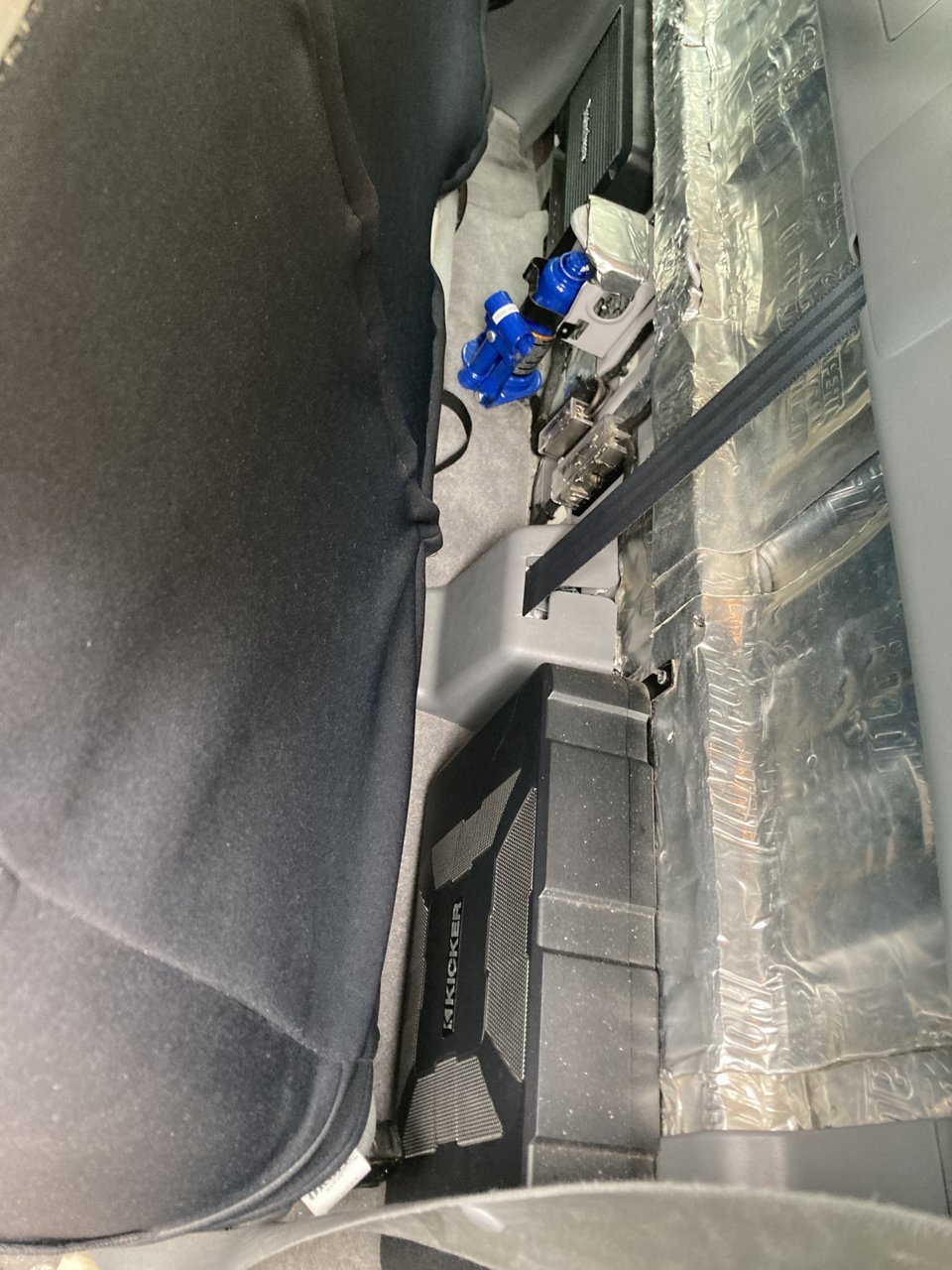

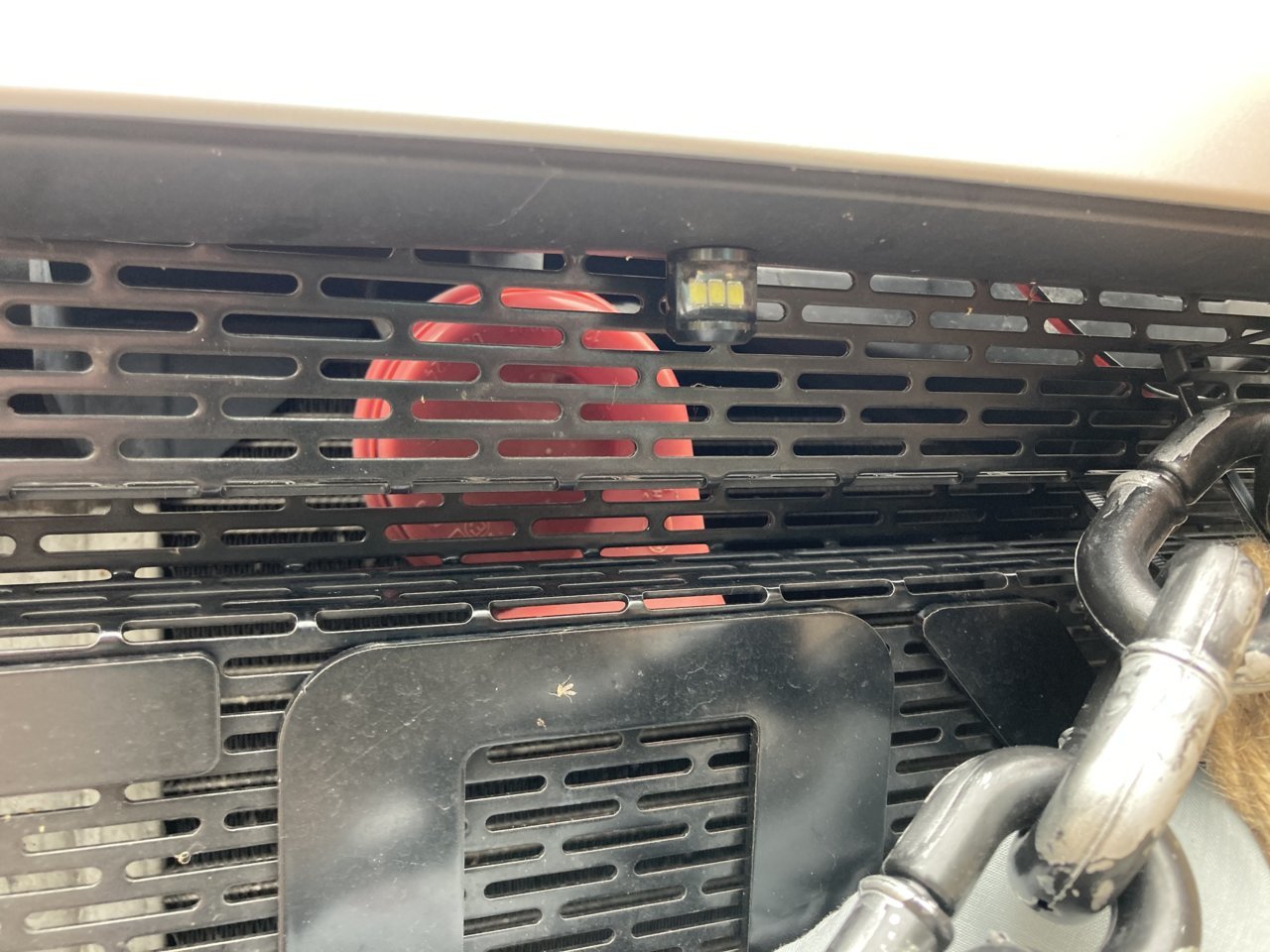

    I'm running an amp, a powered sub, foglights, and a HomerTaco grille with LEDs...

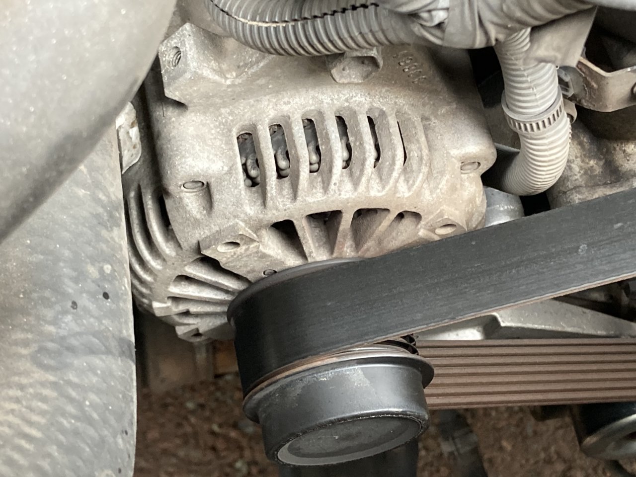

    Current alternator, which has served me well...
