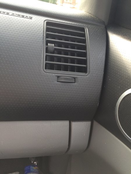

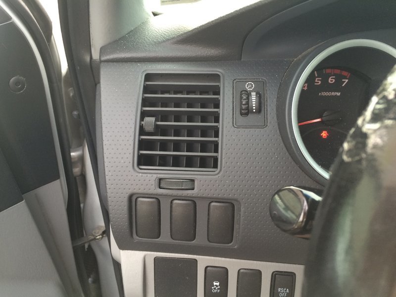

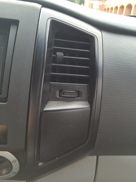

    This vent is ice cold:
    This one is as well:
    A/C set to MAX with recirc off:
    Kinda cool but not cold:
    Quite warm:

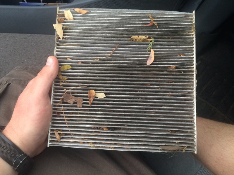

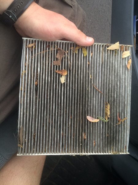

    Cabin air filter...

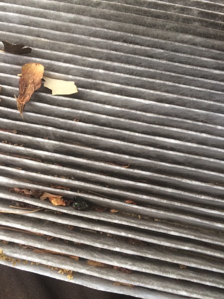

    As you can see, I need a new filter...
