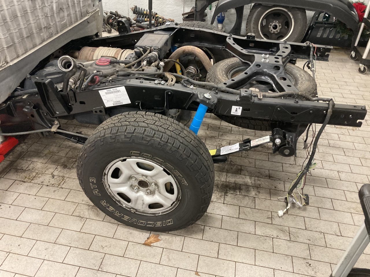

    The front Bilsteins that are likely not gonna get used...

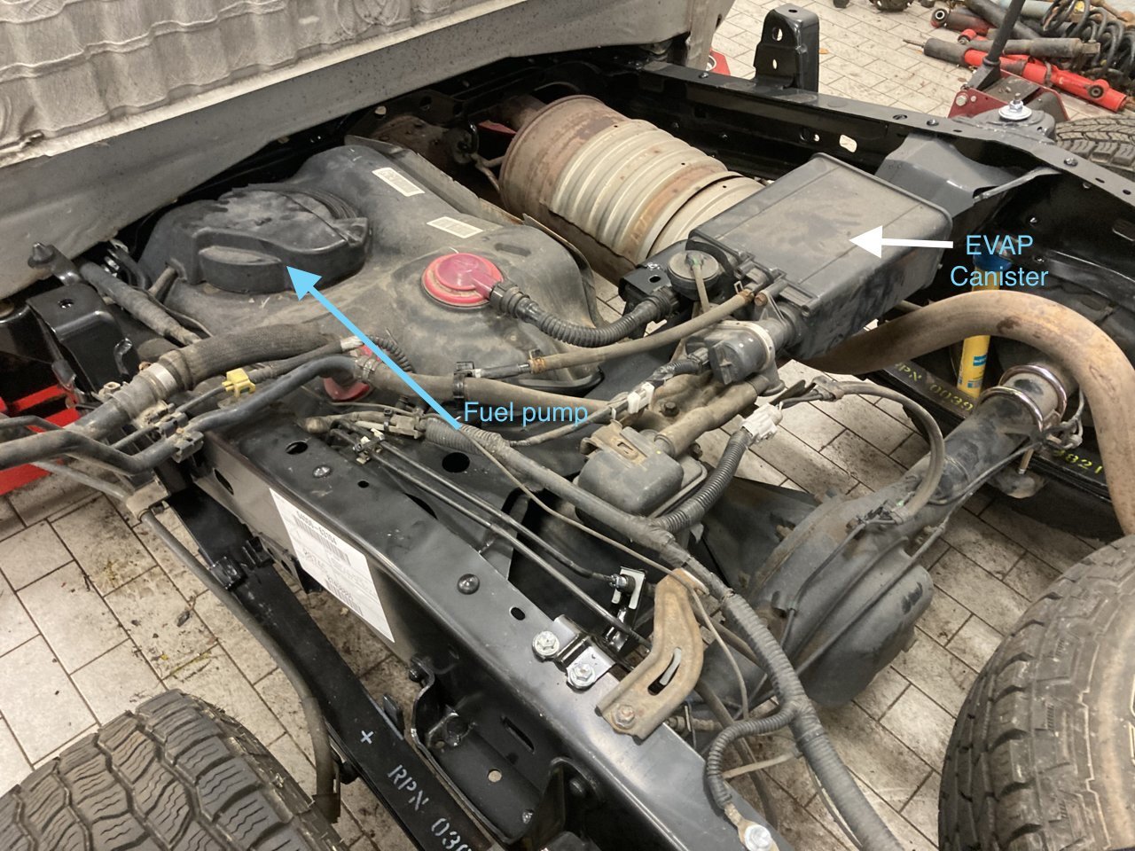

    Maybe this will help

    What the hell does an evap canister do?!?! I've seriously never heard of that part!

    Pollution
    In short, it stops raw fuel vapors from entering the atmosphere.
    But it is a much more complicated process. If you are ever lucky enough to get an EVAP code, I’ll let you explain how it works exactly.
    Until then, I’m :fingerscrossed: I don’t ever have to deal with it.

    Emissions control item to catch fuel vapors from escaping into the atmosphere

    Uhhh, why is the yellow marked leaf spring on the right?
    Yellow always goes to the gas tank side.
    PennSilverTaco[OP] likes this.

    Nice catch. That’s why it is awesome to have techs on here. :thumbsup:

    I've never done a axle over spring, but tundra 4x4 and taco 4x4 are always yellow gas tank side.
