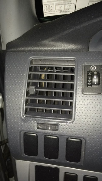

    These two A/C vents crank out cold air and will literally numb your fingers (Note condensation forming on lower corners of far left vent; It was almost 80°F and VERY humid when I took these pictures, and I had the driver's door open)…

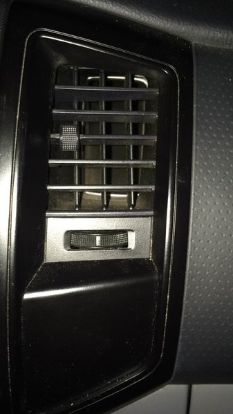

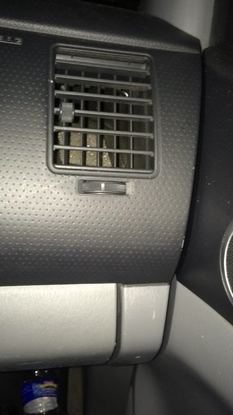

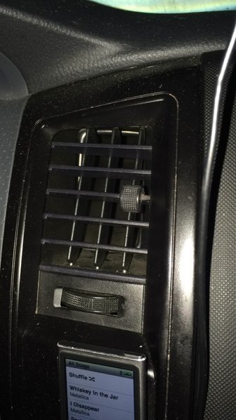

    The right side vents, which don't seem to be working very well at the moment...

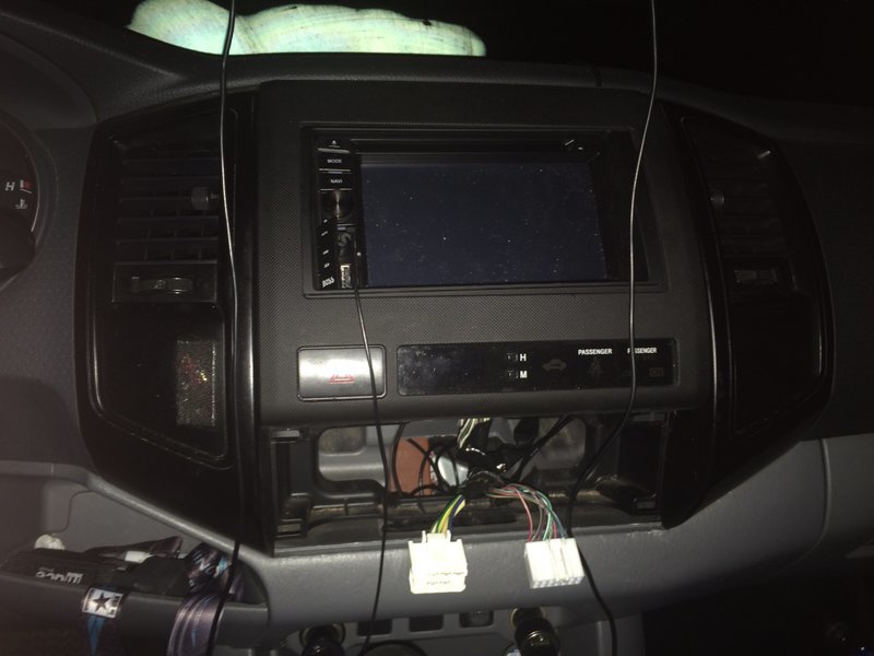

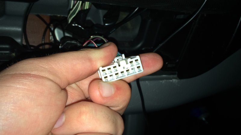

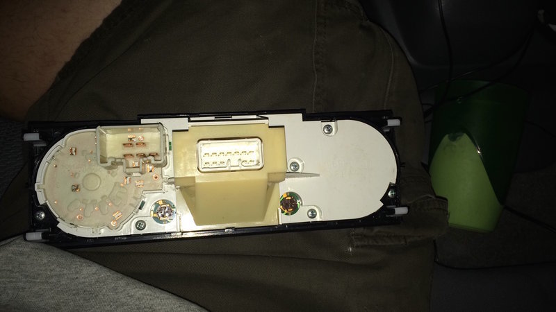

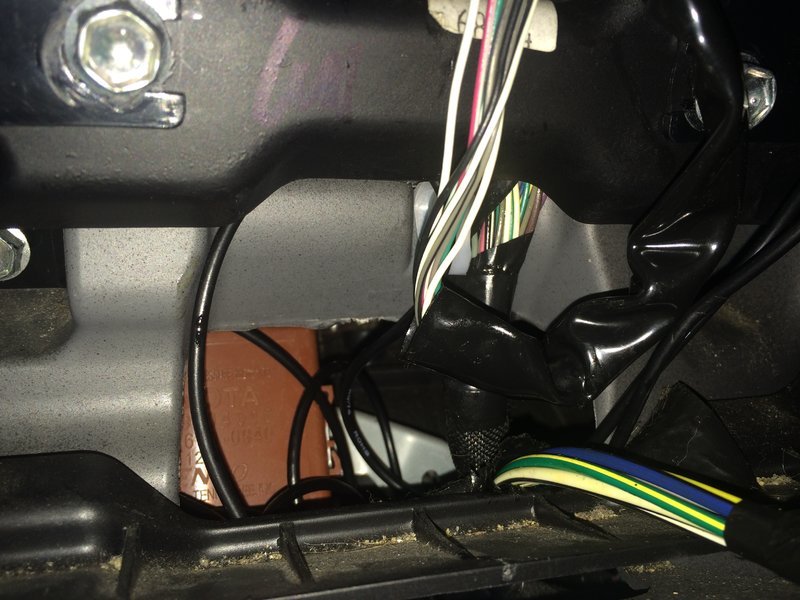

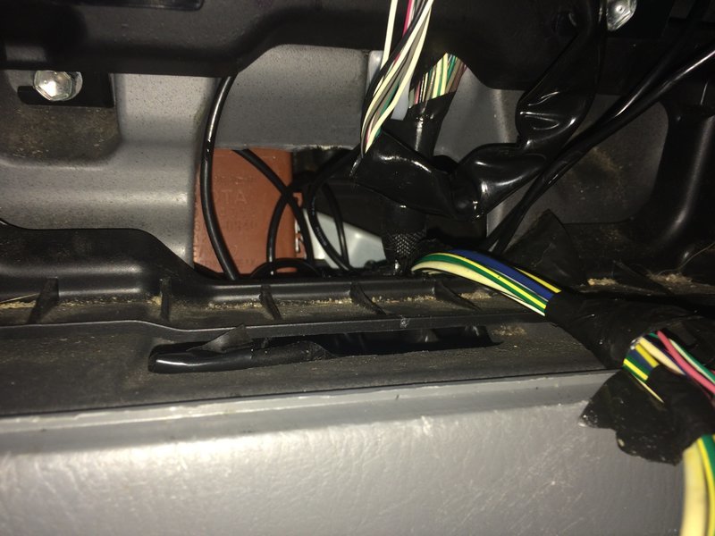

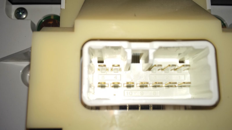

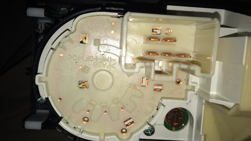

    I disconnected and reconnected the HVAC controls twice in attempt to "reset" it, and also closely inspected all connections and wires. Everything looks fine...
    IMG_8219.jpg IMG_8222.jpg IMG_8223.jpg IMG_8213.jpg IMG_8215.jpg IMG_8216.jpg IMG_8217.jpg IMG_8218.jpg

    The AC system is obviously working as it puts out cold air that will numb your fingers. There is no flap that would isolate the passenger side and the drivers side...
    Blockage I will agree with, but exactly what is blocking the flow...
    Likely cause could in fact be the expansion valve or thermistor causing the evaporator to freeze partially hampering air flow. Have you noticed a difference in the actual amount of air flowing between the driver and passenger sides? Does it work well at first then after extended use start this uneven temperature...
    The expansion valve can be reached via under the hood firewall see image below:
    Here is the layout of the cooler behind the dash:

    Far right vent seems to be somewhat weaker but negligible. It's pretty consistently warm. Air will become marginally cooler if "recirc" is switched on. Can the air mix control servo motor be replaced as an individual part?

    Yes and it is fairly easy. Keep in mind that the Air Mix Servo is common to all of the air vents. It would effect all vents the same.
