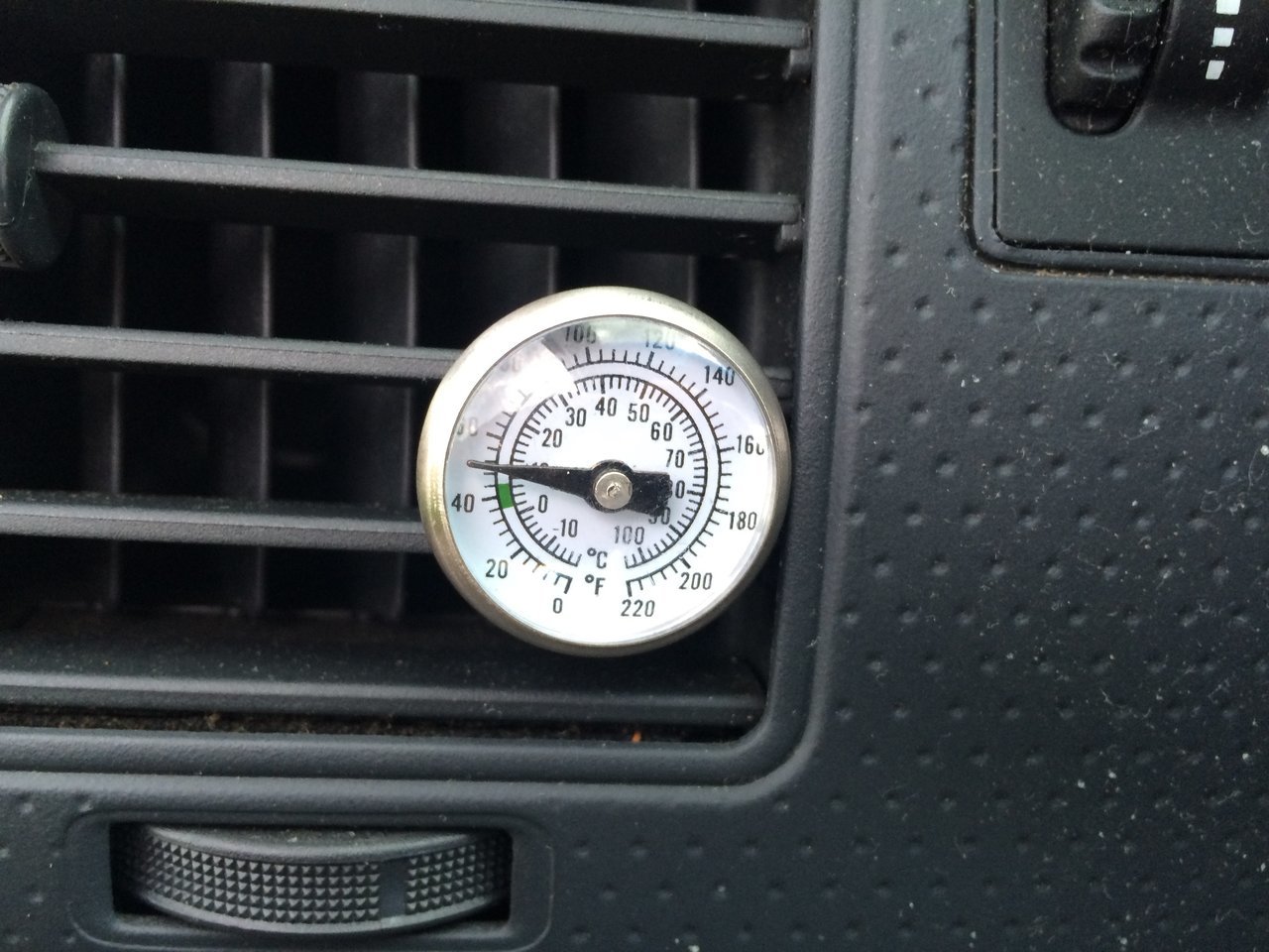

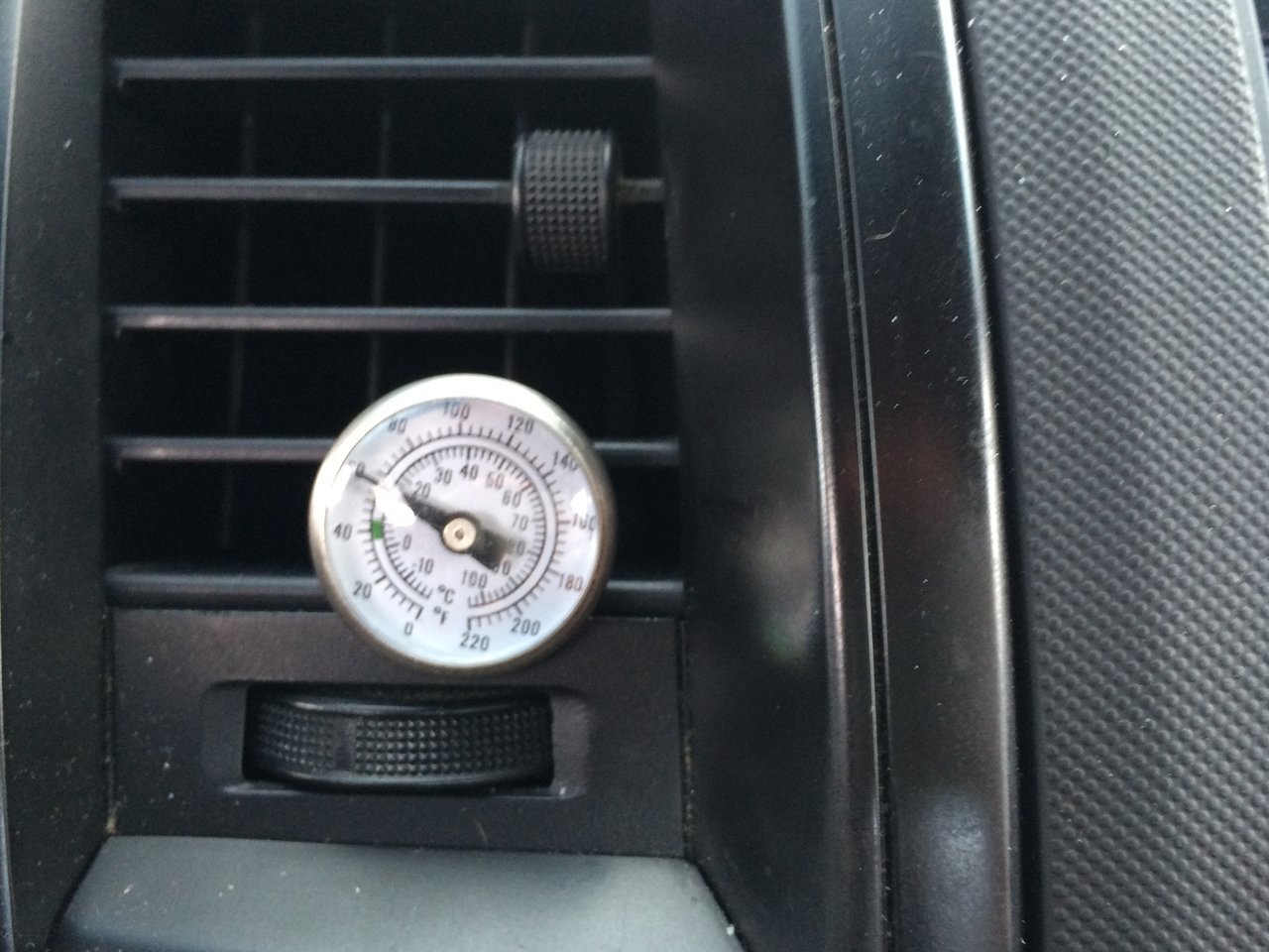

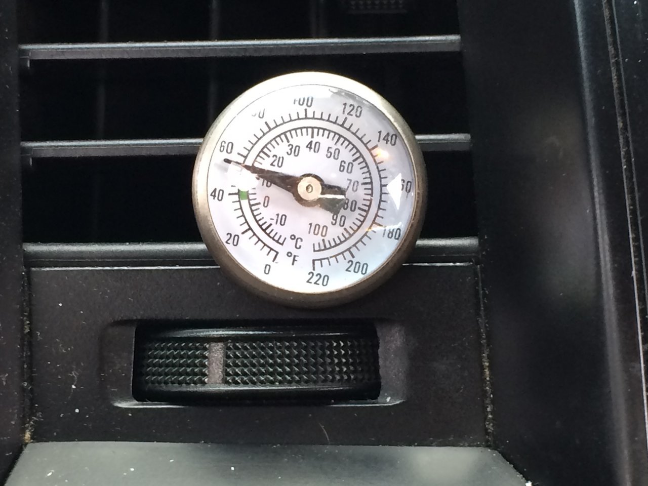

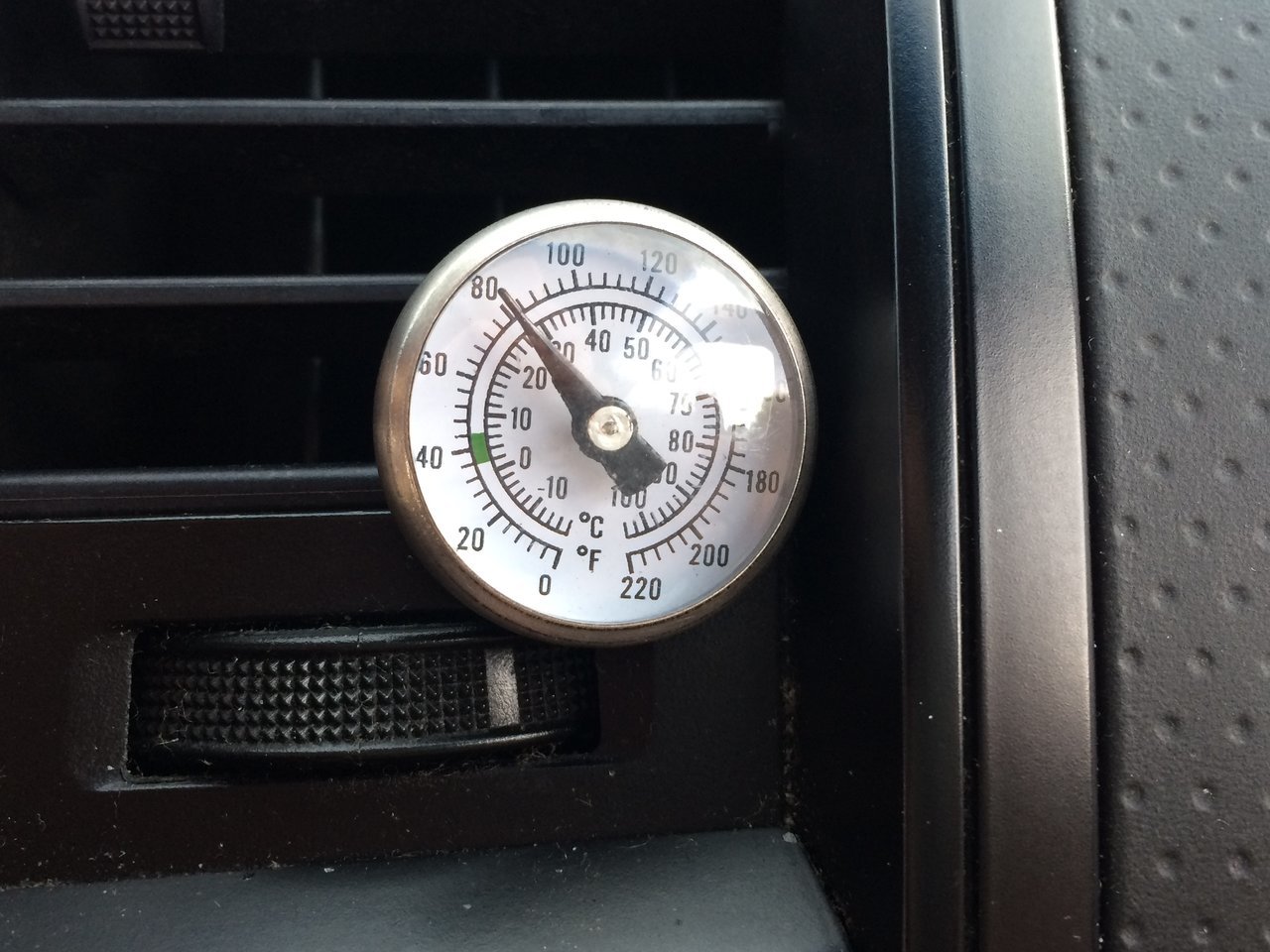

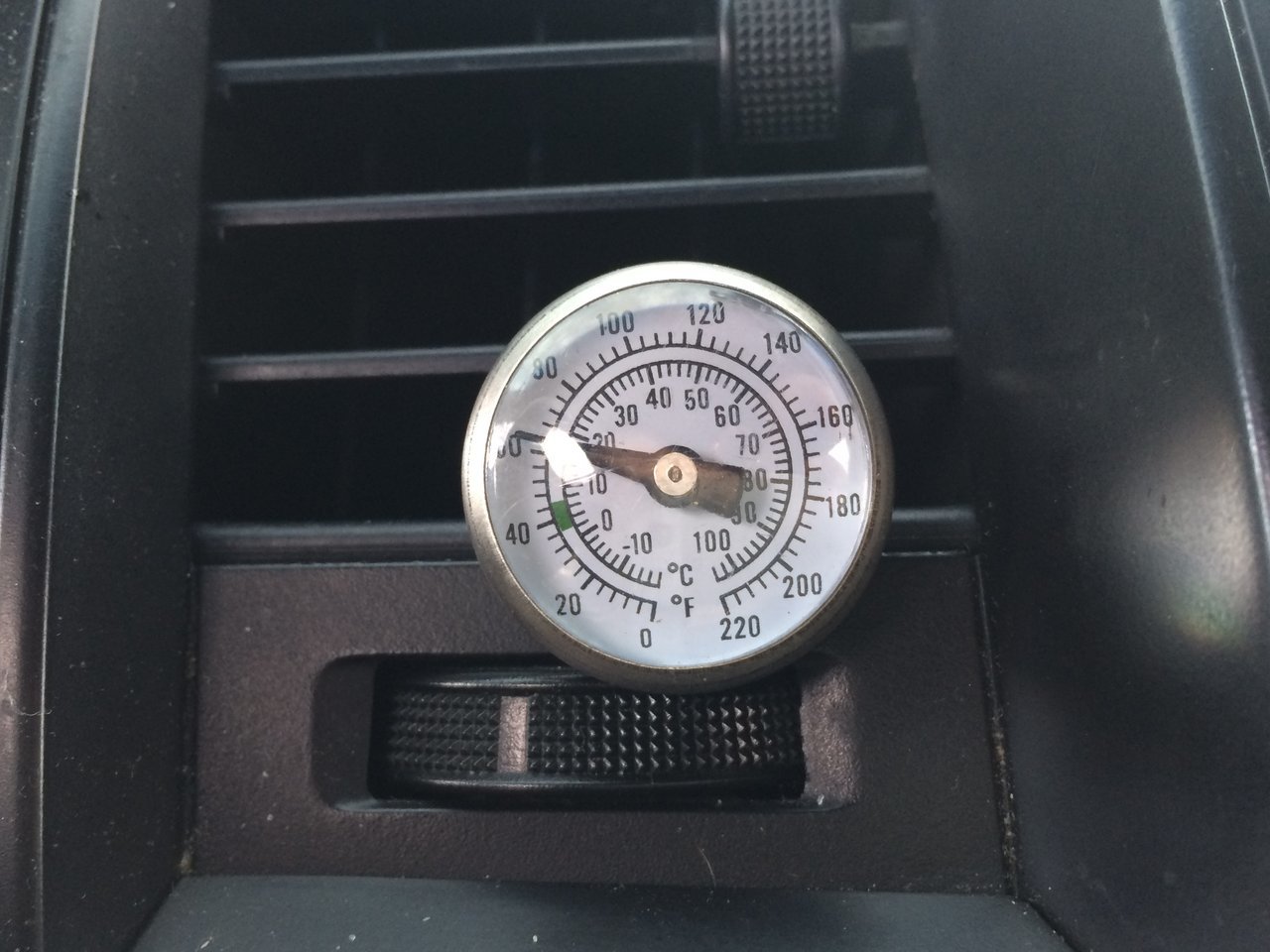

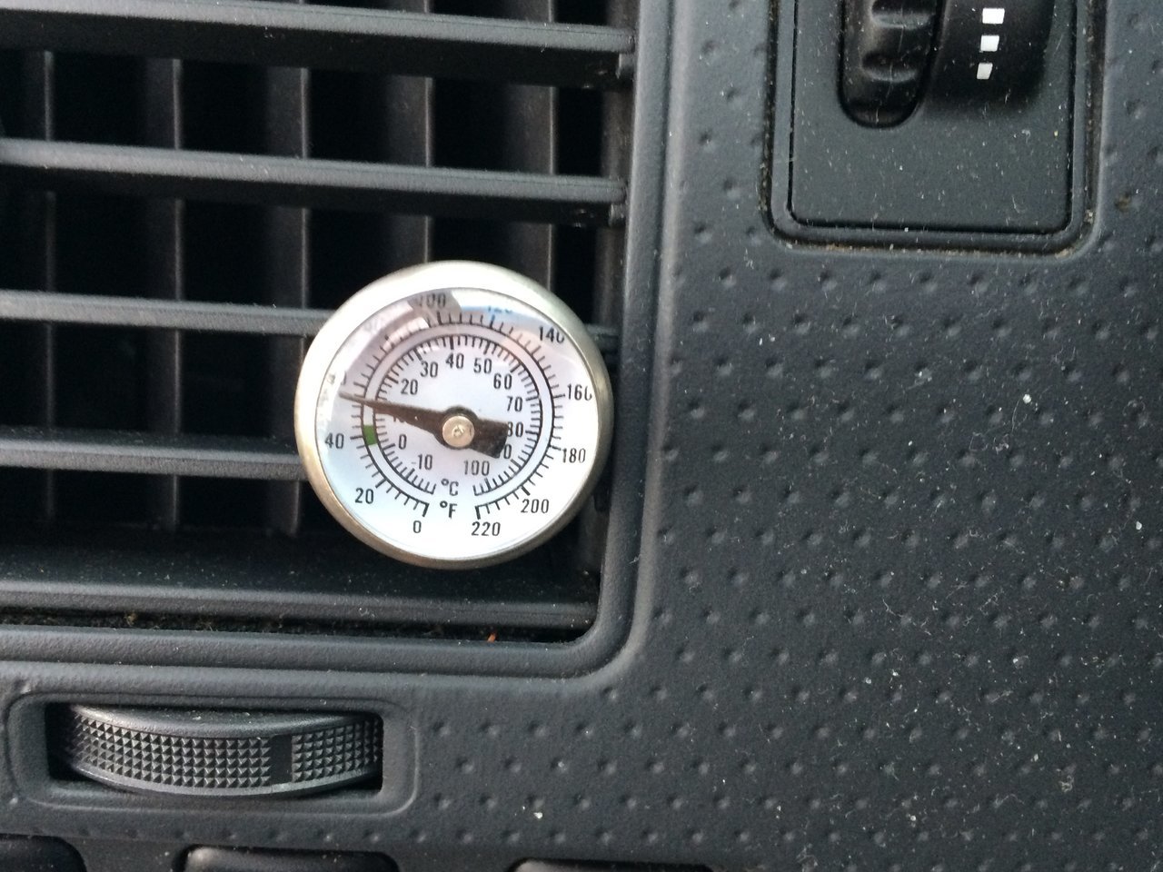

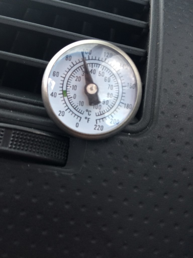

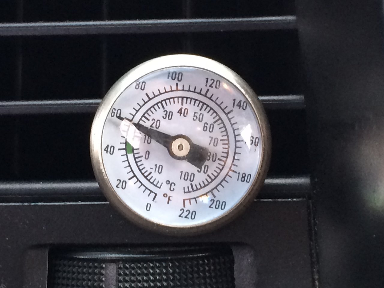

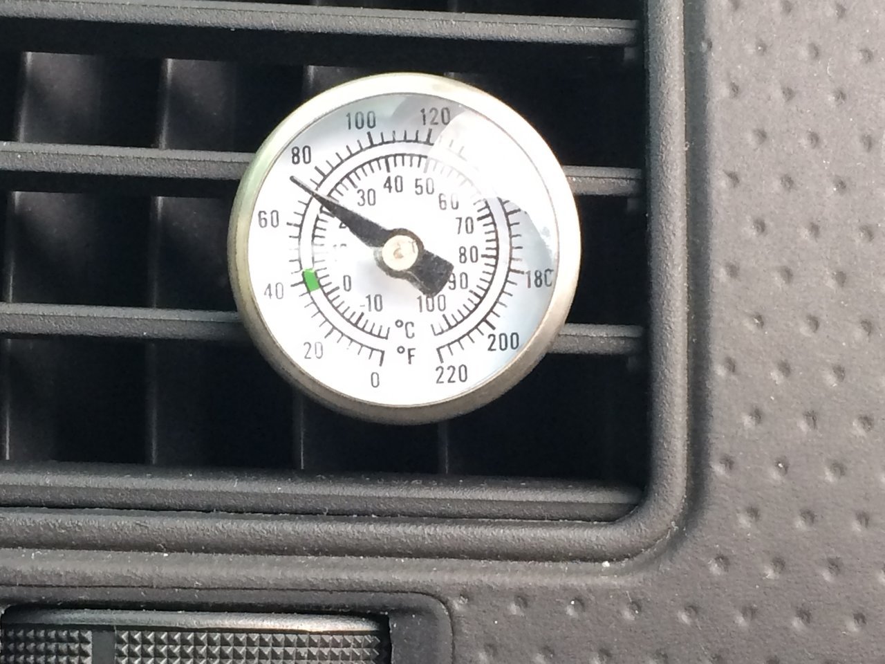

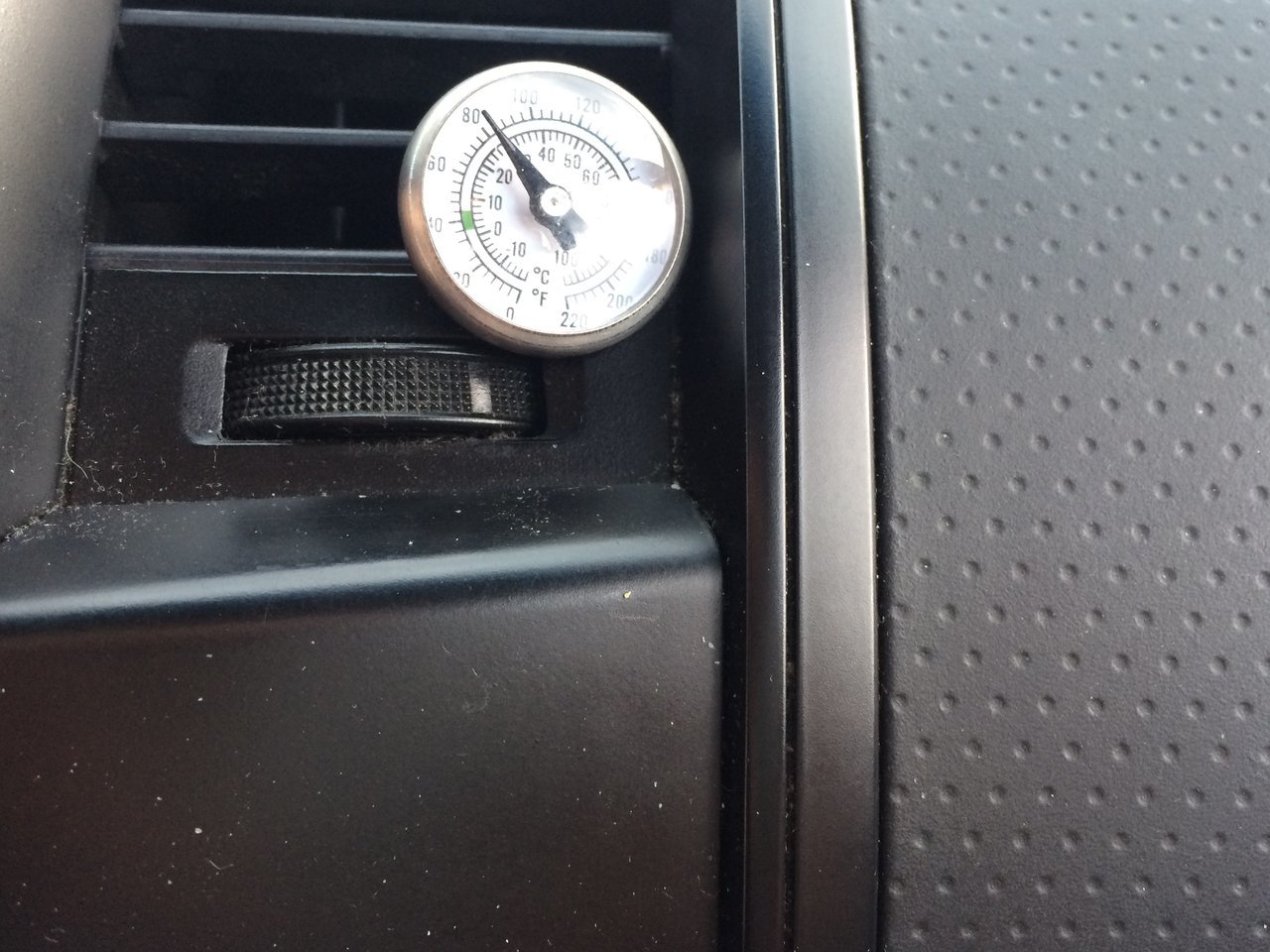

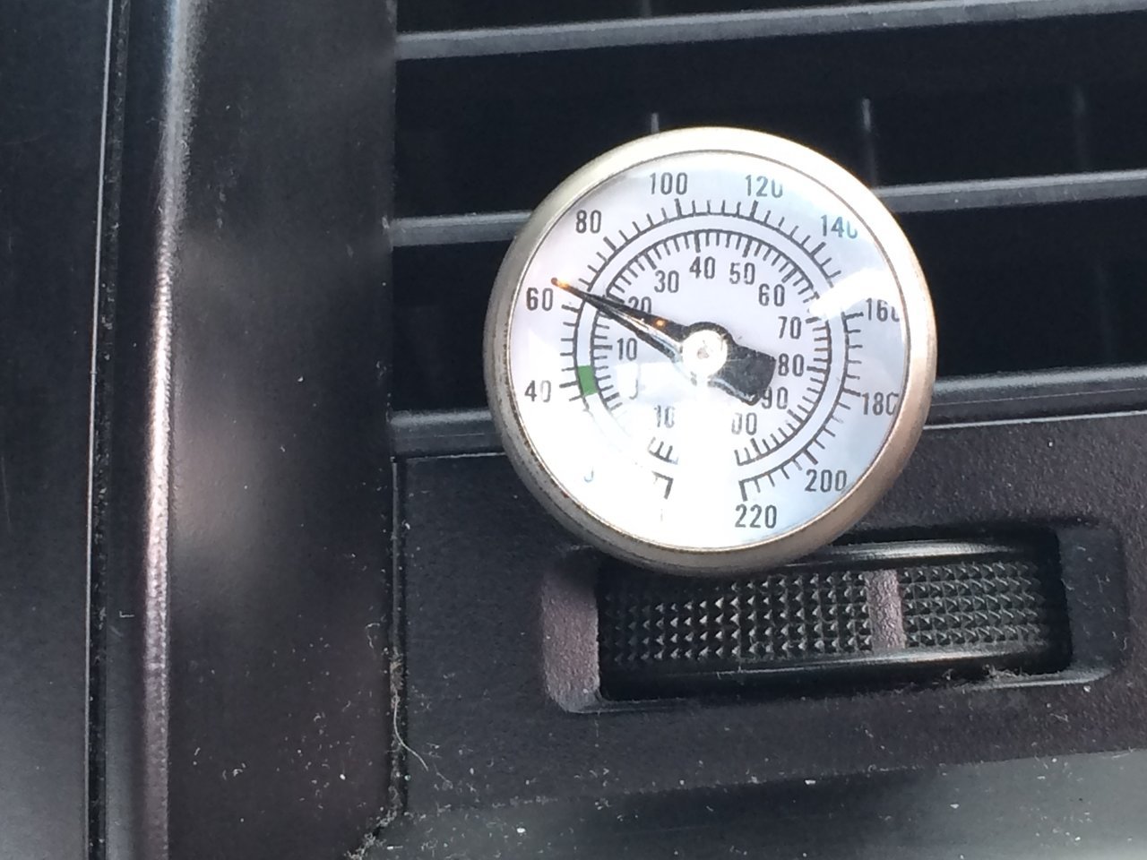

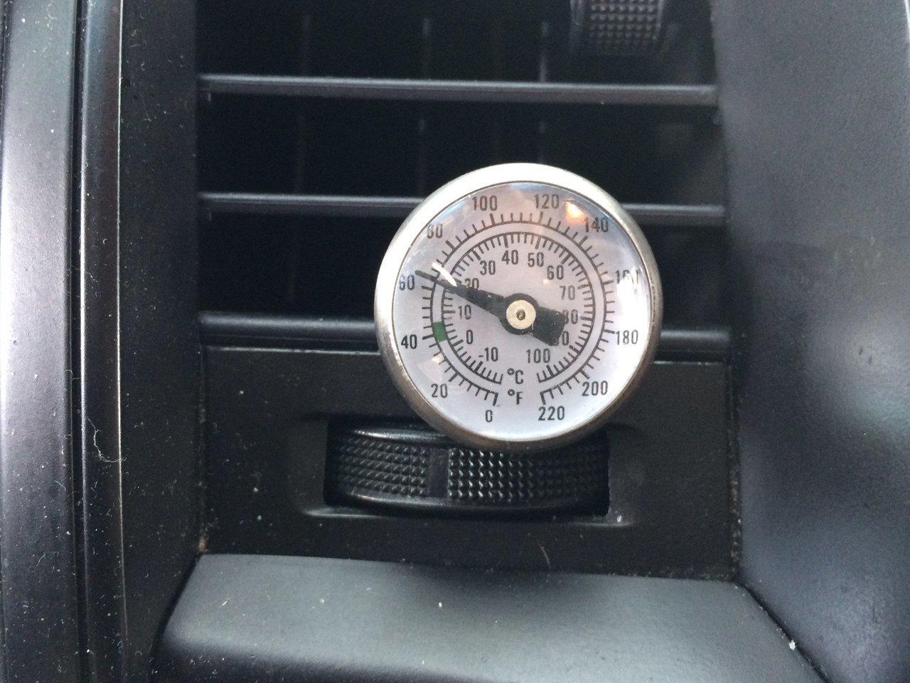

    I took some pictures of thermometer readings from the A/C vents in my truck...
    These were taken with the "recirc" ON:
    Inner left vent (In the 50s; Blowing cold but not ICE COLD; Last summer it was in the 40s)…
    Inner right vent (Blowing 65°F WITH THE RECIRC ON!)…
    Far right vent (Blowing 70°F with the recirc on; Outside temp was 84°F; Both left vents were in the mid-50s when this pic was taken)…
    Far left vent (The coldest vent; Blowing below 50°F while the vent at the other side of the truck was blowing 20°F warmer!)…
    With the "recirc" OFF:
    Inner left vent WITHOUT "recirc" on...
    Far left vent...
    Inner left vent again...
    Temp going up...
    Inner right vent...
    Far right vent (90°F; Again, recirc is off and vent on left side is putting out just over 60°F; Obviously something wrong here)…
    And my truck seems to be producing a lot of condensation as well...

    No really what do you think is wrong with it ?
  13. Jun 25, 2017 at 2:31 PM
    #4413
    PennSilverTaco
    PennSilverTaco [OP] Encyclopedia of useless information...
    Jul 15, 2014
    #134007
    72,797
    Charlie
    Central Bucks, Pennsylvania
    2010 Zombie Truck 2002 PT Cruiser
    Low on refrigerant and a slow leak somewhere. This part 3 in a series of posts. I've been told everything from a problem with the expansion valve or filter/drier, all the way up to a failing compressor. I'm bringing it to my mechanic tomorrow morning.

    Well your mechanic should be able to test your system (i.e. The system should have a certain charge to it now and they should be able to tell you that ) they should be able to fill it and put a dye into the system and see if it's leaking

    Yup! Dave is going to put the UV dye in it so if this happens again he should be able to find the leak.

    I just had mine redone but I never pushed a thermometer down each vent to check the temps ... it's freakin cold now thou and keeps me frosty cold

    I think mine was undercharged from the factory. It never has been satisfactorily cold to me. Doesn't seem to have gotten any worse either though.

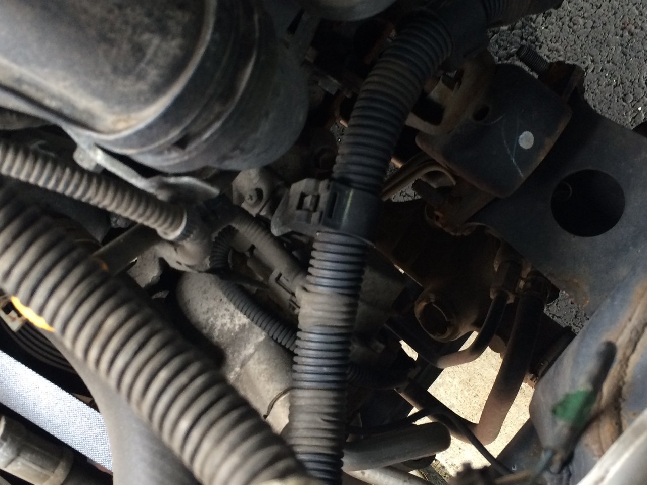

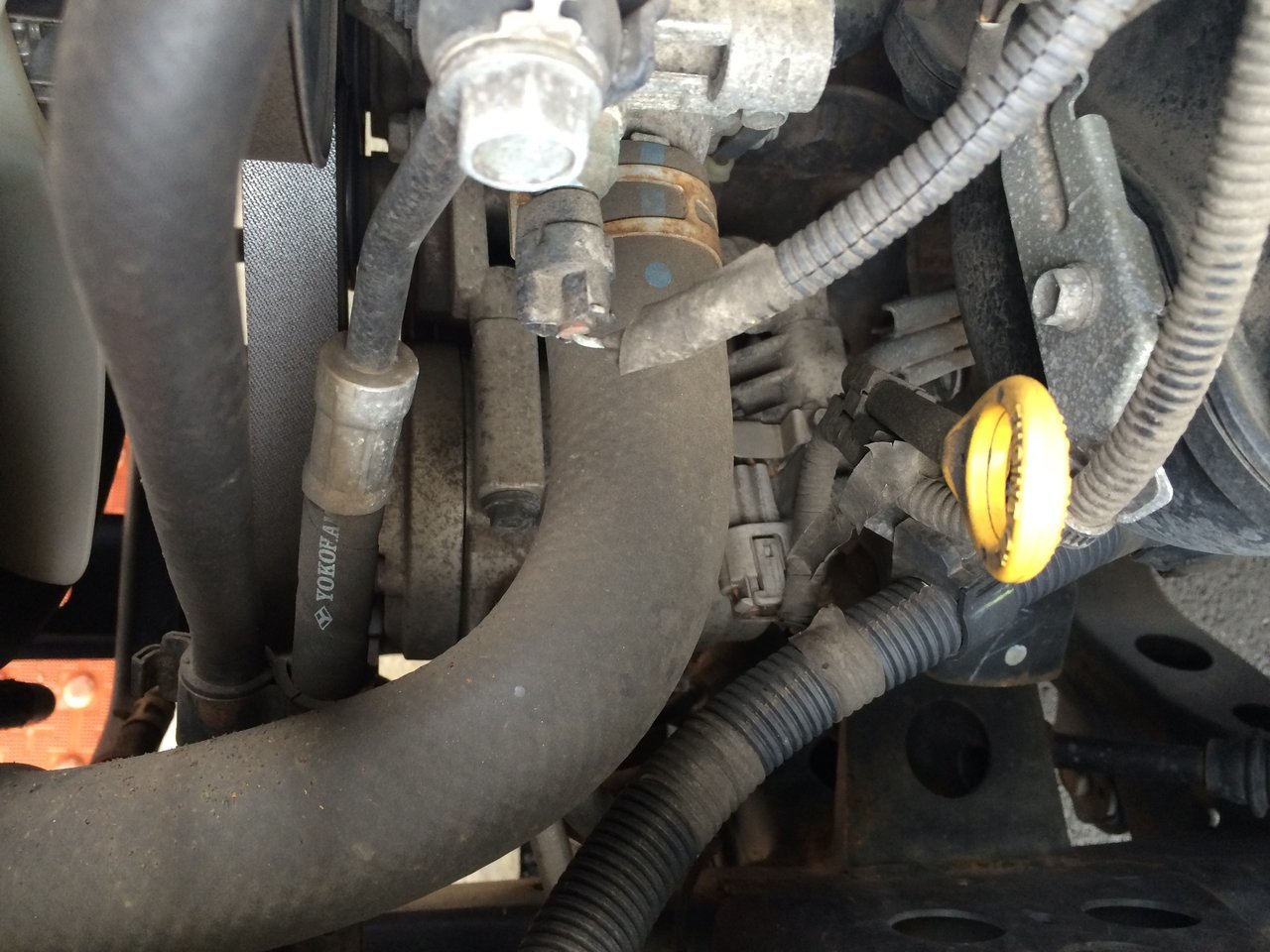

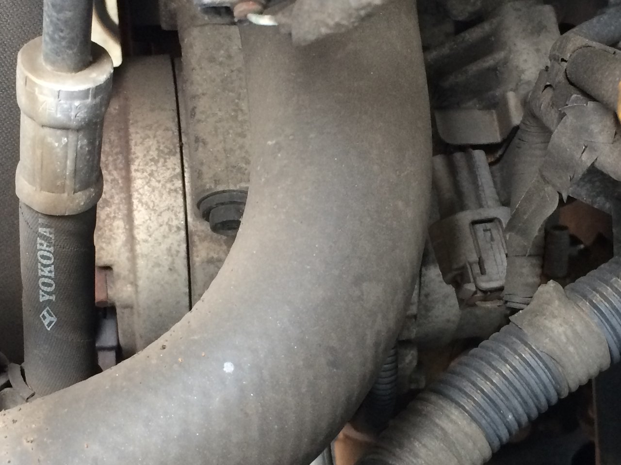

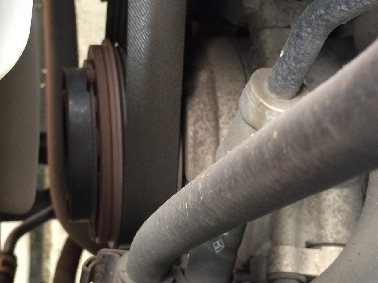

    How does my compressor look in your opinion? These pictures were taken a few days ago:
  20. Jun 25, 2017 at 2:46 PM
    #4420
    PennSilverTaco
    Jul 15, 2014
    #134007
    72,797
    Charlie
    My mechanic, Dave, is quite good at maximizing the performance of air-conditioners in vehicles. I don't know how familiar you are with Chevrolet Astro and GMC Safari vans, but one noteworthy problem with these vans is that A/C underperforms. Dave was able to get the A/C in a customer's 1994 Astro van with front and rear A/C (1994 was the first year for R134a refrigerant in these vans) blowing ice cold. The trick he says is to "balance" the refrigerant.
