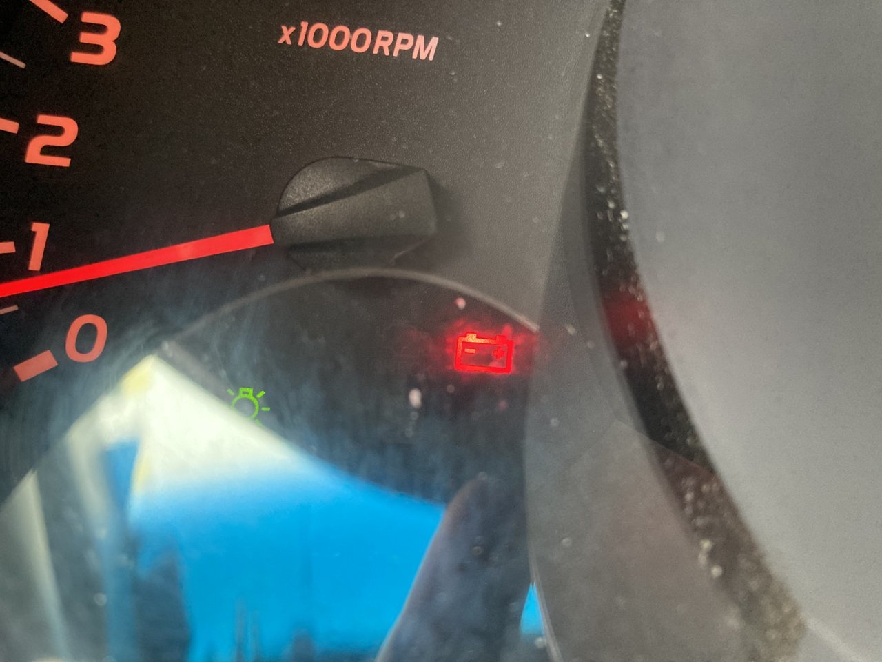

    I was doing DoorDash and my radio started acting weird (it had power but no sound; Works now); A short time later, my battery light came on...
    The kicker is that the battery light only comes on while the truck is stationary. The battery is only a little over a year old, but the truck has 142K miles and the alternator is original. This issue was random and spontaneous, just manifesting itself today...

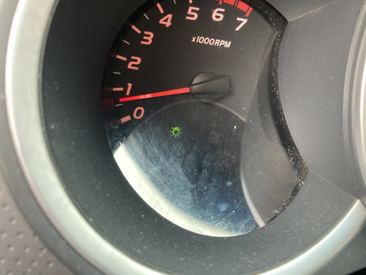

    The battery light only seems to be on when the headlights are on...
    :notsure:

    Probably right on the ragged edge of making enough voltage to trigger the light. It puts out the least at idle which is why it comes on when stopped. Check it with a multimeter and see what its putting out.

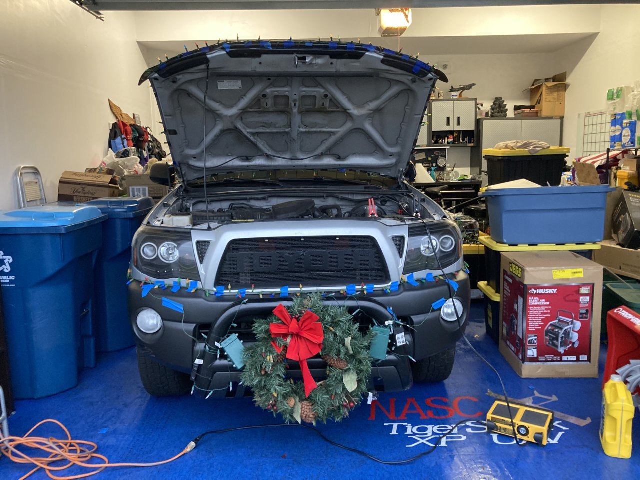

    My weekend, and my alternator, are totally fucked! My neighbor let me borrow his trickle charger, so I can keep the battery from going totally flat and I can actually drive it to Pete's on Monday; We have bad storm coming in and the charger can't be left outside for obvious reasons, so that's why my truck is in the garage...

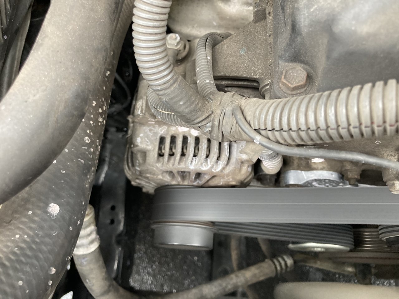

    Good news; My friend Dave is an ASE certified mechanic (now he drives an 18-wheeler for a living but he still wrenches on his own vehicles), and he's gonna help me swap out the alternator tomorrow in exchange for some money and a case of Guinness!

    Diagnosis so you don’t have to remove it. I can see it on my end.
