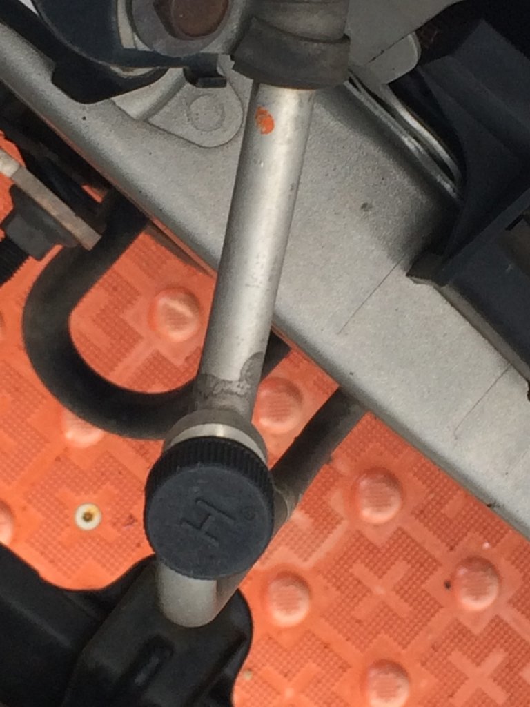

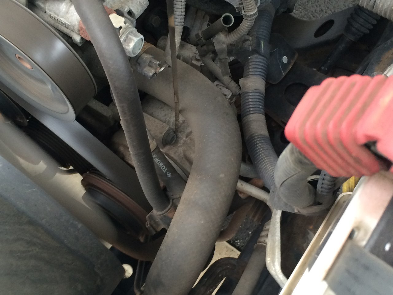

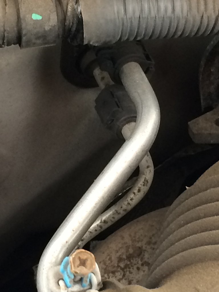

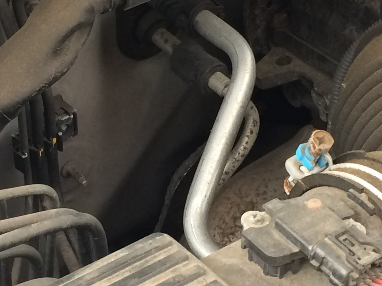

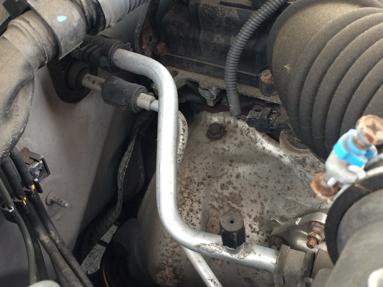

    Here are some pics of various underhood parts of my A/C system...

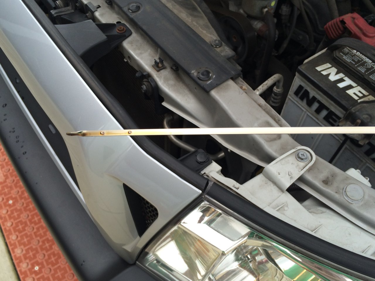

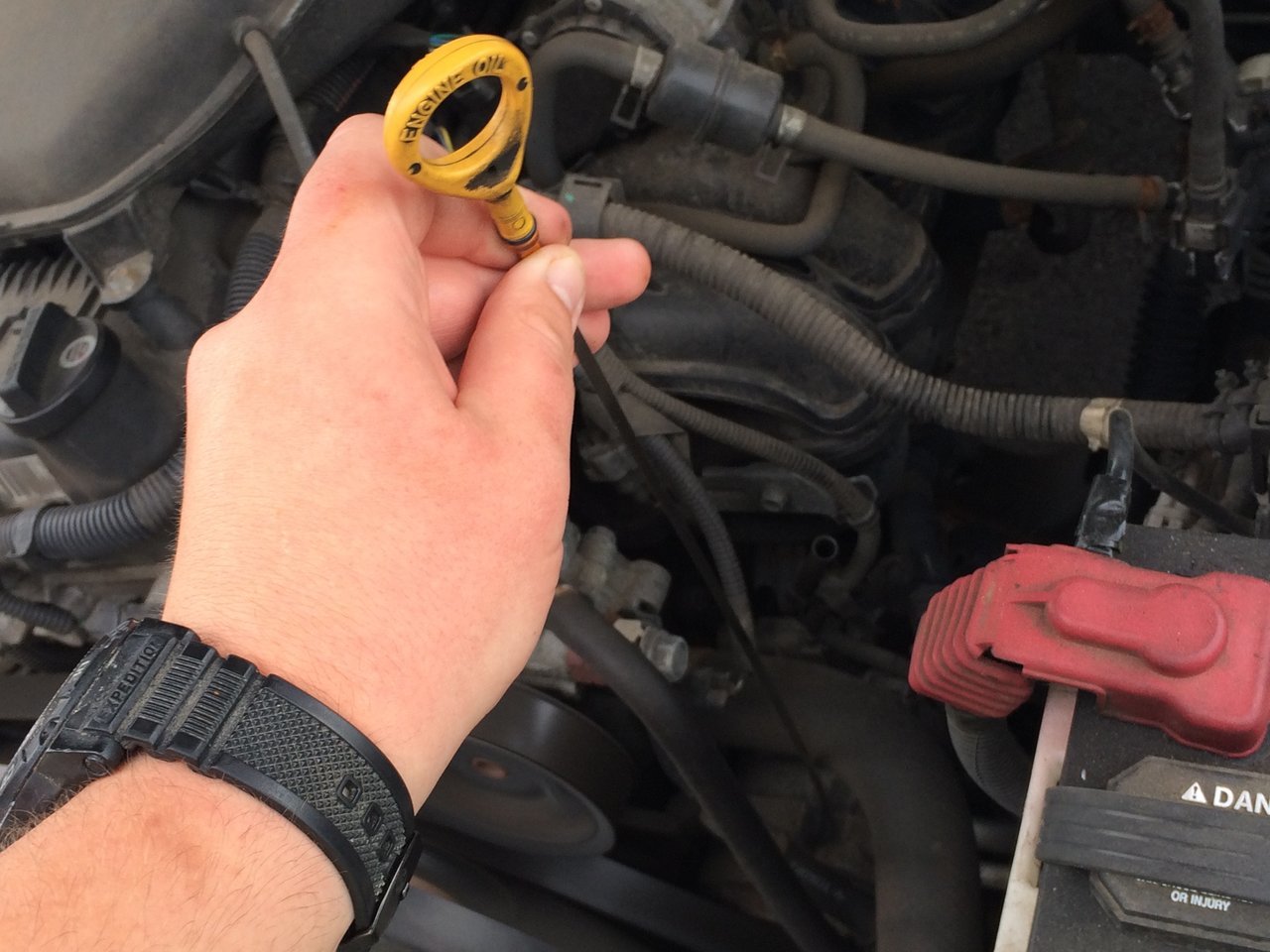

    My friend who has owned Rolls-Royces and Bentleys his whole life told me about this simple way to listen to your A/C compressor and see if it is in good working condition...
    I'm sure lots of people on TW have heard of this method before, but I'm just putting it out there for those who haven't...
    You simply use the dipstick like a stethoscope. If the compressor seems to be shaking or making weird noises, it's probably on it's way out. If all it does is vibrate the dipstick like mine did, it's probably fine!

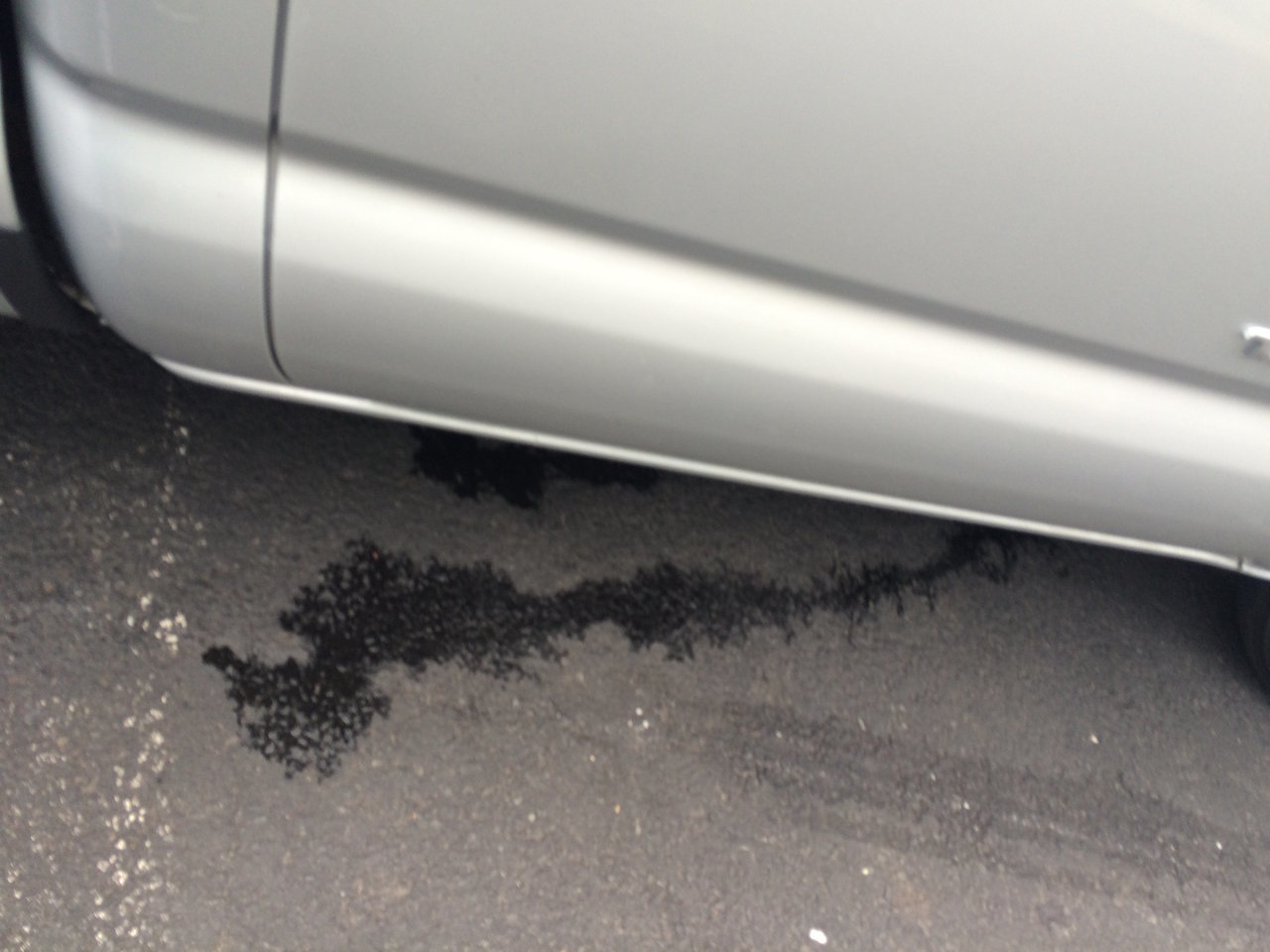

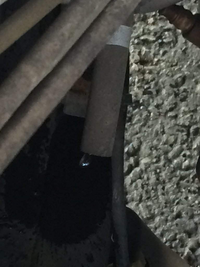

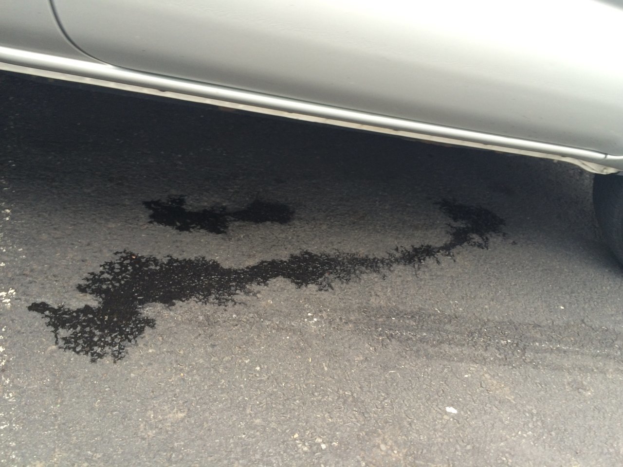

    My truck is currently having problems with the A/C, and I think it needs to be charged. I'm bringing it to my mechanic tomorrow. Please see my other threads with regards to that.
    I'm wondering if this excess condensation is related to whatever else may be wrong?

    For a nearly 8 year old truck, that's really not too bad

    If the charge is low the vaporization point of the refrigerant drops to or near 0° C, this causes water vapor in the air to freeze and build-up on the evaporator coils-when the AC compressor is shut down, either by AC controls sensing the low temp or when you turn off the engine, the build-up melts and produces a larger than normal amount of condensation...
    Topping off the charge (and fixing any leaks of course) should fix it up...

    If the outside air is humid, that's exactly what will happen. Your air conditioner removes moisture from the air. When there is excessive moisture in the air, it will drain out of the evap and leak. The higher the humidity, the more it will leak. Every system does this and it's perfectly normal.

    It's 54% humidity in "Bucks county, PA" right now lol. Yes, every AC system in your area will be doing this right now.

    Probably could have mentioned that in the beginning.
    The condensation has nothing to do with your problem though. It's perfectly normal. Good luck.
