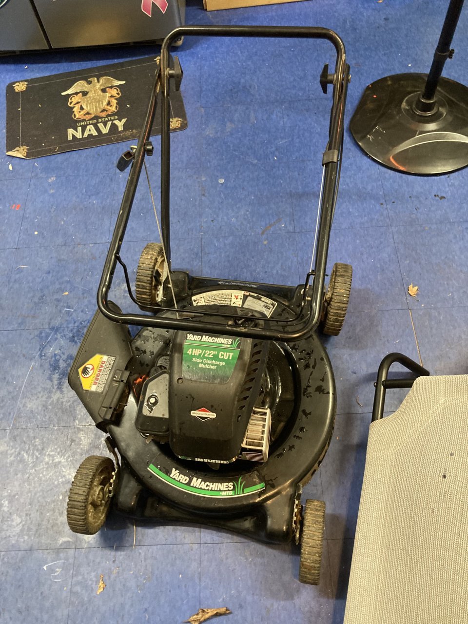

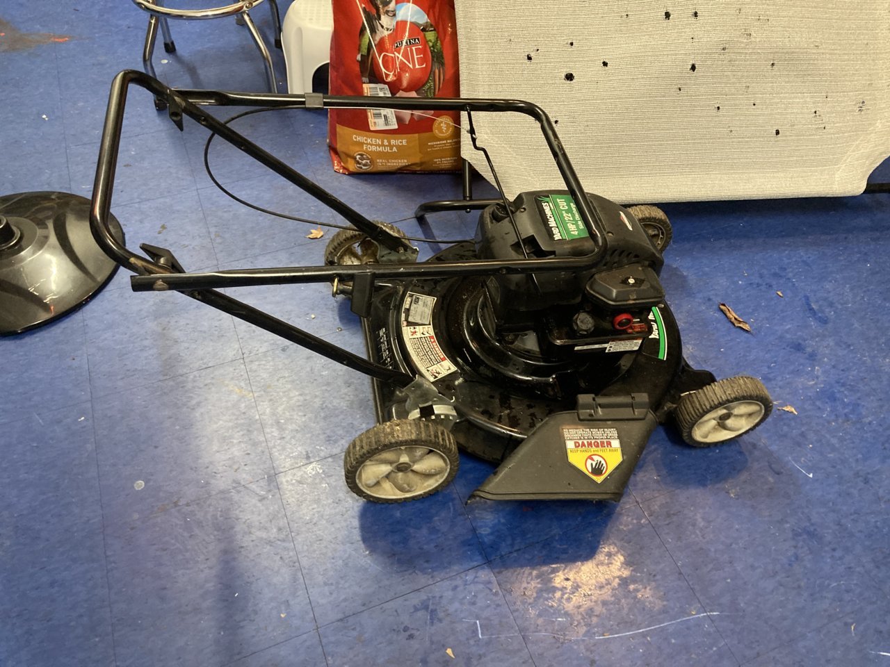

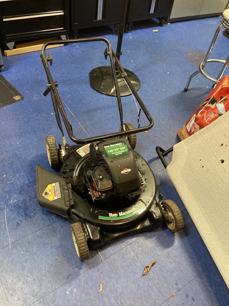

    Gwyn's son acquired this lawnmower and a leaf blower for free, with the intention of getting them running and selling them for a profit; The lawnmower appeared to be in good condition and almost new, and the story I got was that it was left outside for a long time and got rained on...
    Gwyn's son and his friend could not get it started and gave up; After looking more closely at this mower, it appear that it has not been very well taken care of, so I'm just gonna scrap it tomorrow...

    I attempted to tear down the lawnmower but didn't get very far, only getting the handlebars and two wheels off; I knew there was gas in it, but not as much as there ended up being, and when I turned the mower on its side to make the teardown easier I made a mess in the garage. My dad was not happy about this and I aborted the mission after cleaning up...

    The underside of the mower was absolutely caked with clumps of grass (will post pictures tomorrow)...

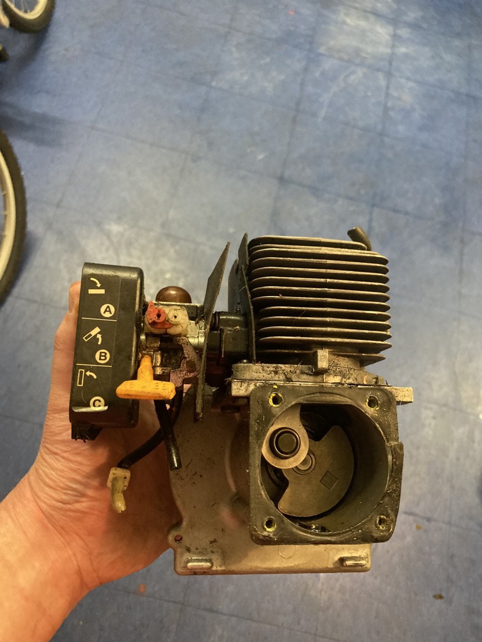

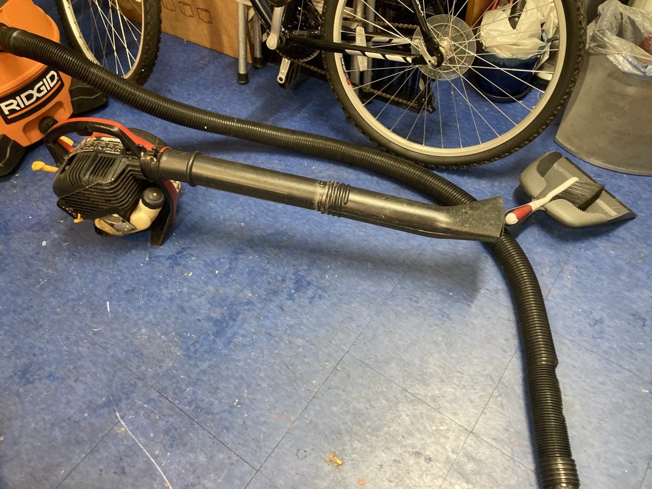

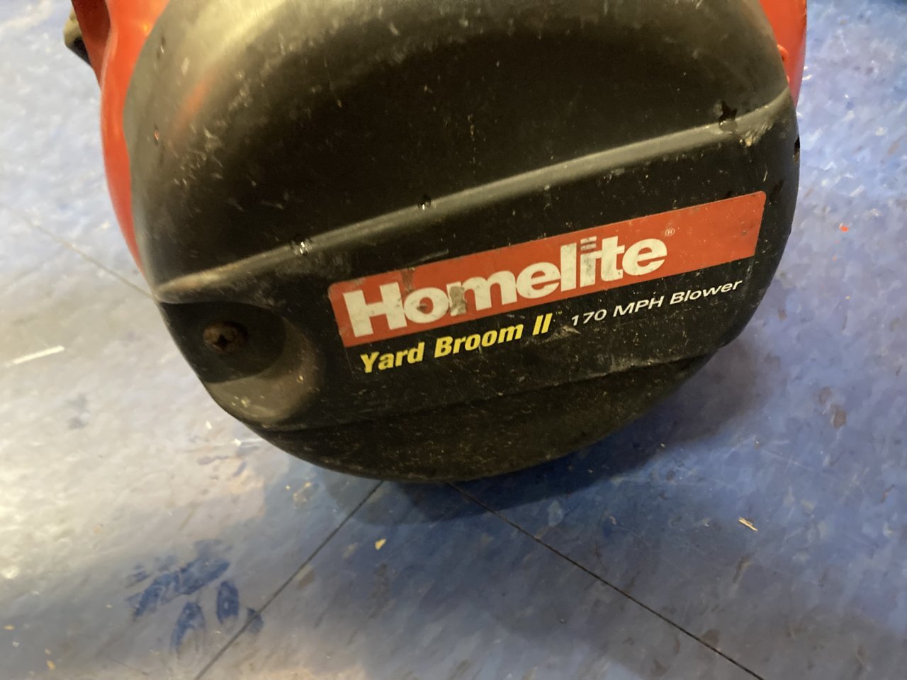

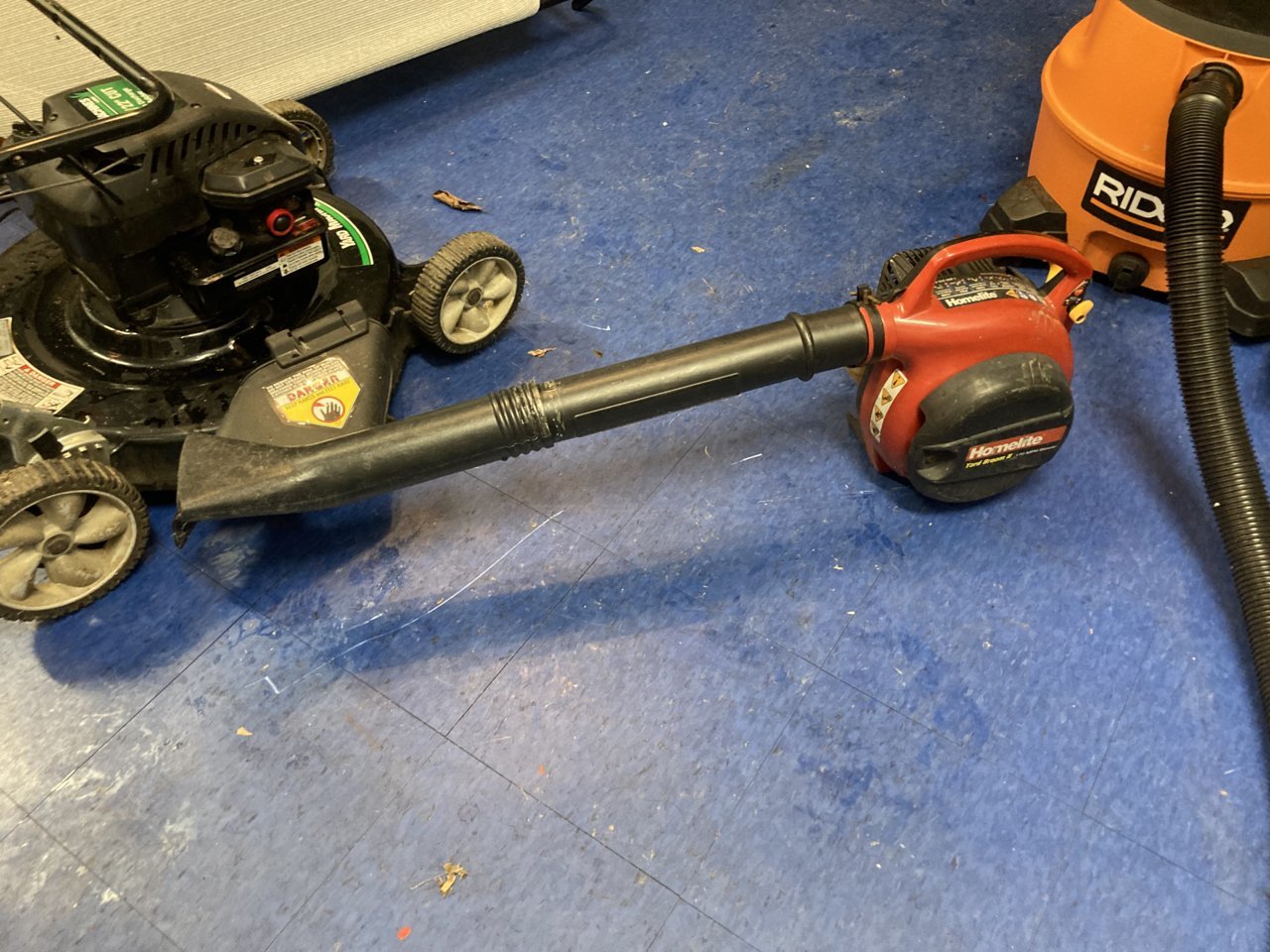

    The story behind the leaf blower is that like the lawnmower it was acquired for free, but that Gwyn's son also couldn't get it started and came to the conclusion that the engine was seized...

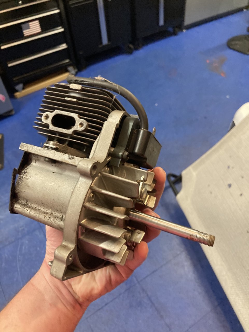

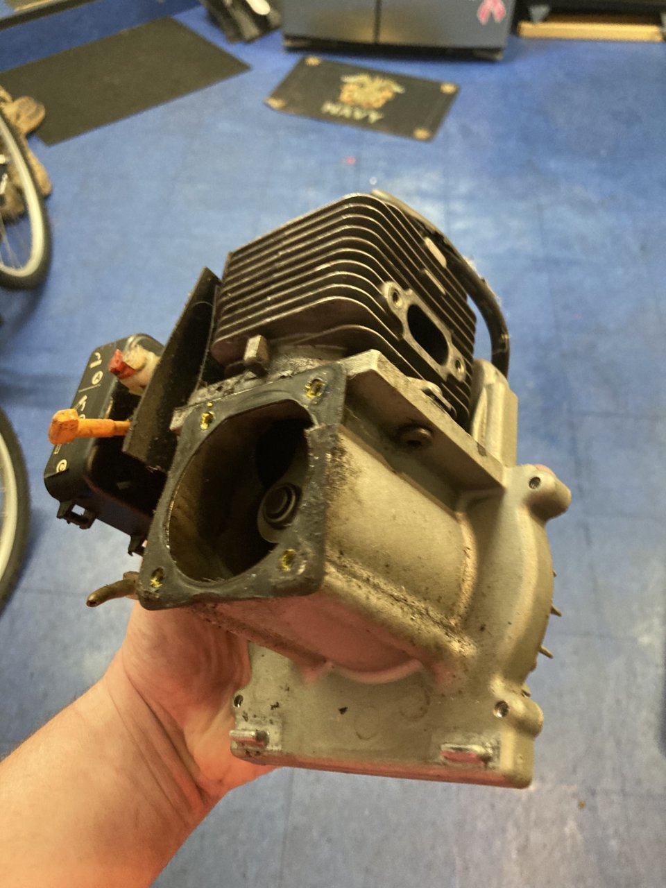

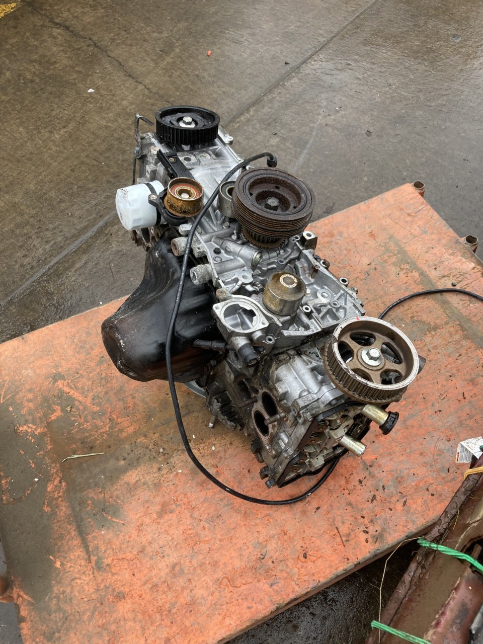

    I had to destroy this thing to get the engine out, because I was low on patience, and the engine was all I was really interested in...

    Hard to believe this tiny 2-stroke engine can blow 170 mph; Also, it wasn't seized...

    Based on the appearance of the blower overall, I got the impression that it hadn't been very well taken care of by whoever Gwyn's son got it from, but the blower mechanism turned freely and the piston went up and down. It didn't always turn over smoothly, but it certainly wasn't seized...

    The engine actually seemed to be in pretty good shape, but it wouldn't start for whatever reason, and this day and age it would likely be cheaper to just buy a new leaf blower...

    This was my first time dissecting a 2-stroke engine (much less an entire leaf blower), and I was amazed by how simple the whole thing was; Also, again, the engine was in much better condition than I expected it to be...
