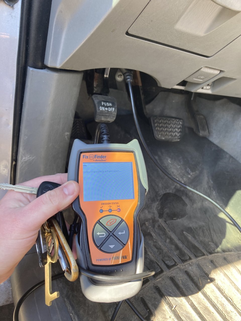

    The CEL came on after my friend helped me change the spark plugs last October, and the traction control didn't get disabled...?
    My mechanic simply plugged in his code reader and got the light to go out in a matter of seconds.

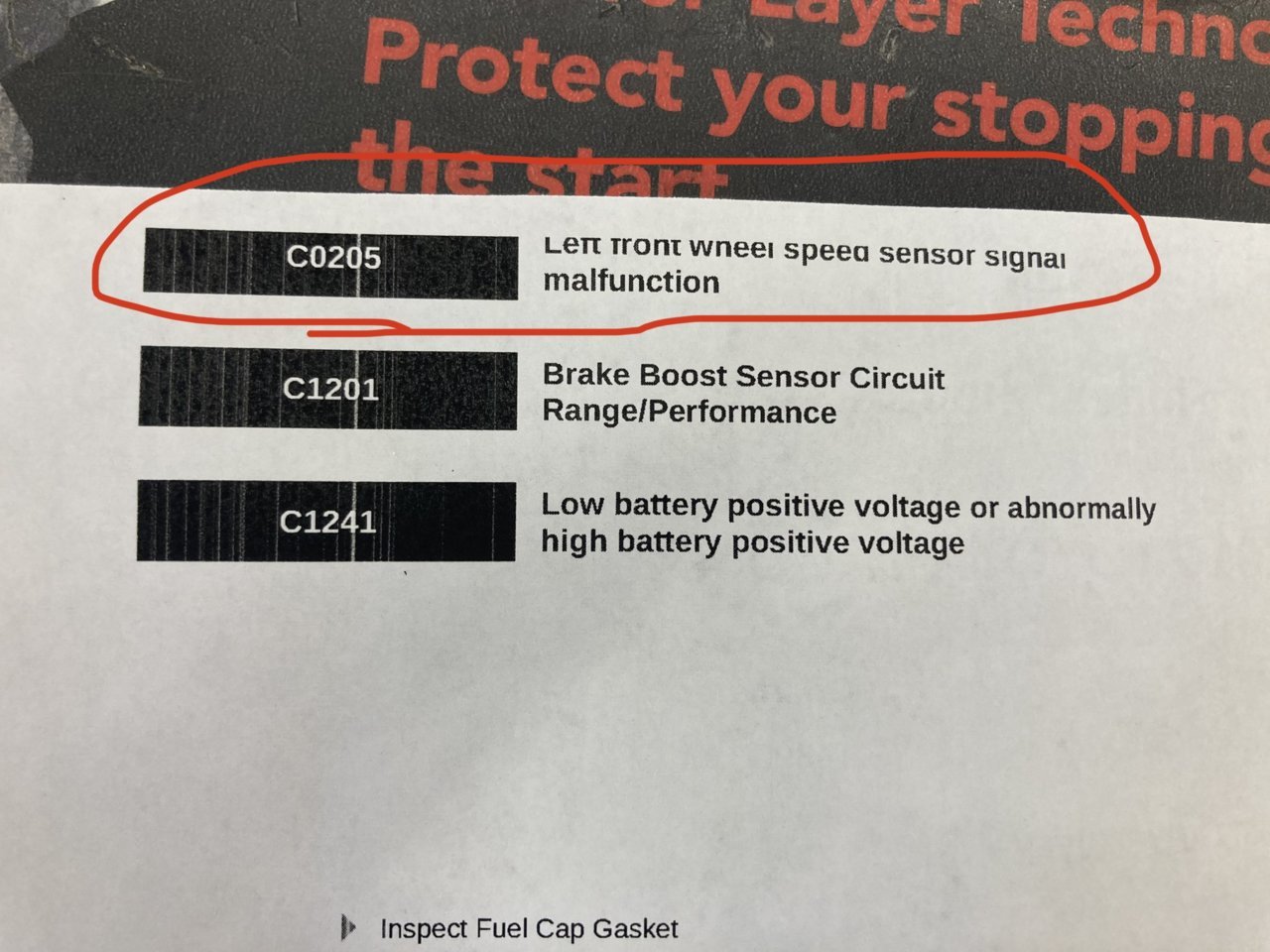

    Stopped by AutoZone...
    926C3B5F-FEF1-4147-A911-004B992A7268.jpg E503717E-2646-4546-8F15-3C76F369E640.jpg

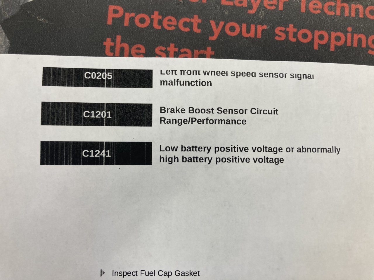

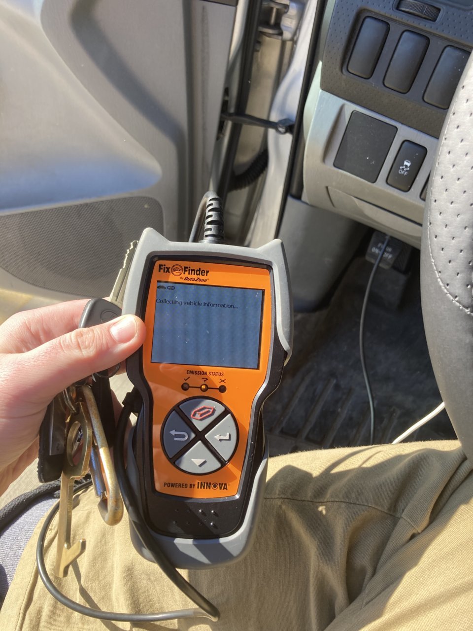

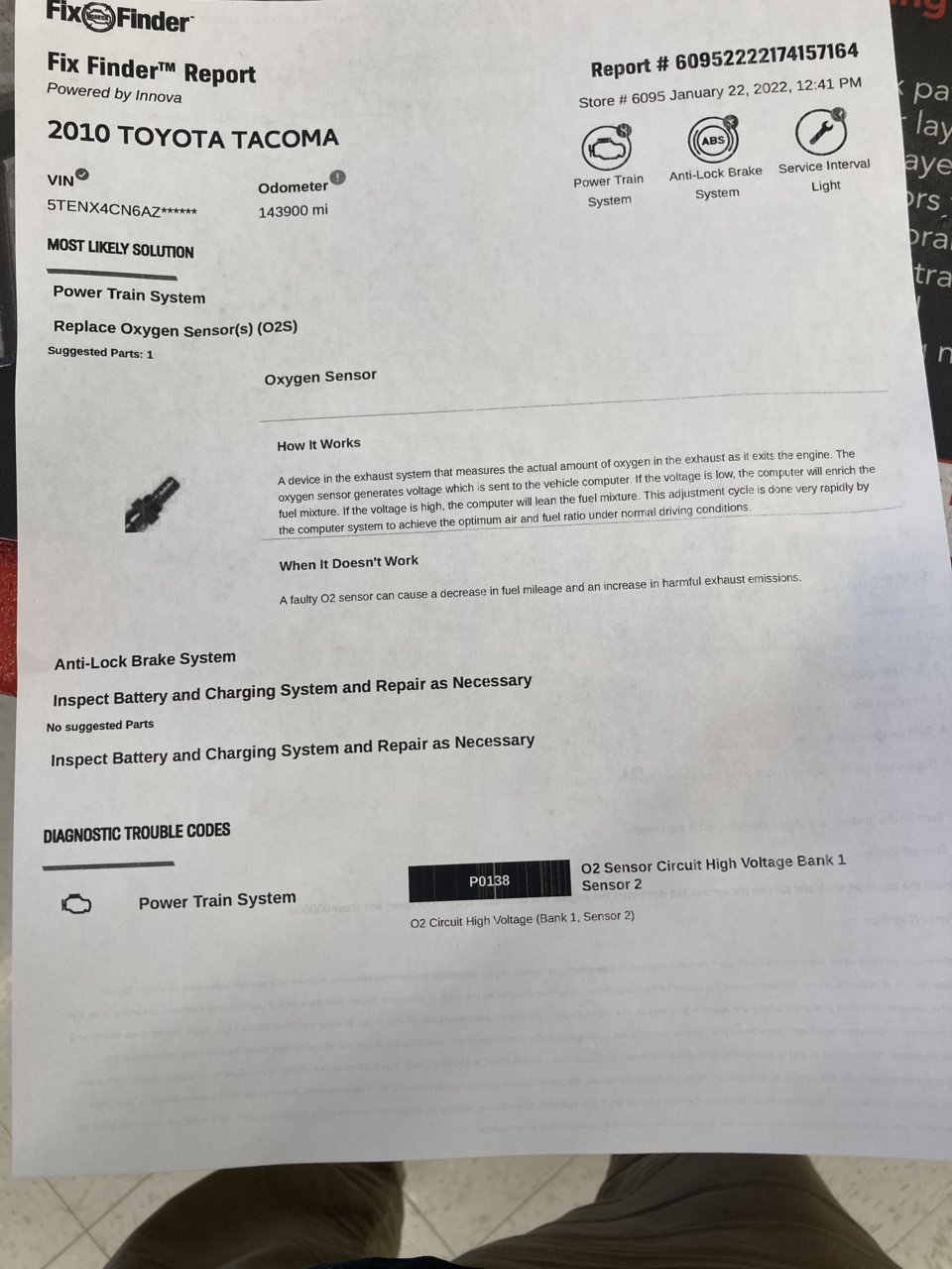

    Was good; 8 miles until 144K and not only do I believe that my oxygen sensor has failed, but it would appear that one of the wheel speed sensors has given up the ghost and that's messing with the traction control...
    :annoyed:
    8561BEEA-E331-41F1-921D-42AA7534C8D7.jpg 4E4D2D83-B275-4000-BDF6-157314BB1E33.jpg 8872B4BC-BC6F-4E6F-887C-FFD6EDADEAD1.jpg

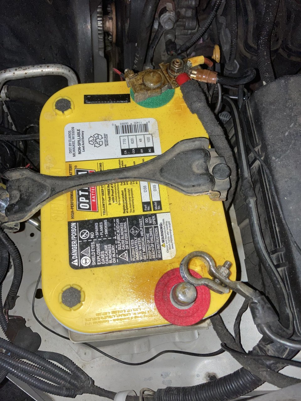

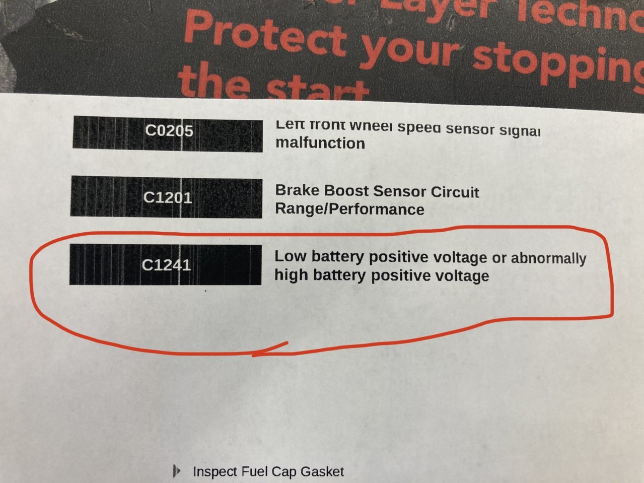

    Wonder if the Codes could be related to the Frame Swap or different Alternator? If you have access to alternate transportation then l would just park your truck until you can get it checked.

    Battery is literally brand new...

    Gotta drive it to my friend's house to put the new sensor in, but probably gonna skip DoorDash tonight...

    We've nailed down the issue; Just trying to figure out which sensor it is...

    On another note, my new Optima does have higher cold-cranking amps than factory specs...

    Downstream of the Cat.

    Could driving through a puddle have messed those up?

    Probably not Charlie. You have 140k+ miles on your truck. These sensors will start causing CEL’s as they get to end of service life.

    What about the battery voltage (quoted above), and the wheel speed sensor (below)?
    wilcam47 likes this.
  19. Jan 22, 2022 at 2:56 PM
    ColoradoTJ
    ColoradoTJ Retired cat herder Moderator
    Sep 3, 2018
    #265097
    10,232
    Colorado
    3500 Duramax, Roush Mustang, Jeep Crawler
    Companion codes.

    So once my buddy replaces the oxygen sensors tomorrow, those should go away? And the wheel speed sensor might actually be fine?!?!
