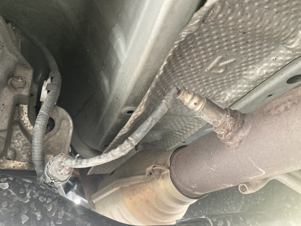

    Aside from the transmission linkage issue the night I got the truck back and the rear brakes being overtightened, I actually have not noticed an issues. The truck seems totally solid in terms of bolts being tightened. I honestly think that the alternator was just a very inconvenient coincidence, but I have a feeling that the O2 sensors were likely touched when the exhaust system was transferred to the new frame and that might have caused them to fail.

    I would definitely agree there, but @Plain Jane Taco makes a very good point, and if something else suddenly fails then it might be more than just a coincidence; Basically everything under the truck except the exhaust system and upper control arms is brand new at this point, so I don't see of that failing. The front brakes are less than a year old, the rear brakes are like two years old and have about 40K miles on them, the suspension is all brand spanking new, and the tires (including the spare) aren't even a year old!

    Unless you had a new exhaust system installed when they did the frame, there's about zero chance that somebody touched the critical part of your O2 sensors when they swapped it over. That's because they unbolt the whole system and swap it over.

    The exterior portion of the sensor can look pretty bad and still function perfectly normally. The critical part is inside the exhaust pipe.

    Sounds like it's just age and mileage then...

    This, and what he said prior post. My old car in college that needed one looked fine until I removed it and the inside was junk
