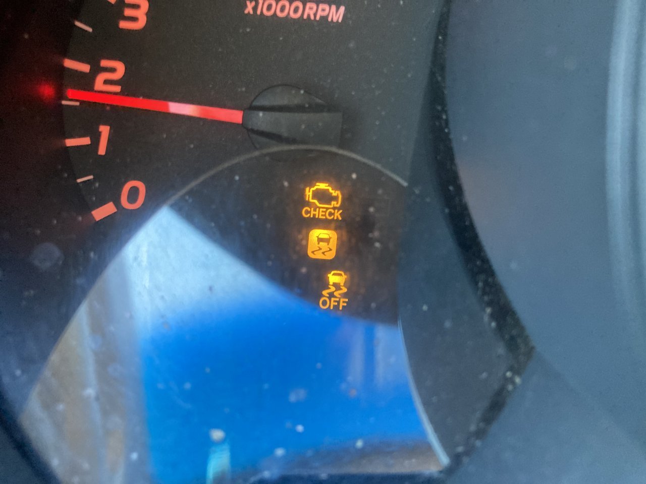

    Right now, it appears to just be a companion code; If replacing the O2 sensors doesn't shut off the TC light, then I'll address that.

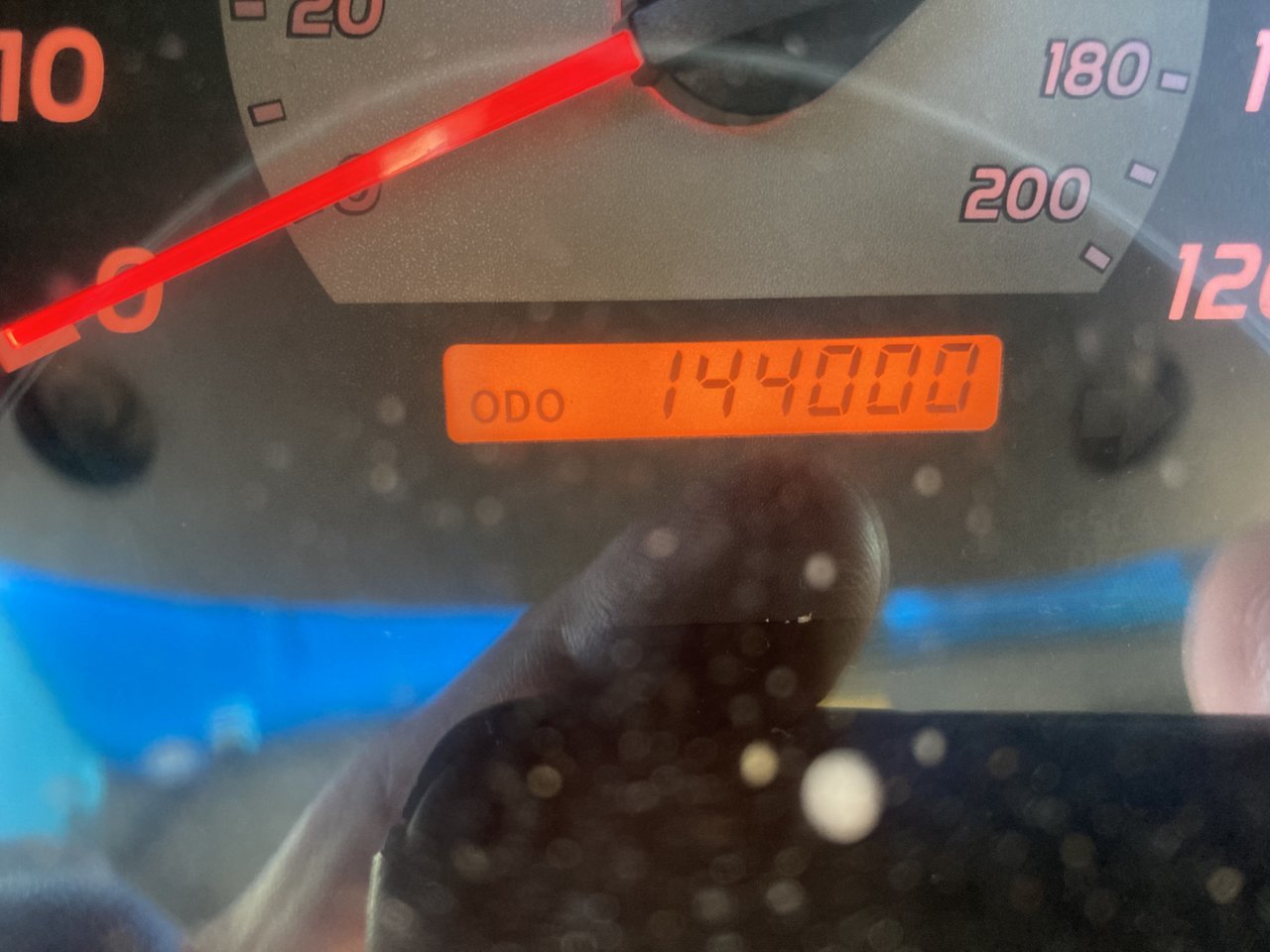

    I hit 144K on my way to Pete's...

    @ColoradoTJ and my mechanic both said that the other codes were companion codes that were automatically triggered, and when my mechanic used his own OBS scanner after replacing both O2 sensors, the other codes were gone as well; I'm still a wee bit confused as to what was going on...
    shakerhood[QUOTED] likes this.
  11. Jan 24, 2022 at 4:28 PM
    ColoradoTJ
    ColoradoTJ Retired cat herder Moderator
    Sep 3, 2018
    #265097
    10,232
    Colorado
    3500 Duramax, Roush Mustang, Jeep Crawler
    Once a CEL is generated, it removes traction control from service since it most likely shares the same module.
    The companion codes keep this in the same status until the original issue is fixed/condition no longer exists.
