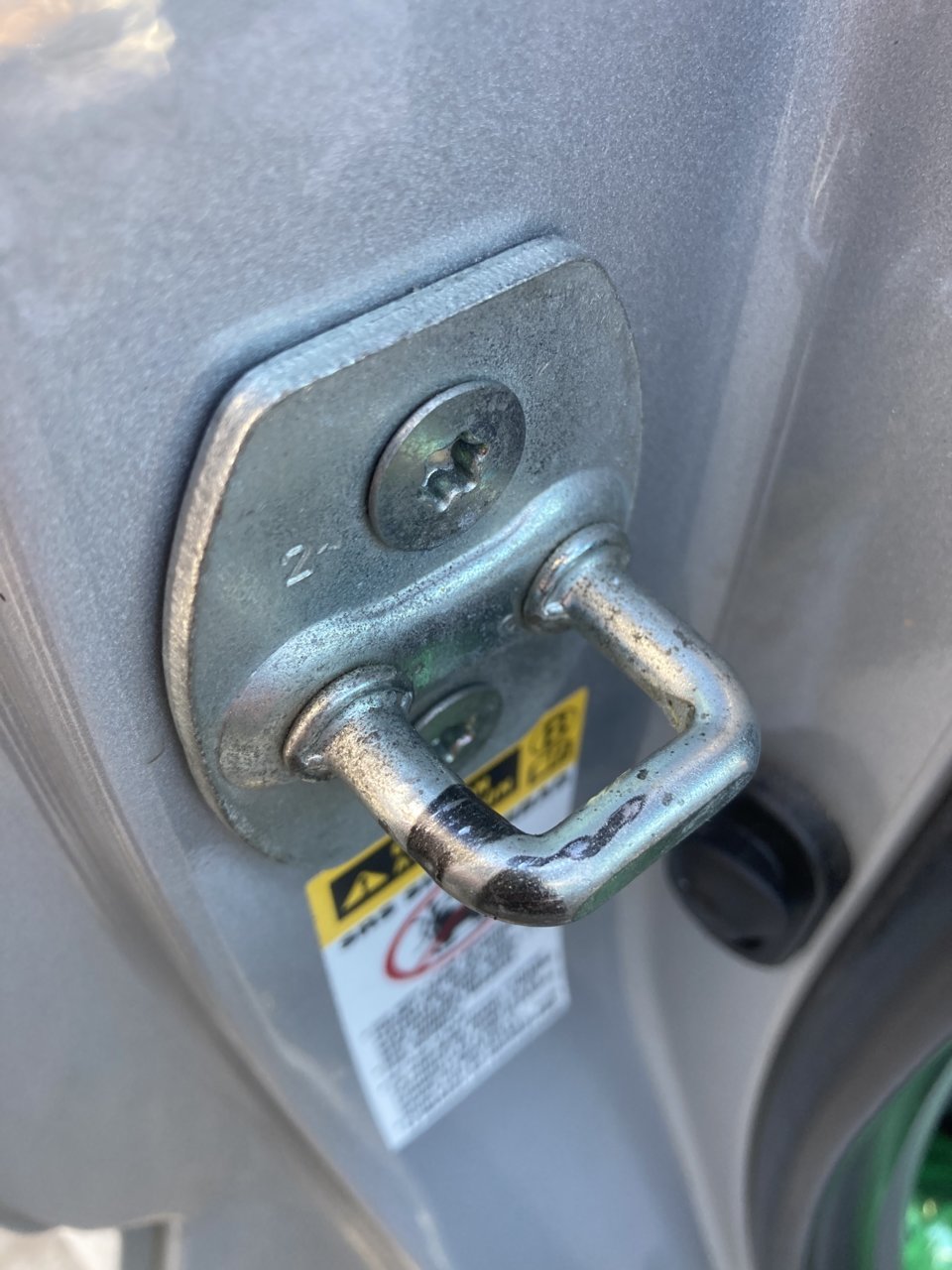

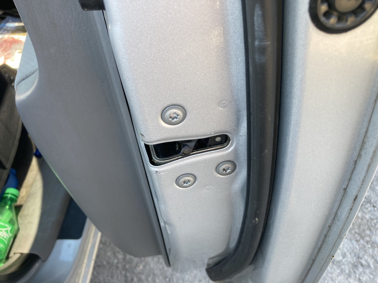

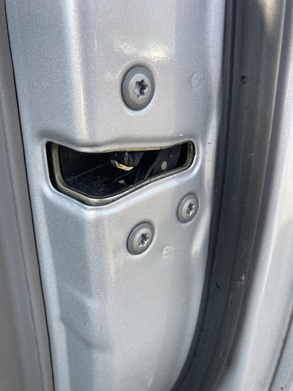

    The locking mechanism is fucked up; One of the guys working for my mechanic had to help me get it shut...
    This door will not be opened again until it's at the body shop getting fixed!

    The door doesn't always want to shut properly...

    The door is deformed, so yeah.

    I mean the locking mechanism is messed up; Also, the window obviously won't roll down all the way...

    The dent may be pressing on an actuating rod or cable inside the door. The deformation might have shifted the latch position relative to the striker just enough to cause sticking issues. When the body shop installs the new door, the tech will need to adjust the hinges and latches per FSM so everything engages nicely.
