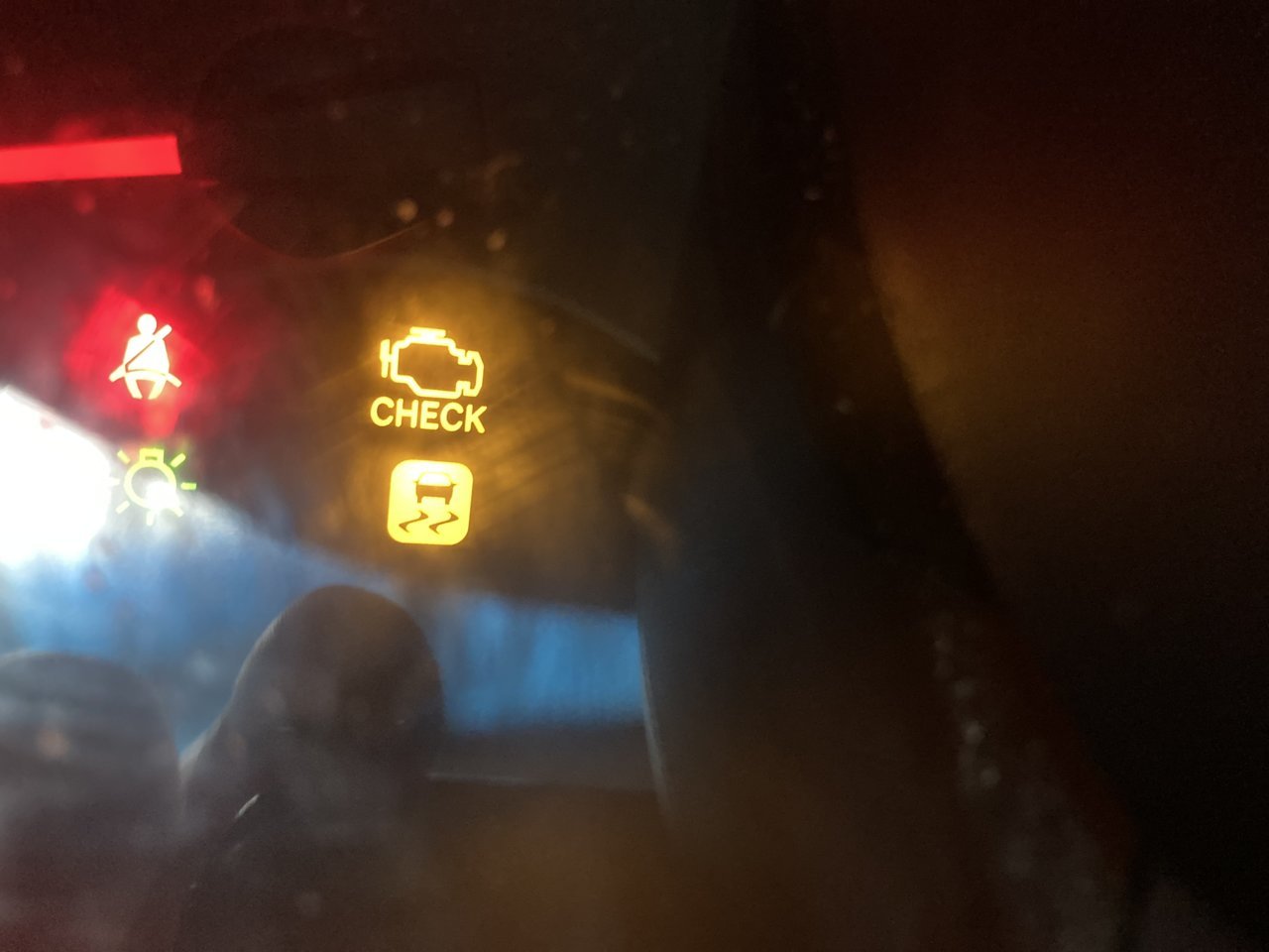

    The truck has been sitting since 9:30am and I started it just now to leave work, and it was sputtering; As I was typing this, the CEL came on again...

    scan it up. The best problem you can hope for is one you can diagnose. Intermittent problems are the worst

    So I took it to my mechanic; Just like weekend, it's a misfire in cylinder #1. Based on the symptoms I'm descriptions, he too thinks it's the injector.
