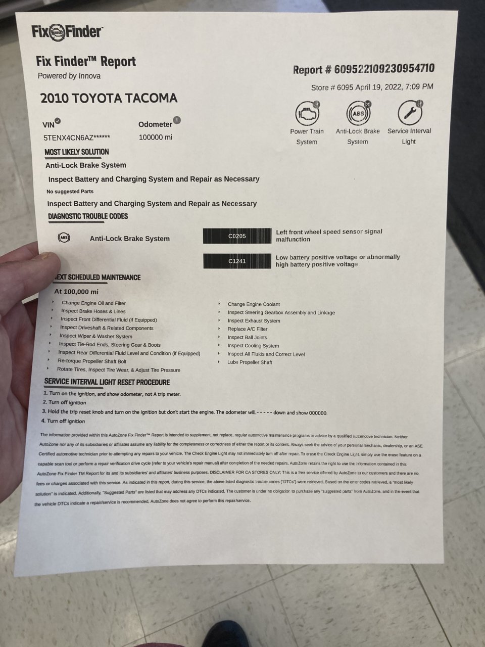

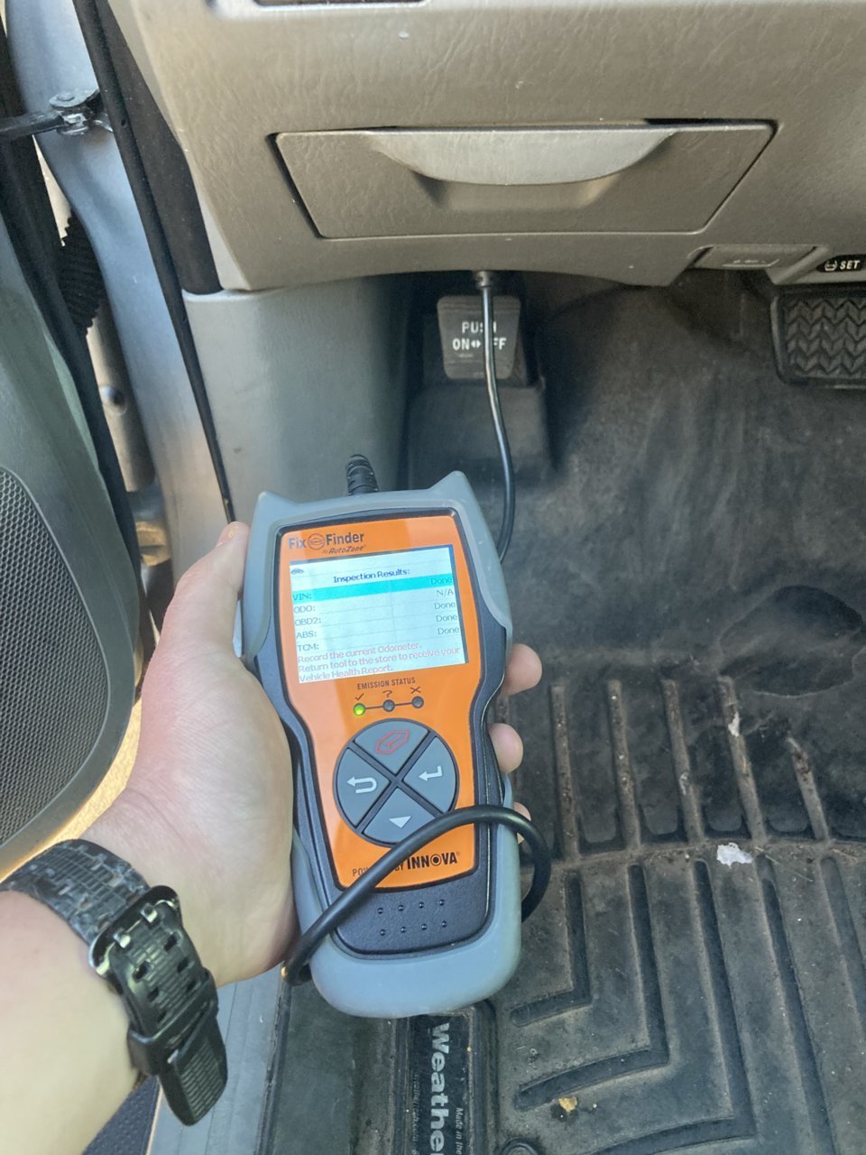

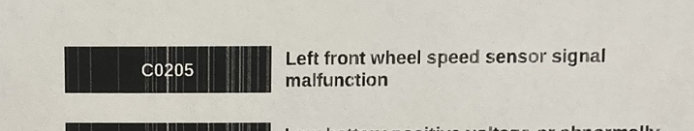

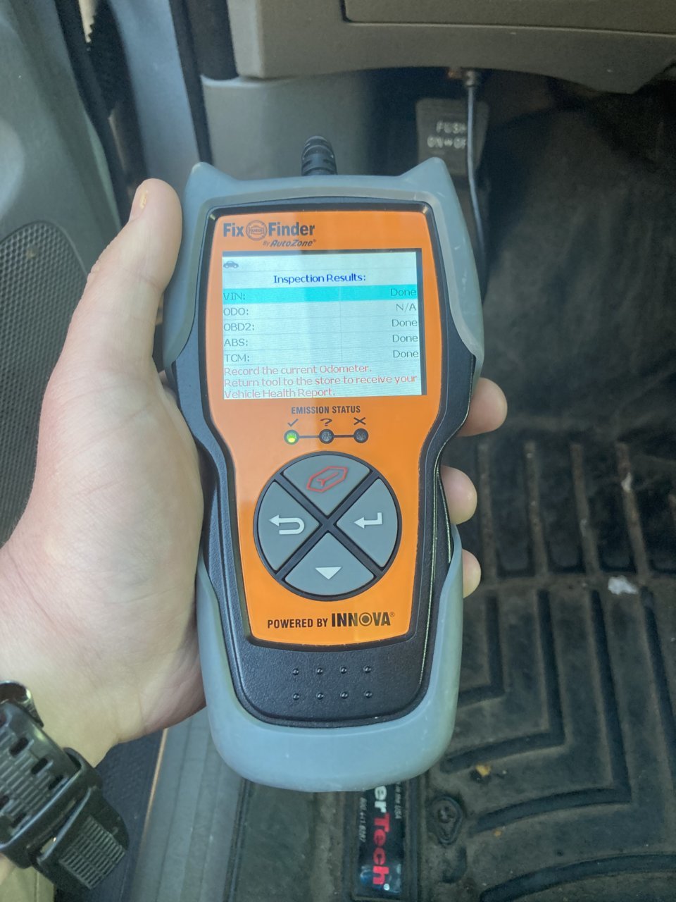

    Stopped by AutoZone to do a scan, and after chatting with a friend who's a Toyota tech, we figured out what is wrong with the cruise control...

    The wheel speed sensor has been on the fritz for months, and that's why the damn cruise control isn't working!

    Well, we figured out what's causing the cruise control to work intermittently; My truck has been throwing a code for the front left wheel speed sensor for months and I've been ignoring it. My mechanic is ordering the part today and will install it this Friday, so the cruise control issue should be dealt with.

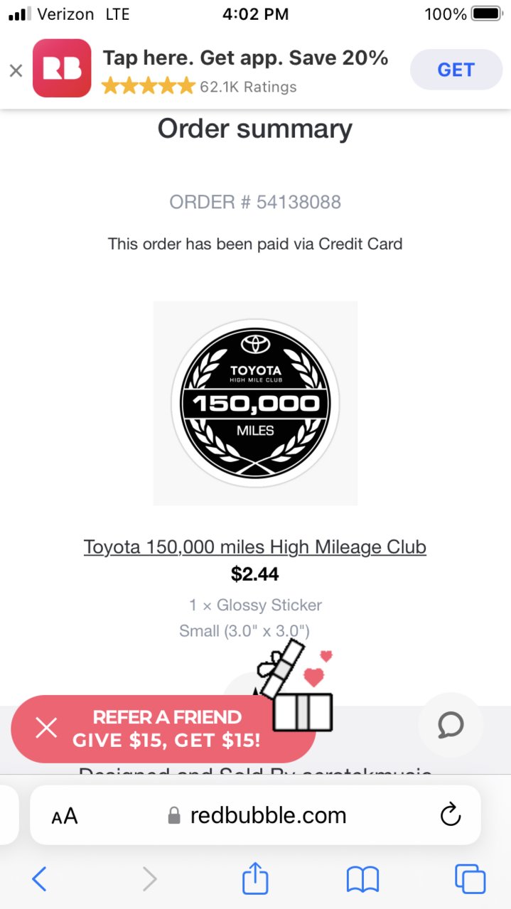

    The 150K mark is rapidly approaching, so I bought some commemorative stickers in preparation for this momentous occasion!

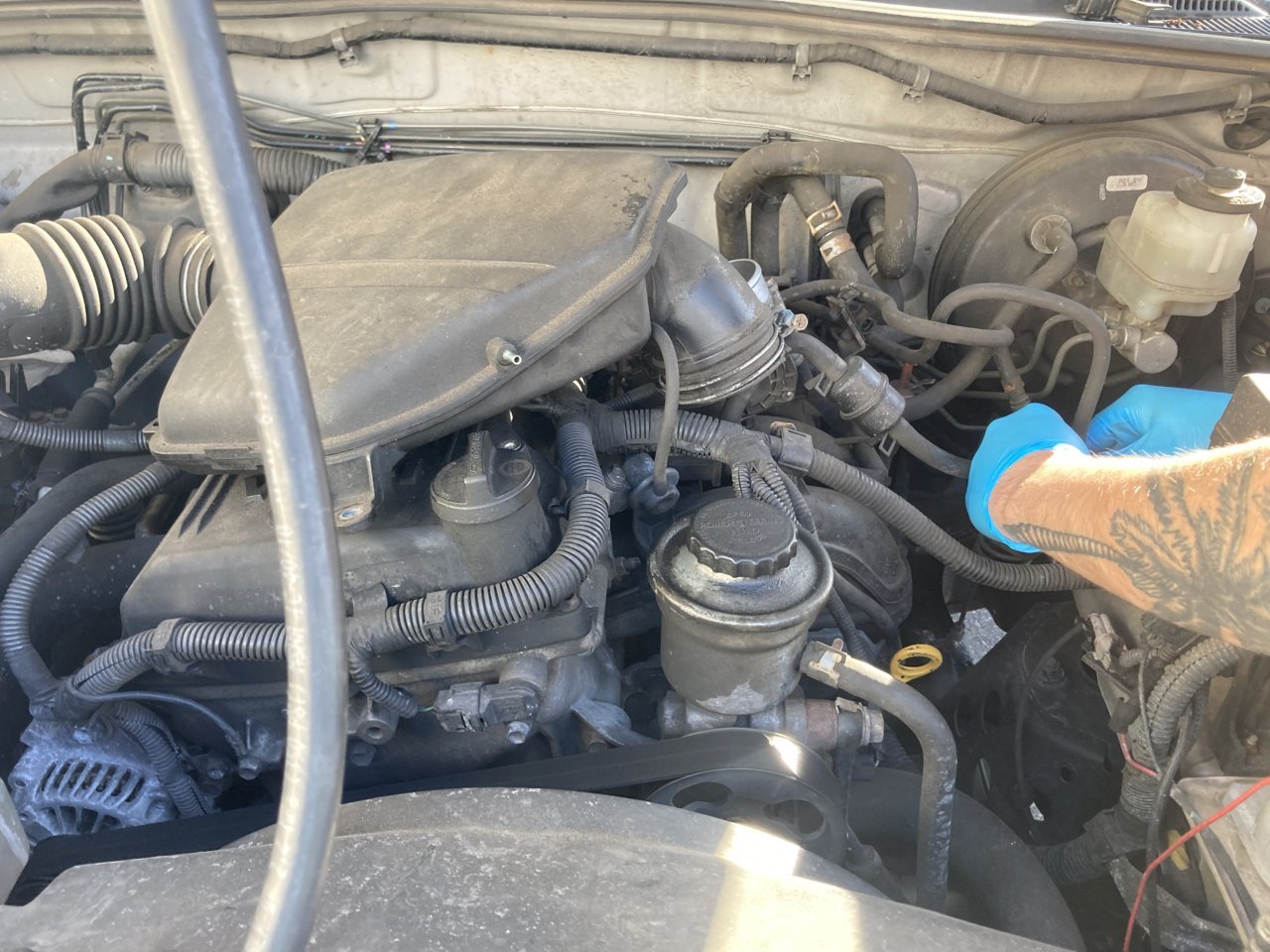

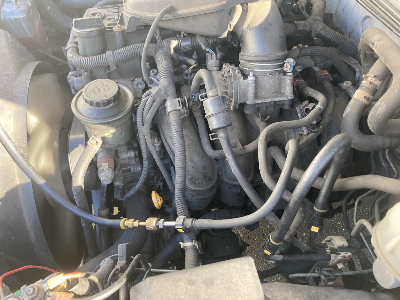

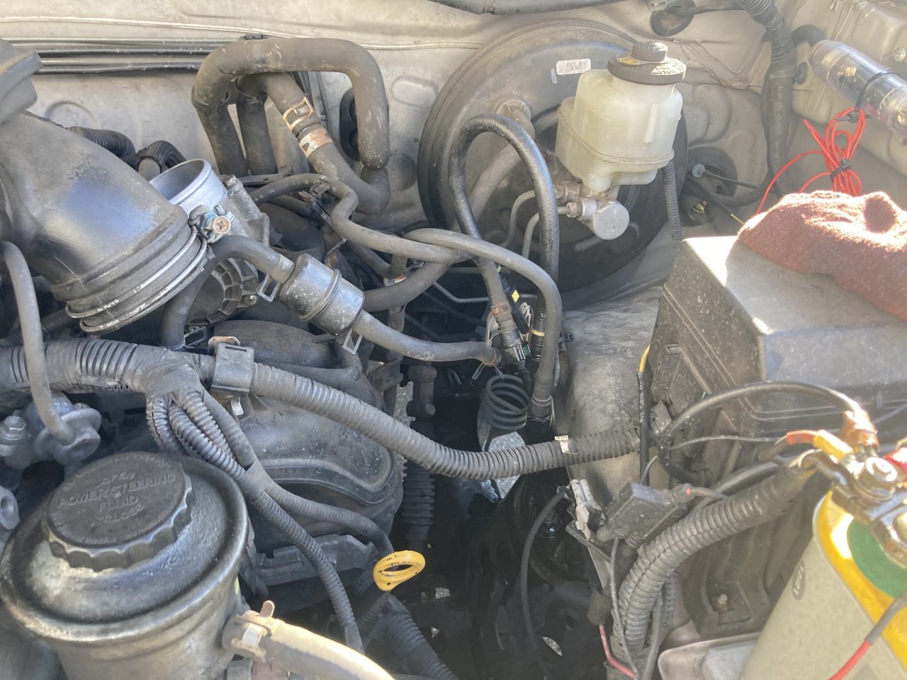

    Took it to my buddy who's a Toyota tech and he cleaned the throttle body and injectors; My truck runs a lot better now!

    Wasn't throwing any codes either, not even the wheel speed sensor...
