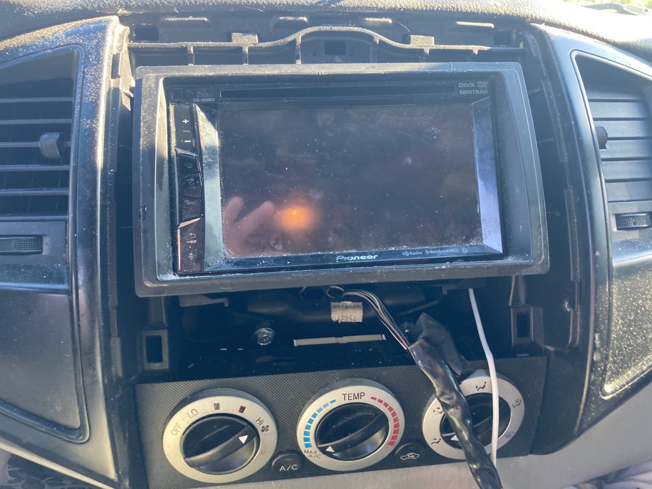

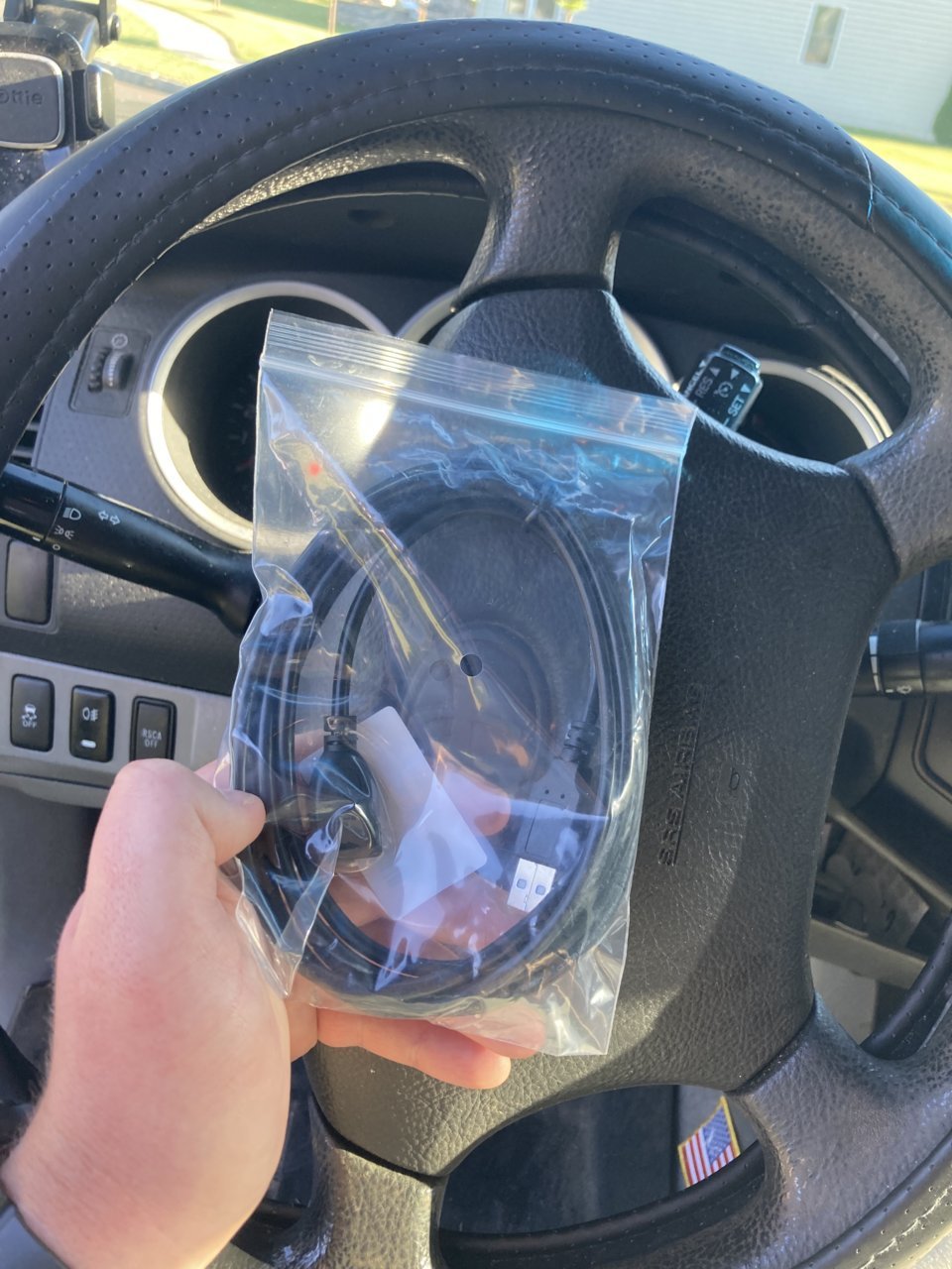

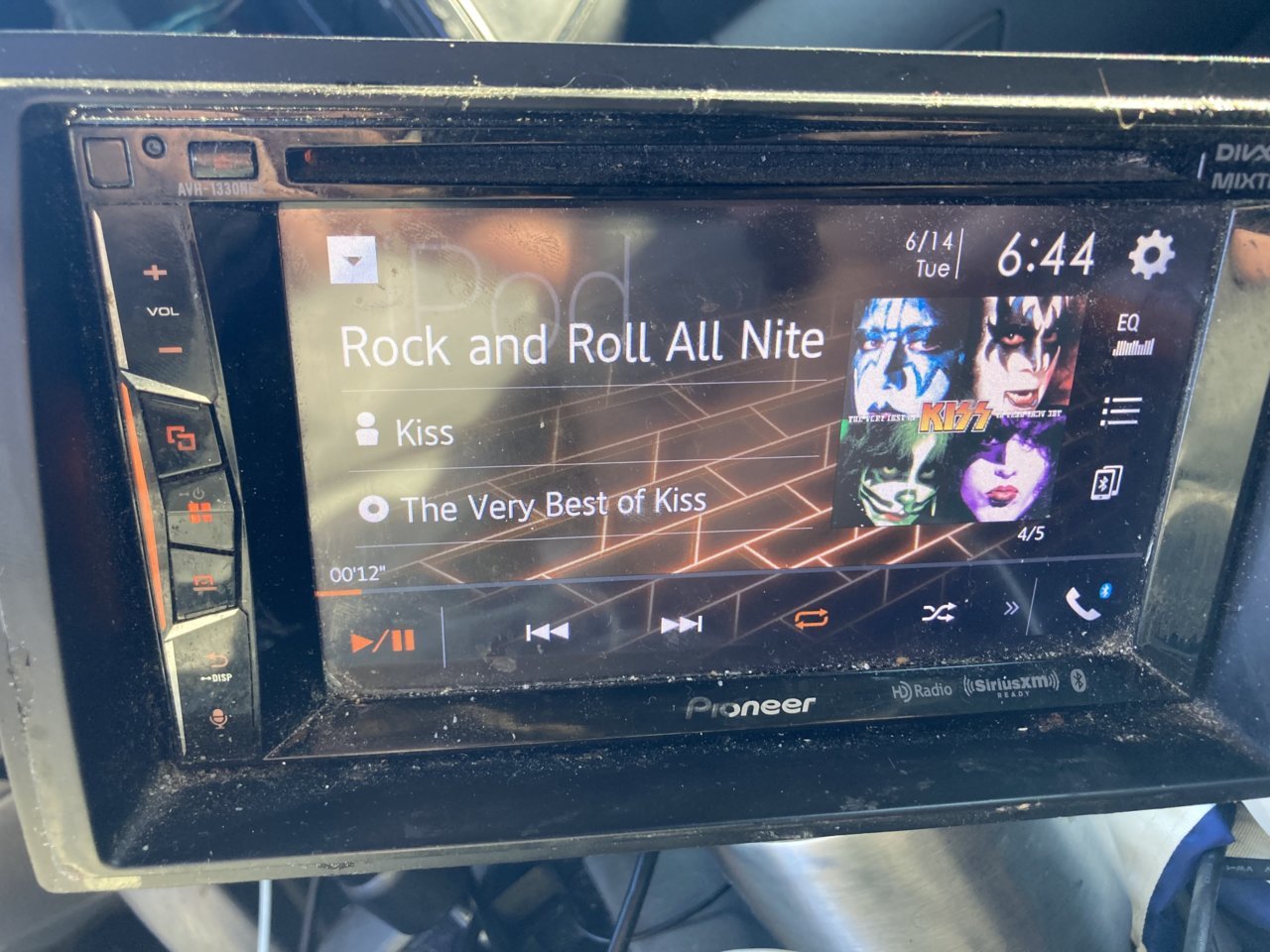

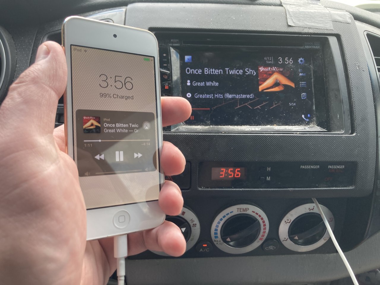

    This is what I was doing yesterday when I discovered the scorched connector; Installing a new USB extender...
