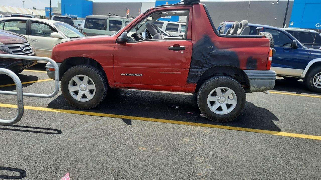

  17. Jun 16, 2022 at 1:08 PM
    PennSilverTaco
    PennSilverTaco [OP] Encyclopedia of useless information...
    Jul 15, 2014
    #134007
    72,797
    Charlie
    Central Bucks, Pennsylvania
    2010 Zombie Truck 2002 PT Cruiser
    That's actually pretty cool, though I can't tell if it's a cut-and-shut hackjob where two Trackers were combined, or if it's just really poor bodywork; I can definitely tell you that the wheels are from a Suzuki XL-7...
